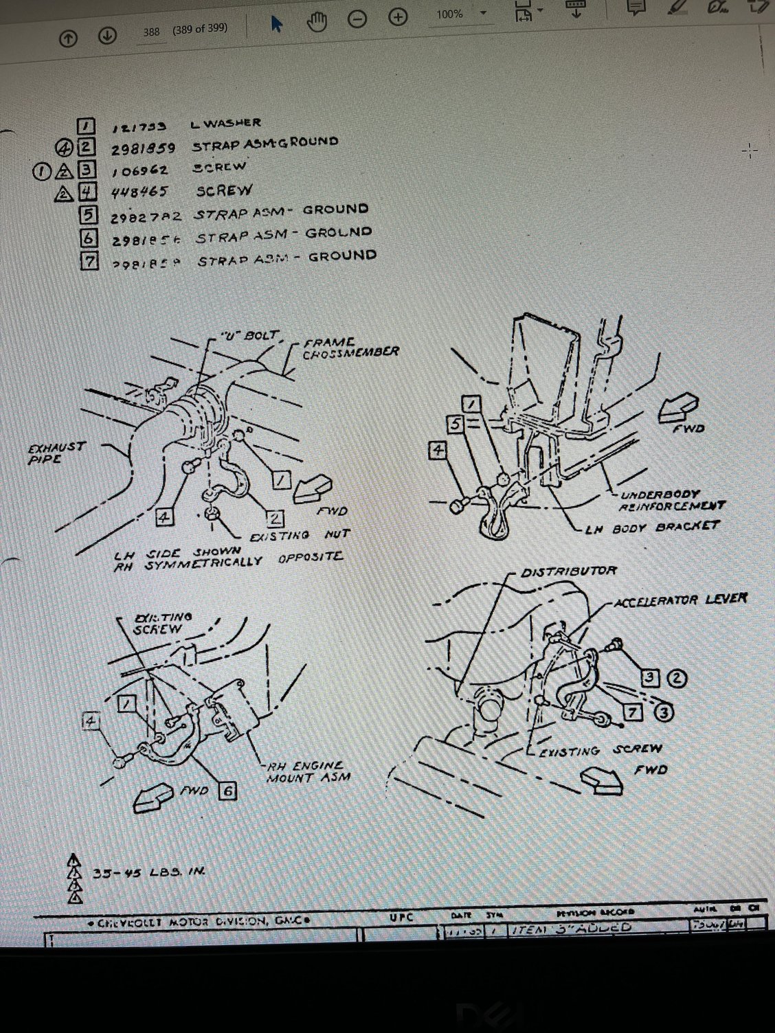

I have a 1966 Convertible 327/300 without side pipes. As I have gone through the car I have noticed several broken ground straps. According to Corvette Central, my car needs 6 ground straps. Does anyone know where they all go? Is there a page in the AIM that shows this and I'm missing it?
- One to the Antenna (that's the easy one)
- One to the engine shroud (I'm pretty sure)
- One/two to the exhaust hangar(s)?
- One/two to the bird cage by the rocker?
Thanks in advance for any description or pictures you might be able to send my way.

OK, this is super helpful. I have found it in my AIM. Thanks.
A couple of follow up questions:
Can you confirm that when the AIM says LH, that they mean Driver's Side?
Does someone have a picture of how strap #5 connects? This is the one that mounts at body mount #1.
Can you confirm that when the AIM says LH, that they mean Driver's Side? Yes
Yes, LH means Driver's side.
Picture courtesy of John Hinckley (RIP)

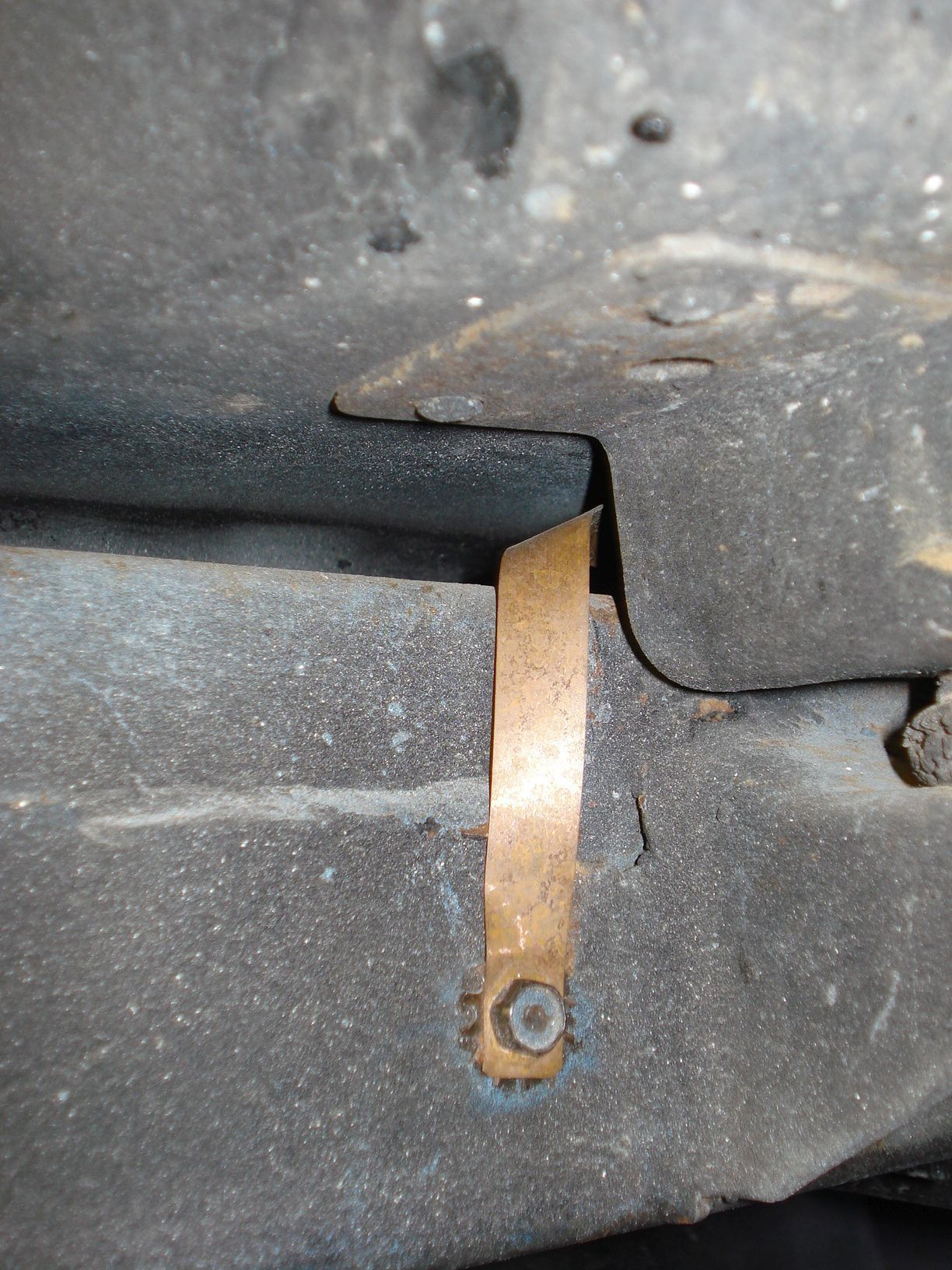

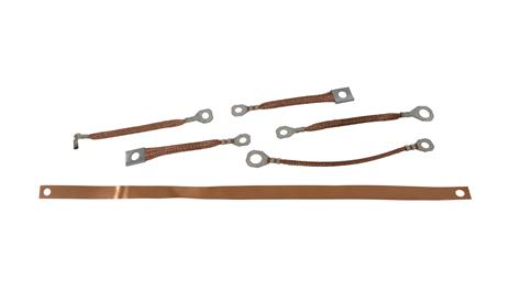

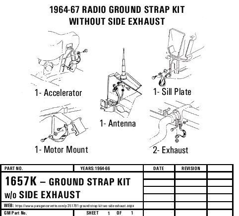

Here are some illustrations from Paragon and Lectric Limited. Also, attachment of the antenna ground (power antenna in this case) strap to the frame.
