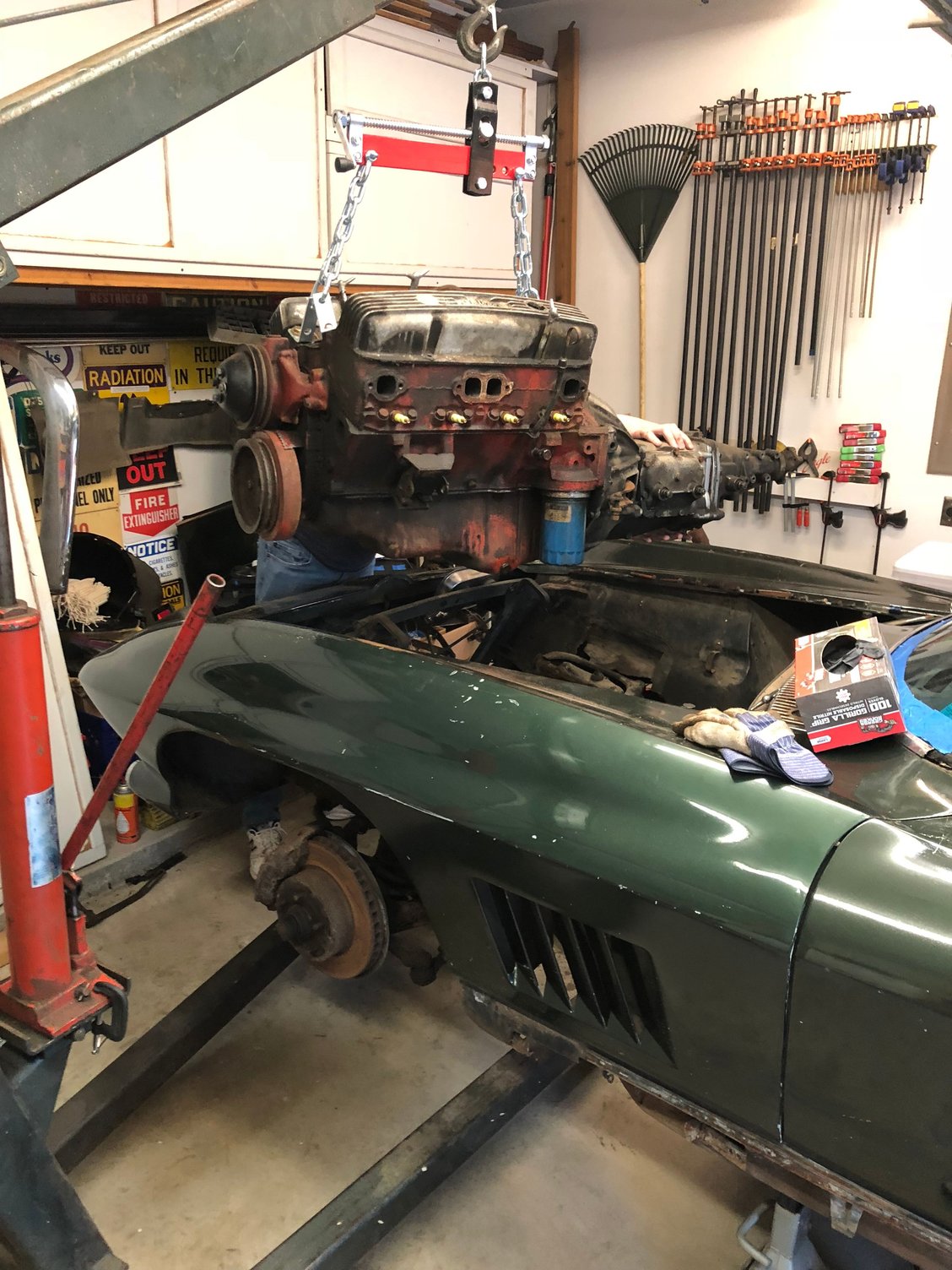

Since you are planning to swap out your transmission anyway, I would remove and install the engine and transmission all as one unit. There has been quite a bit of step by step procedures posted here on the Forum on removing and then installing an engine and transmission all as one unit.
You will need to remove the hood, the radiator and fan shroud, the fan, exhaust manifolds, distributor, carburetor and plug wires, clutch cross shaft, shifter linkage, accelerator rod linkage and driveshaft just to name a few of the many items. You do not need to remove the fuel pump, the steering box, steering linkage or the radiator core support. Take your time and use the interim period between removal and installation to clean and repaint your engine bay. C.J.

If you are working in a garage with an engine hoist make sure you have plenty of overhead room. When I pulled my engine and transmission I ran out of height due to the open garage door and had to drop the car nearly to the ground at the front to get it out. My garage was too short to close the door as I had no room for the lift up front. Also, hoisting from the front usually is the best approach when pulling the engine and transmission together, but some lifts are a little short of arm length for this and won’t clear the nose. Look for one with a little more capacity and reach if necessary. Good luck.

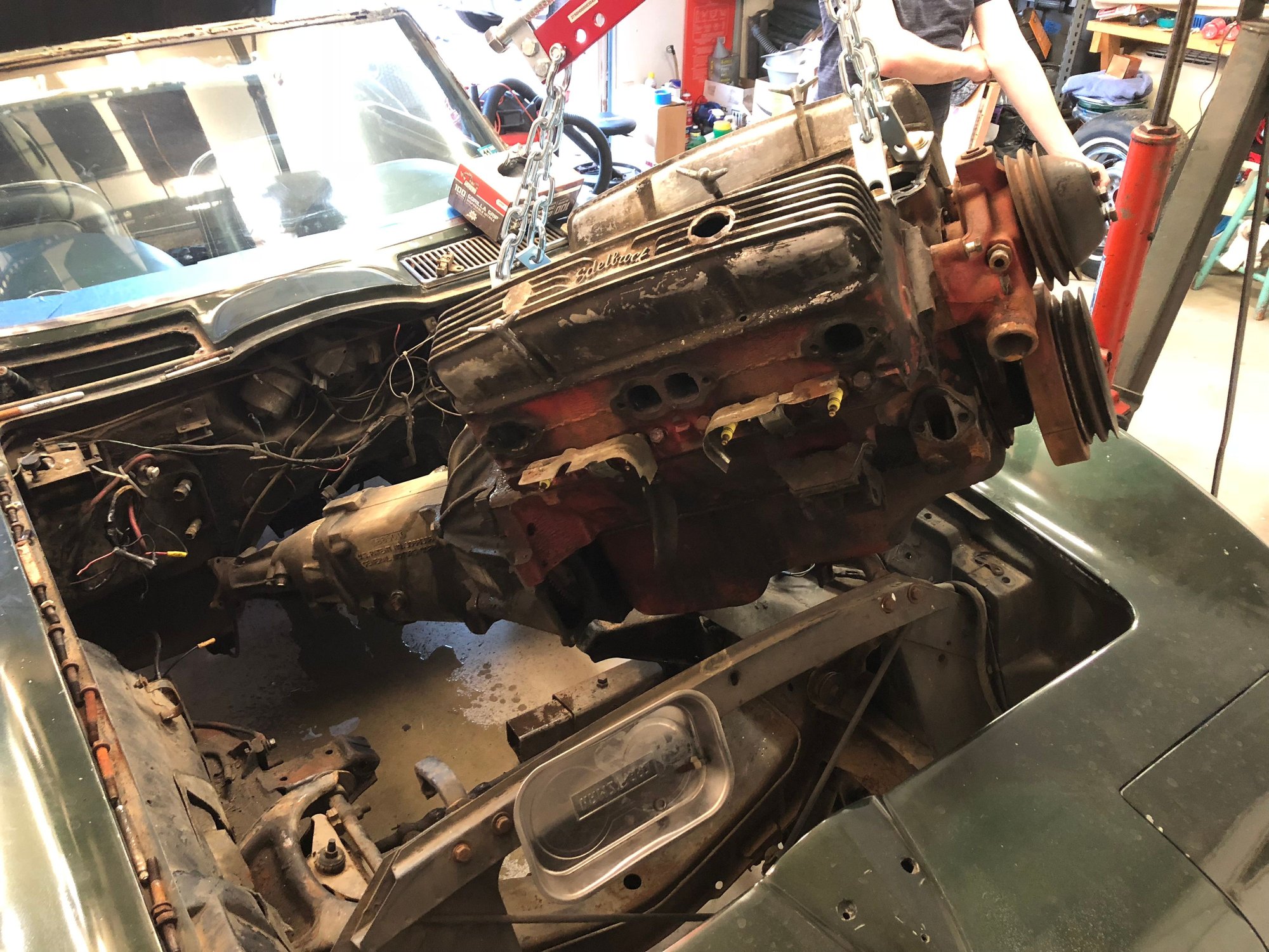

All good advice listed above..... only things to add/reinforce would be to use an 'engine leveler' similar to what is shown above by C2Scho and to make sure you have the pick point on your engine hoist out as far as it can go, with capacity, as DansYellow66 noted..... if not, you run the risk of having the post of the engine hoist running into the nose of the car......

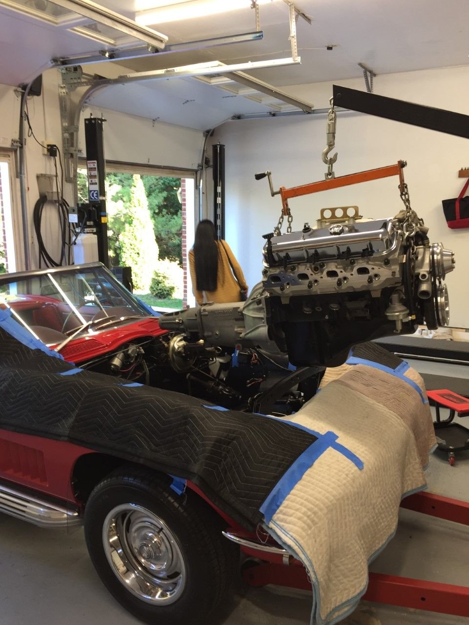

After engine rebuild the bell housing was installed and the Muncie trans was left in place the car. The hood, radiator, and fan shroud were removed.
The first attempt to drop the engine in the engine bay from the front of the car came up about 10 inches short of position on top of the motor mounts.
After removing the left front wheel and repositioning the lift, dropping the engine into the engine bay from the left side got it done.
The Muncie was positioned to point straight ahead so that the input shaft would enter the bell housing hole straight on without interference.

You will not be able to remove the engine and tranny together without a leveller and preferably one with a hex drive so you can use an impact wrench to turn it. I did it by myself which is doable, but a friend will speed up the process and give you some piece of mind. Another thing to consider is where to attach the leveller. A stock C2 V8 does not have accessory holes drilled and tapped into the heads. I used four intake manifold bolt holes with longer bolts and a big washer through a chain link. Lots to improvise on these cars when making changes!

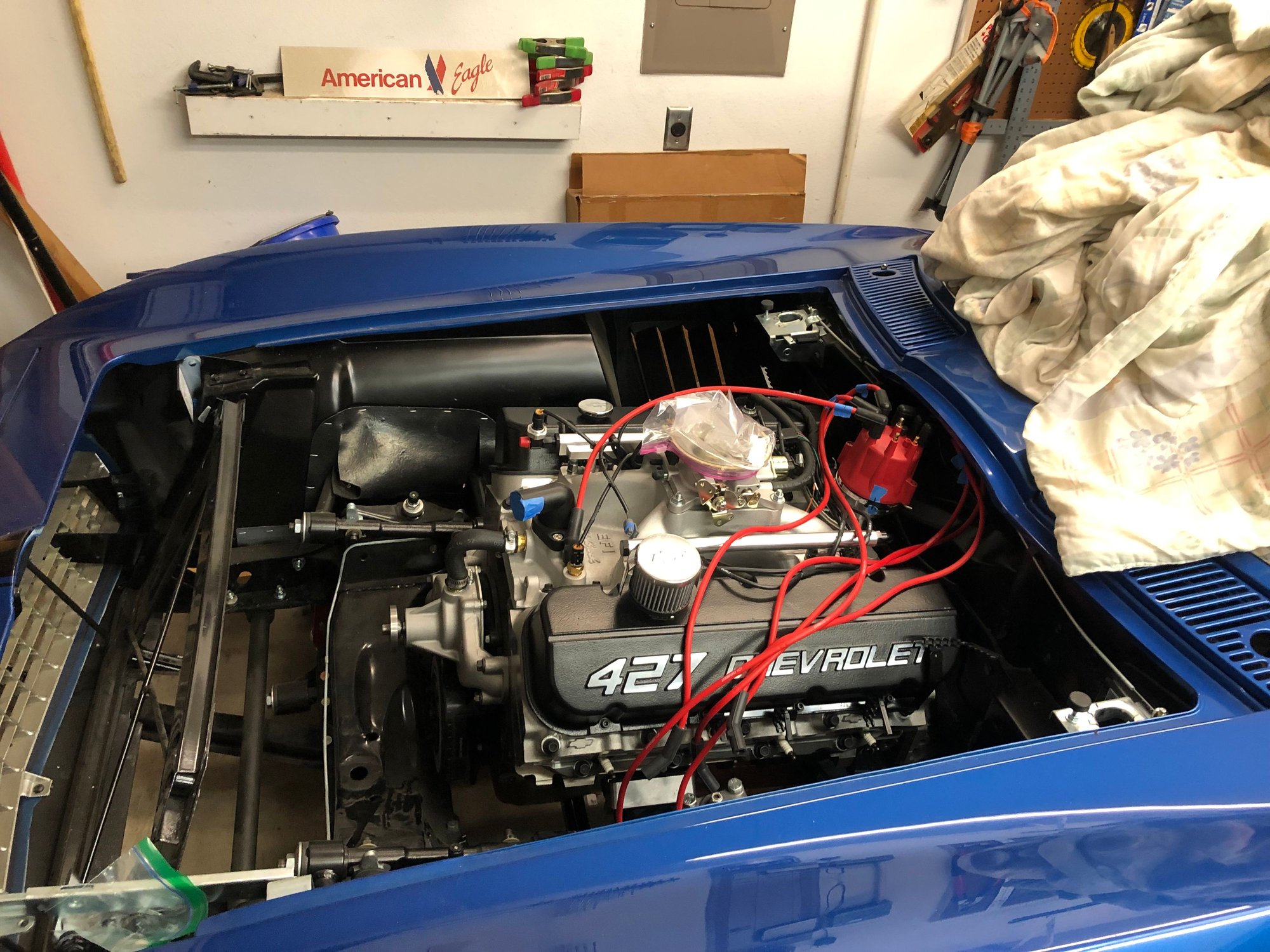

Last year I installed a Tremec TKX behind my big block in a 1966. Due to the Tremec being approximately 3.5 inches longer I needed to install as one unit. I tried several times with the motor in the car but due to very tight clearances could not get transmission in place.
One item/tool that helped me was using a 2 ton engine hoist. Due to space and the position of the hoist legs I could not install from the side of the car. The standard hoist was literally pushing again the nose of the car while we were tilting the motor using a leveler. The 2 ton hoist gained me some piece of mind as the hoist was further away from the car. I checked at least 5 tool rental companies and no one offered the 2 ton hoist so I ended up purchasing one.

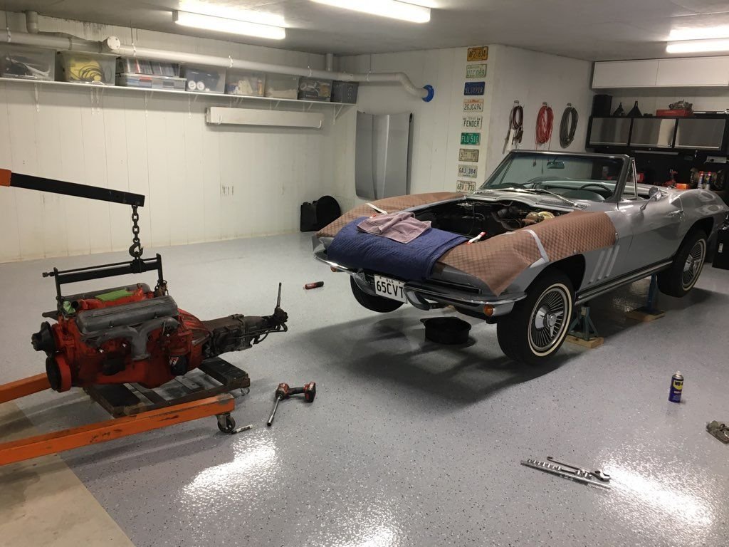

I went from the side on both removal and install. Had a cheap harbor freight leveler on removal. It scared me because the side braces on the pivot pin wanted to spread apart on removing the 327. Bought a better built one for install of the 427 and tremec. Also I made a C3 style removable crossmember when the body was off. I think it helped on the install of the longer transmission.

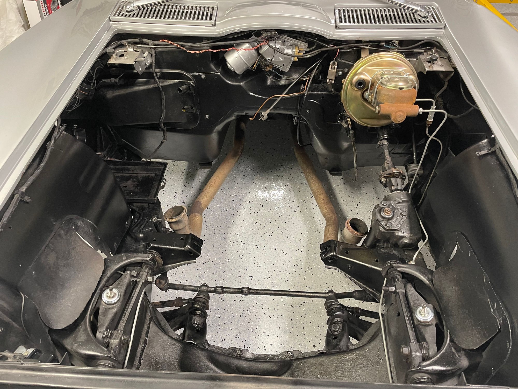

As above, if you have a leveller and get the car about a foot off the ground, you can pull the whole lot out (including the shifter) in one go.
Hood off, fan off, radiator and shroud out.
Exhaust left in, just tied to each side.
Disconnect the tail shaft and leave the yoke in the tranny, or you’ll have a real mess the clean up !
It’s a fairly easy process with the right tools and a friend to help and watch. Good luck.
