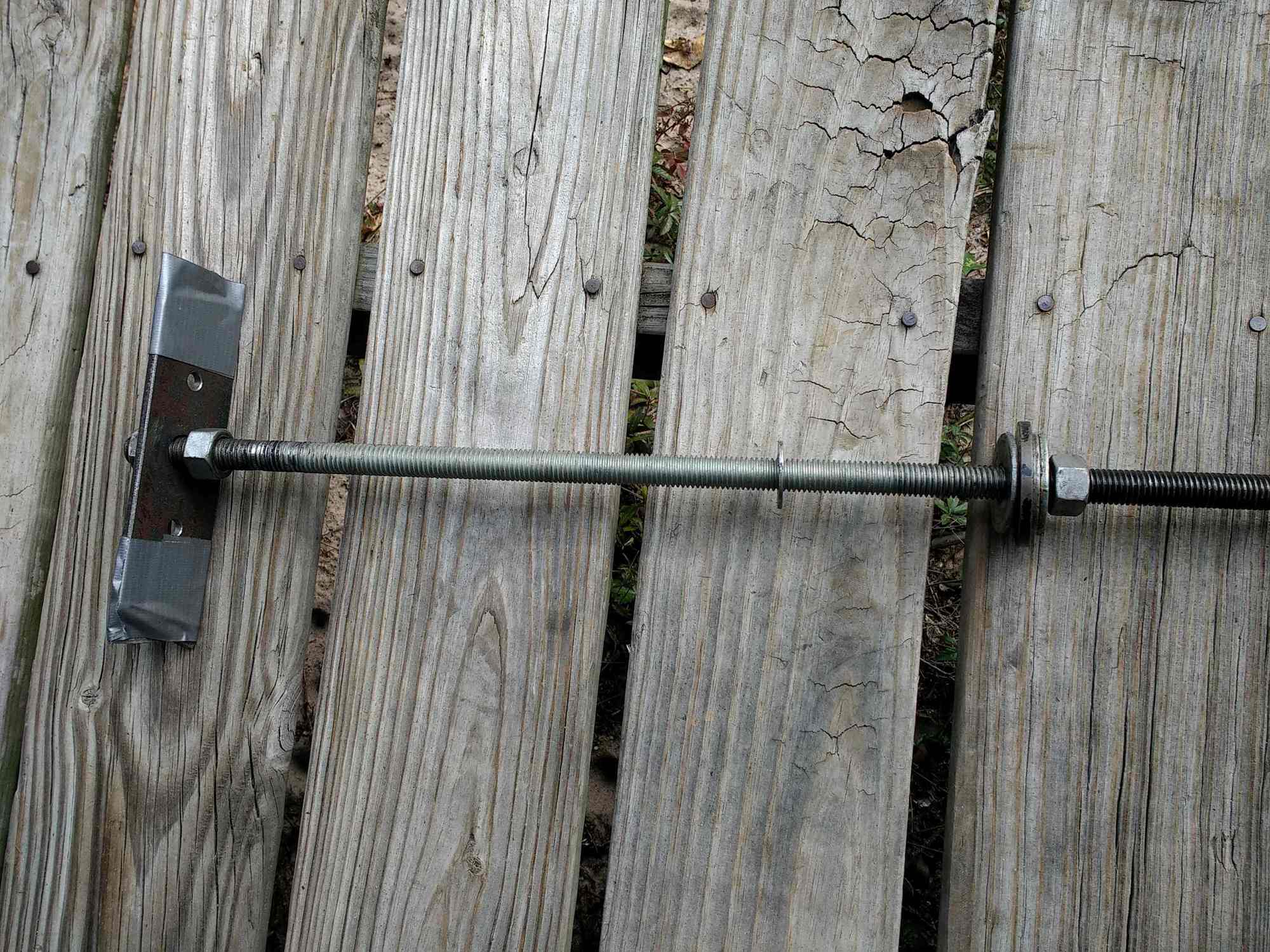

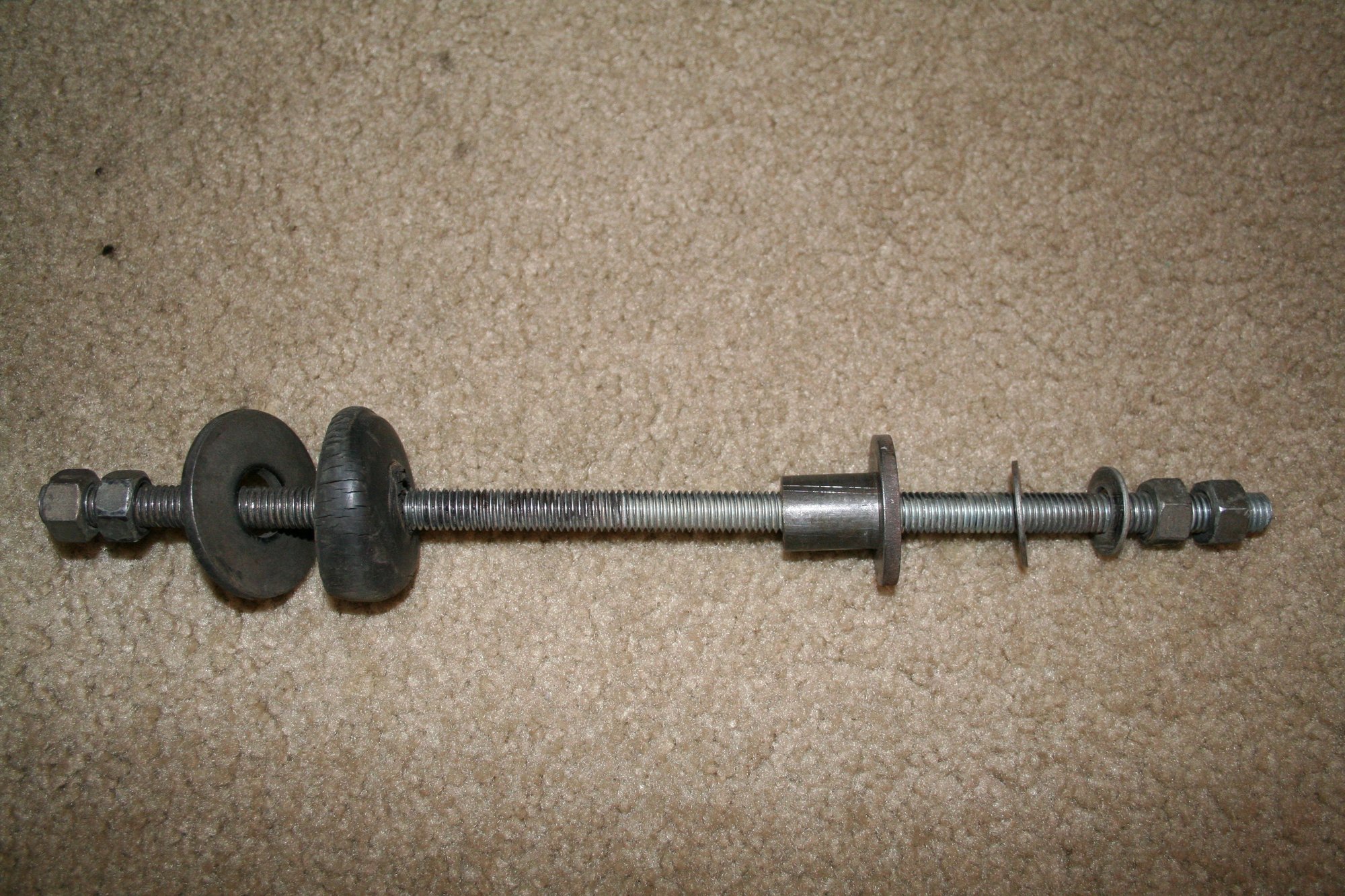

I made this to RR springs...put it on in through the shock tower...used parts from the rear diff snubber bushing....worked like a charm...put it in...tighten it up...remove ball joint...release pressure and the spring comes right out...reverse procedure...i made a deep socket...cut a socket in half...weld the socket to a 10" piece of thin wall pipe...

I've used one like Jack's since 47 years ago. The difference in mine is it is a longer rod, 1/2 inch threaded rod, and a 1/2 pipe flange for the A-arm hole. My first was 3/8 inch threaded rod, but I decided that it might be a bit too weak for safety. Also, the 1/2 inch nuts get a better grip on the rod. If you can find a barrel nut that size, all the better. I also have two nuts on each end, so that if the pressure nut strips, the second is there to catch it.
The big advantage to one like Jack's and mine is the spring cannot get loose and go flying. It is always captured. That said, I typically still loop a couple of 1 inch motorcycle straps around a coil.

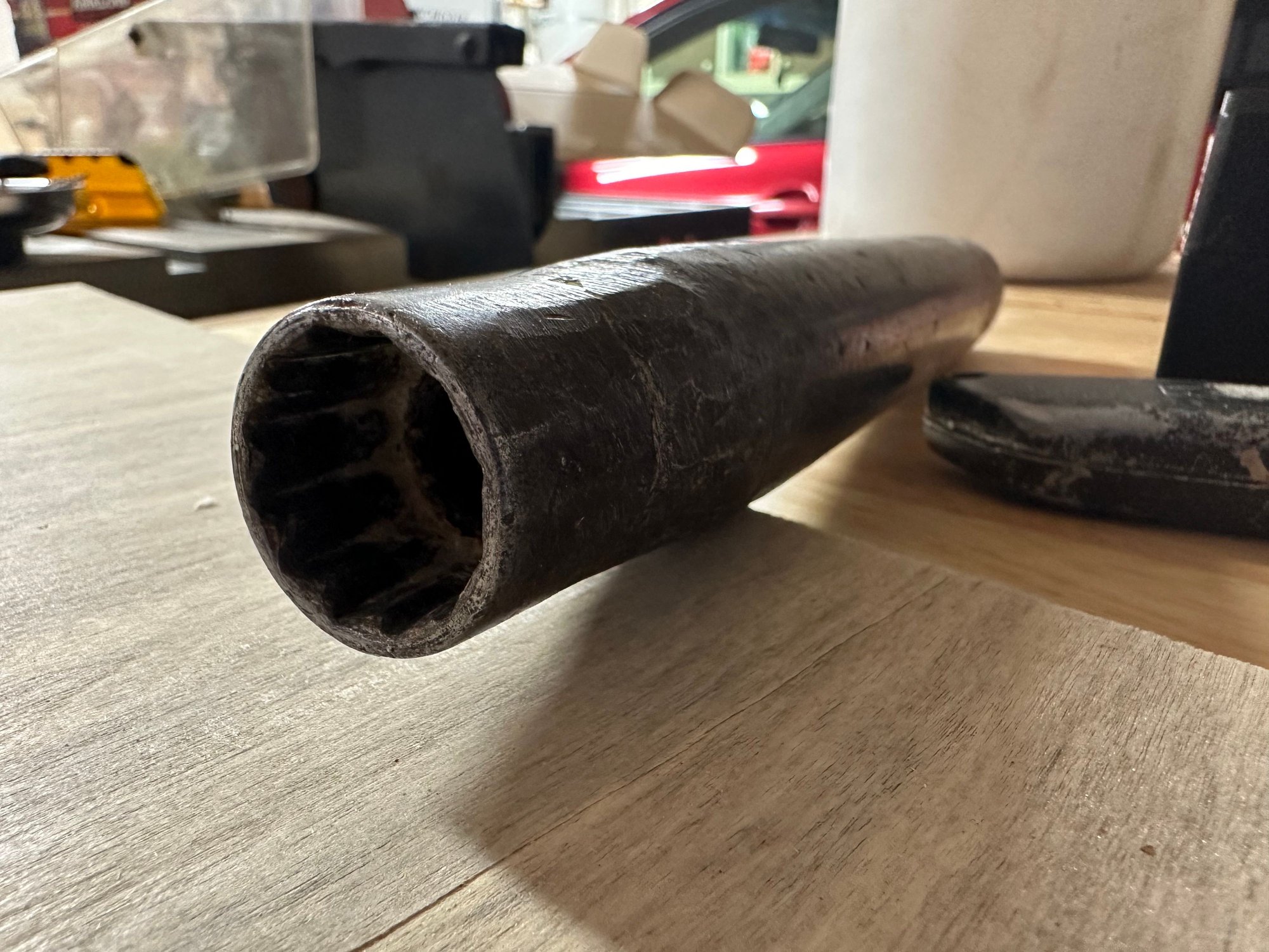

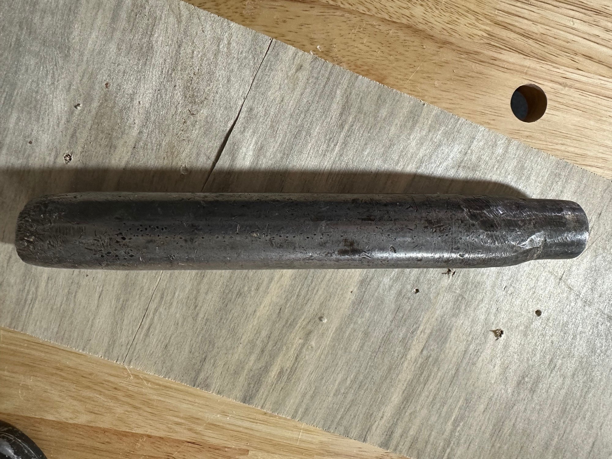

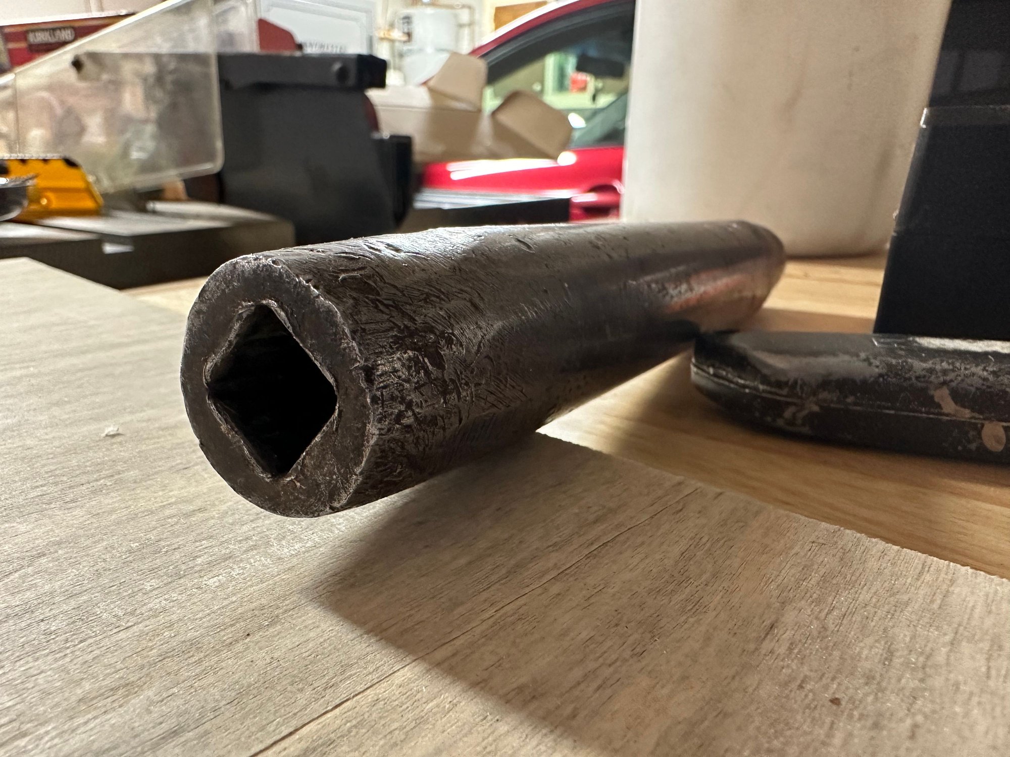

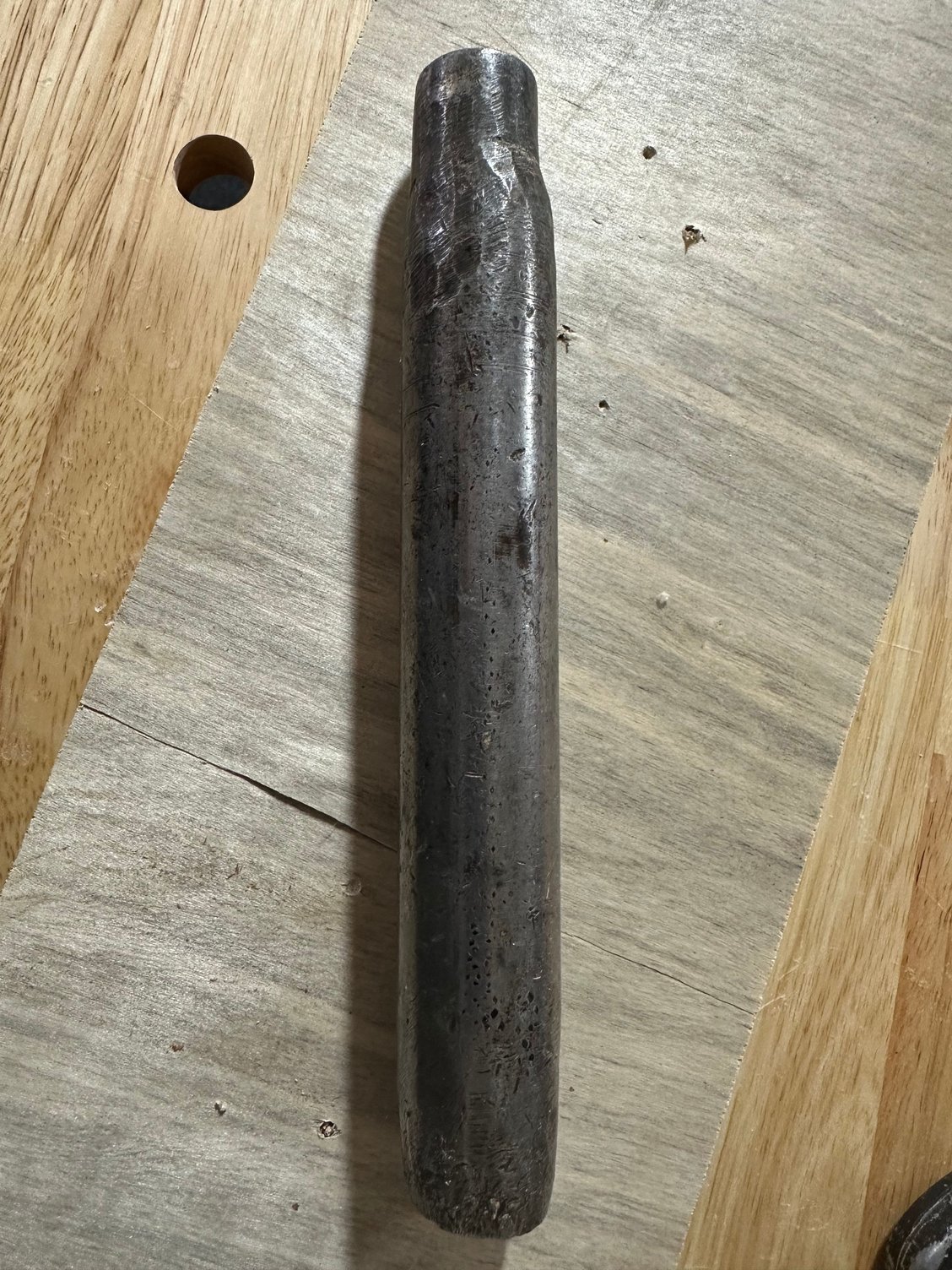

Here's some pictures of the "Socket" i made..
