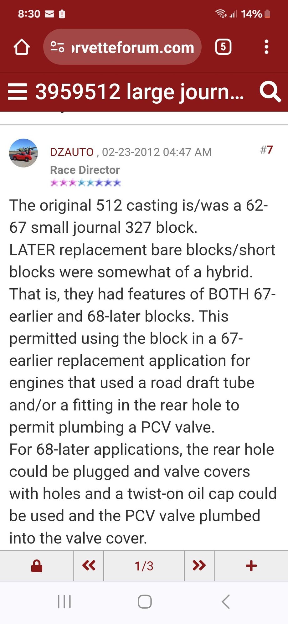

I just found this.

What confused me was the draft tube
