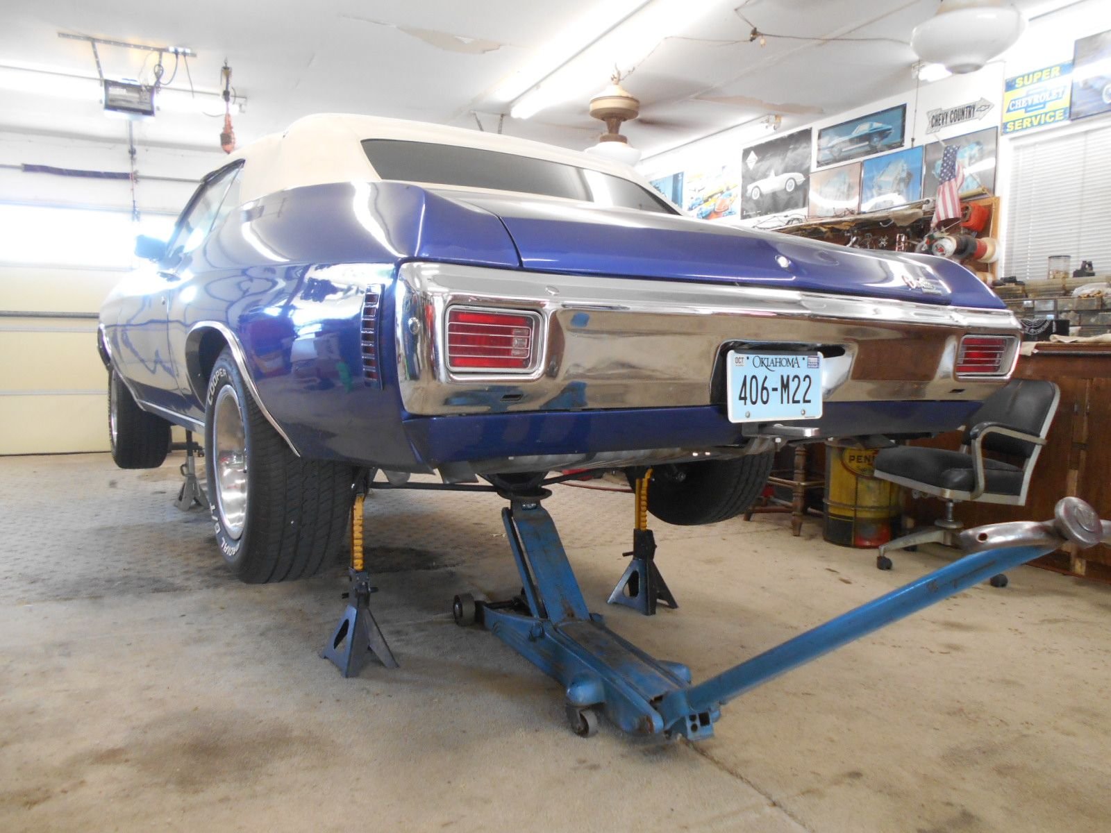

Now, just for fun, to torment others who do not know all the variations of a Muncie, aftermarket, offshore gears in various ratios are available for the Muncie.
l have built 3 M22W (wide ratio M22), one for our 70 Chevelle, two for other people.
For owners who have a high geared rear, and an M22 was NOT available, you can have your 2.73-3.08-3.36 rear and an M22.
You get the best of both, stronger gears and the distinctive M22 whine. I'm so vain that I just had to have one and don't have to lie about having an M22.
