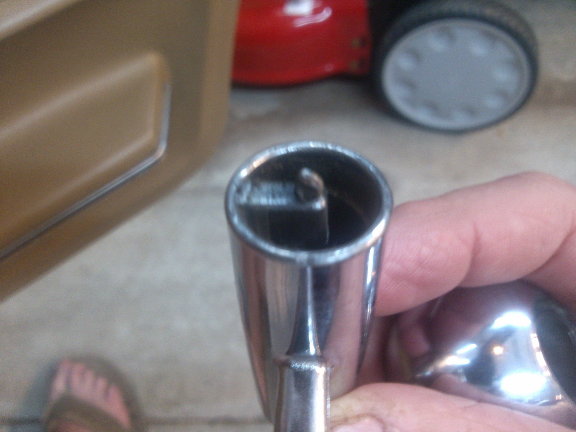

Here's the linkage from the bottom. Looks ok. I think the issue is with the reverse lockout not locking out reverse. I can get in all the gears, but it's nearly impossible to distinguish between 1st and reverse.
I unscrewed the **** and I'm wondering if this rod has slipped?

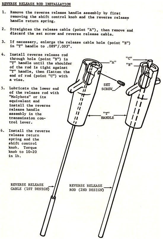

The top of that rod should be down to the top level of the tee handle push it down. There may be a set screw in the side or maybe not, maybe peened.

Old Mar 16, 2024 | 04:25 PM

Ok, went to the hardware store, picked some a new set screw and Allen wrench, put the small rod in the proper position and we're off and running.
