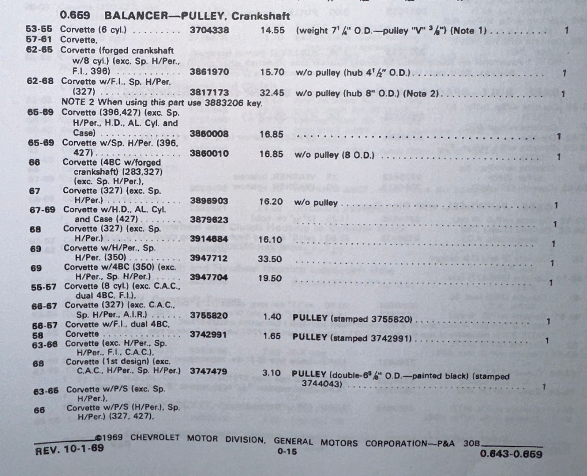

Here are the pulley part numbers and some dimensions from my 69 catalog if it helps.
Power Steering Pump
Crank Pullies
