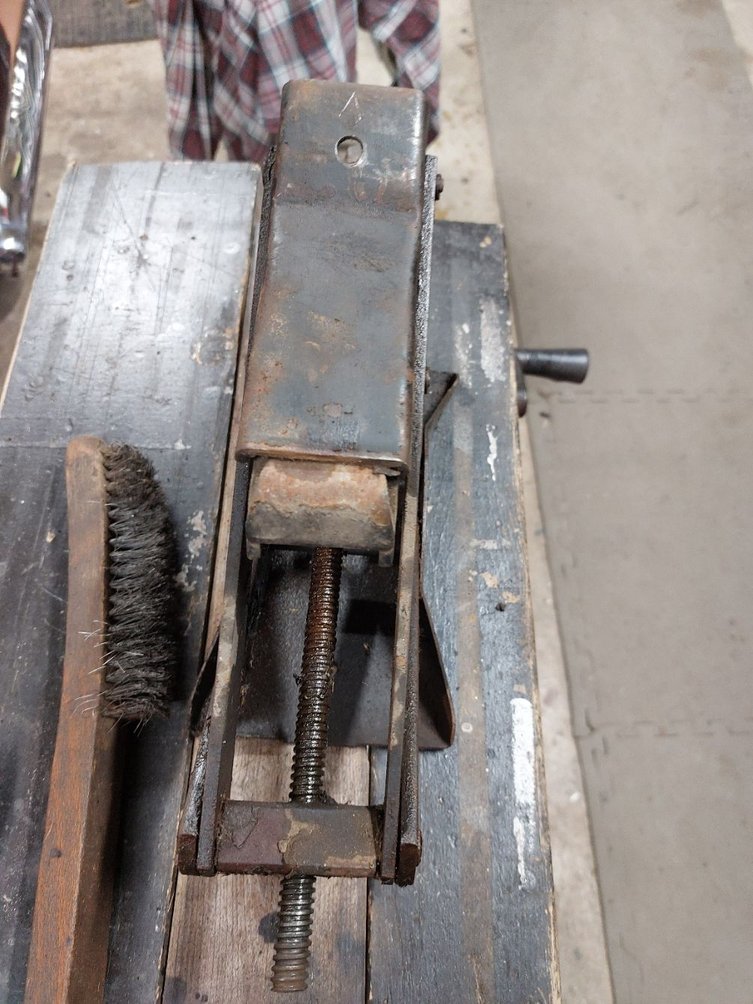

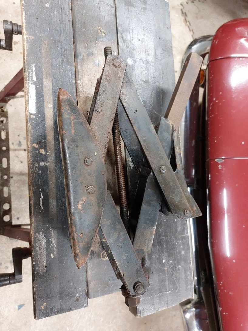

Scissor jacks were used in numerous vehicles in the 70s & 80s & beyond. The junk yards used to have piles of them. You might want to check your local salvage yard for one. I have one up on the shelf I think was a C3, that is almost identical to the one in the C2. Don't forget a board or plate to attach to the foot of the jack as they will roll over.

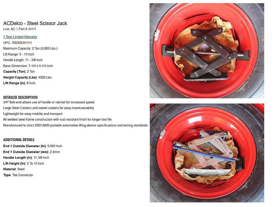

I have used this one in the past. Fits fine in jack compartment and in the spare of our '60.
O'Reillys has this one for $53.
This!
