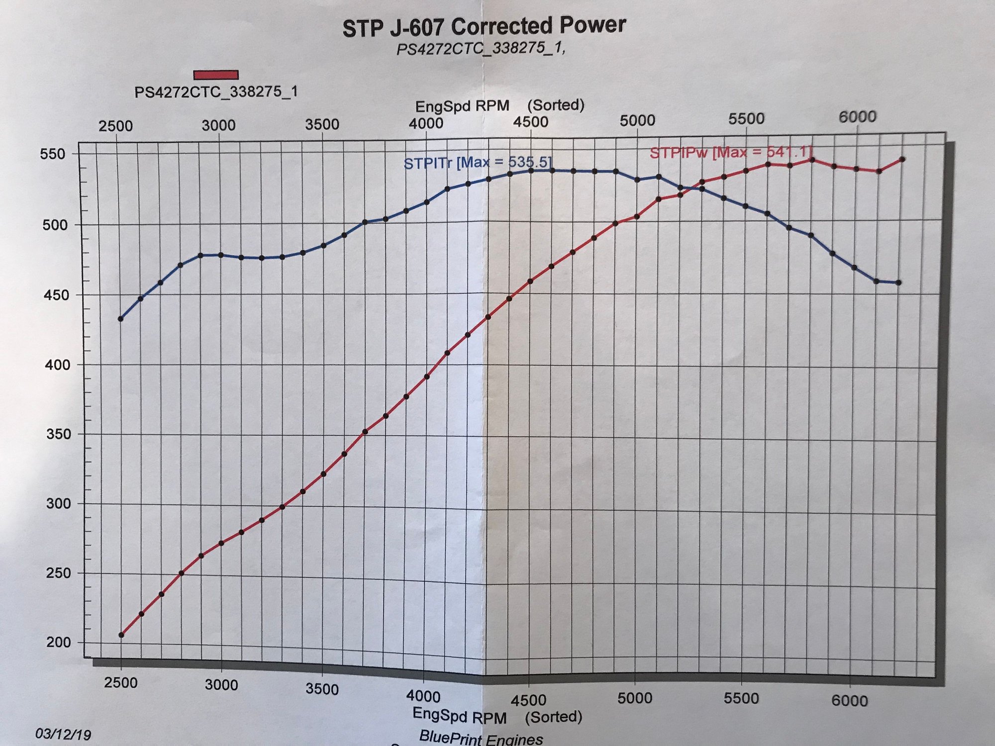

I’ve purchased three BPE engines over the years. They are top notch with many to choose from, plus each engine goes on the dyno to ensure proper operation and performance. They then send you the dyno results with the engine. Here is mine for my 1964 L76 which has the rest of the drivetrain beefed up.
Those are good numbers…..
