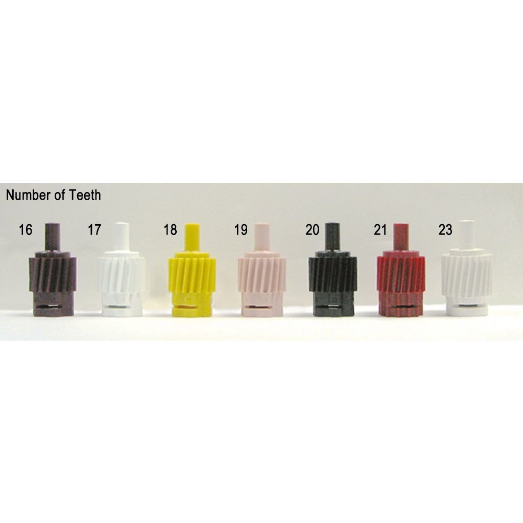

Also, while you are waiting to decide what to do, you could change the colored plastic gear in your transmission to another color and ratio which would force your speedometer to read higher. A temporary adjustment to be sure. C.J.
