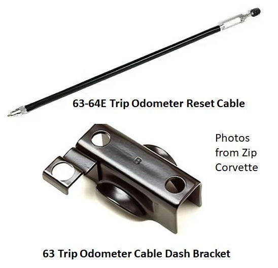

As stated above, it looks like the cable is attached to the odometer. The trip reset cable threads down to a bracket under the column. Shown below is the setup in our '65 and the parts for the '63.

Photos from my '63, which I presume to be correct but can't guarantee is the case, given how non-original this car is. Yes, the **** is showing its age.

Alright I need to come clean. I did not realize the true odometer reading is taken from the speedometer cable. Looks like I’m missing the necessary hardware to install the trip odometer fully. Oh well, glad to have the primary odometer at least.
