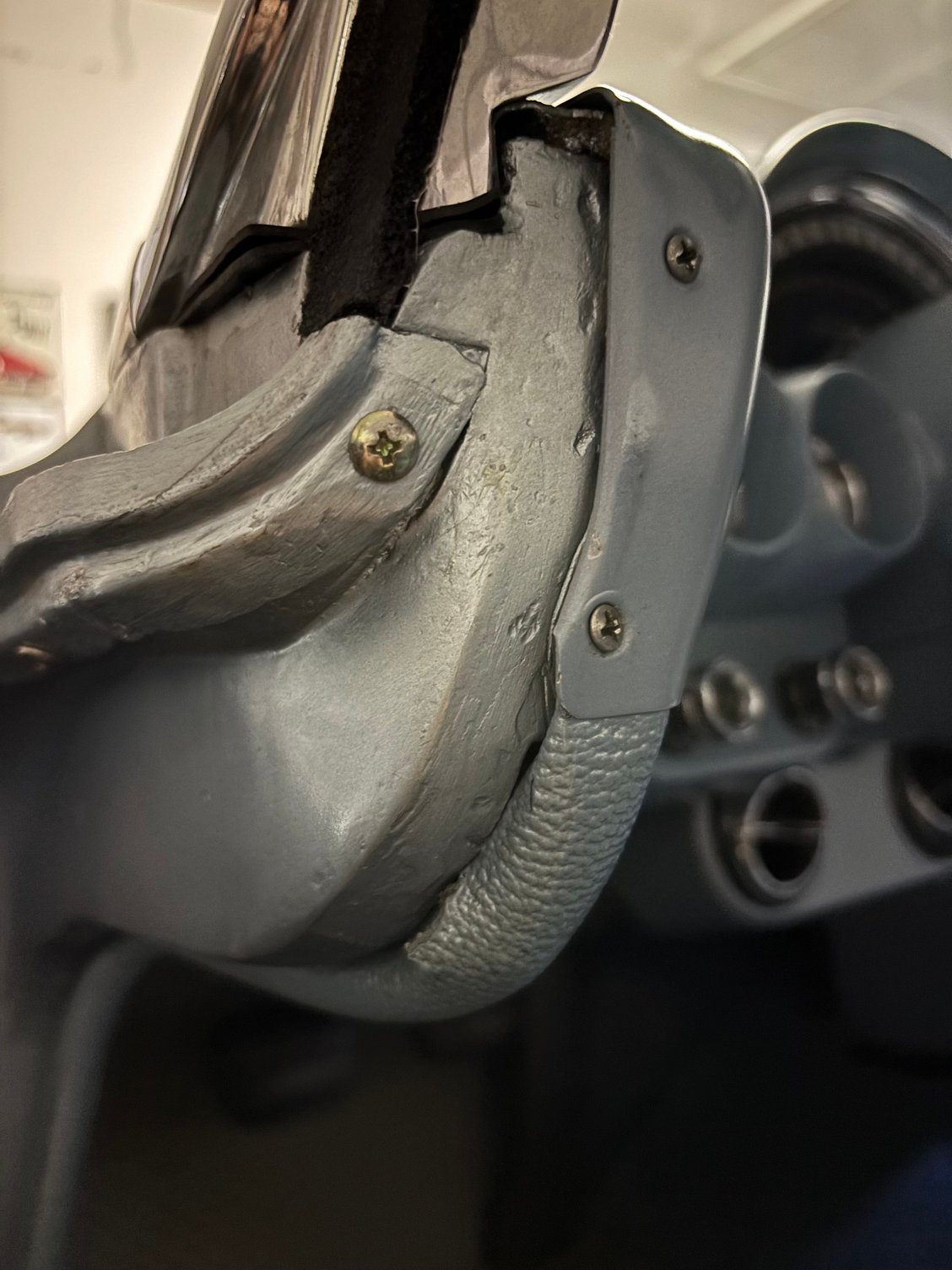

Can someone tell me how the edges of the wind lace are finished up
i bought them from Al knock several years ago and just installed the kick panels
should I have sewn the ends shut?
I could probably dye it
but I honestly don’t remember how they were when I took the car apart 8 years ago

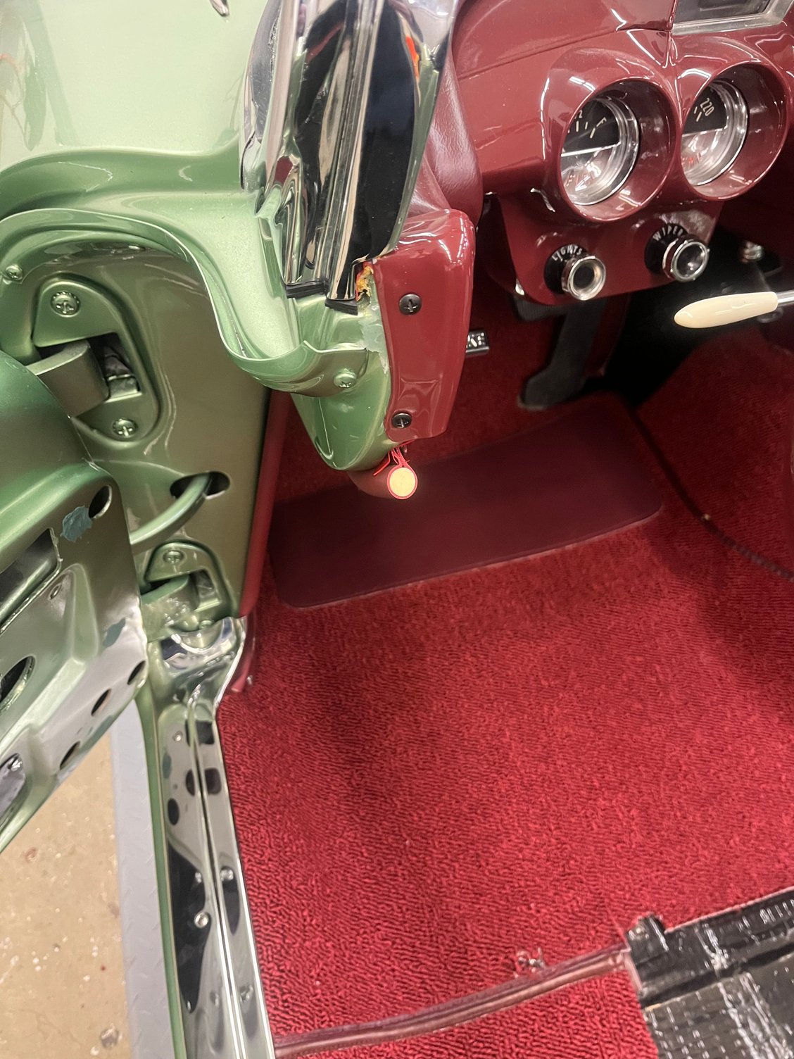

Here is mine,

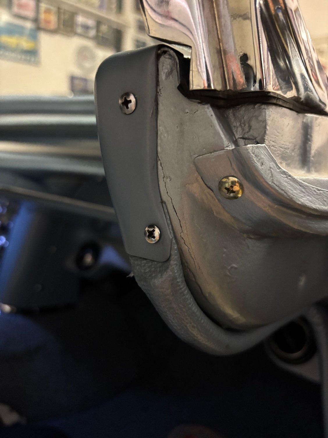

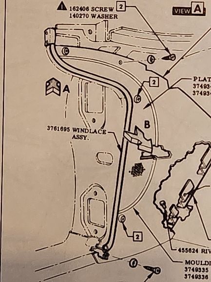

I didn't feel like going out to the garage and uncovering my 62, so I stole these images from Nolan Adams Restoration Guide Vol.1.

It doesn't need much to tuck under the dash pad end. Looks like you need less than an inch - how much is tucked under the seal plate? Enough to shift the windlace up some?

Before you tuck them, use a pair of needle nose, pliers to pull a chunk of the foam out, so that the vinyl will lay flat

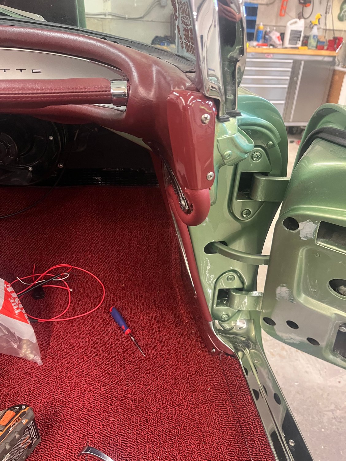

From my 58, only about an inch under the end cap
