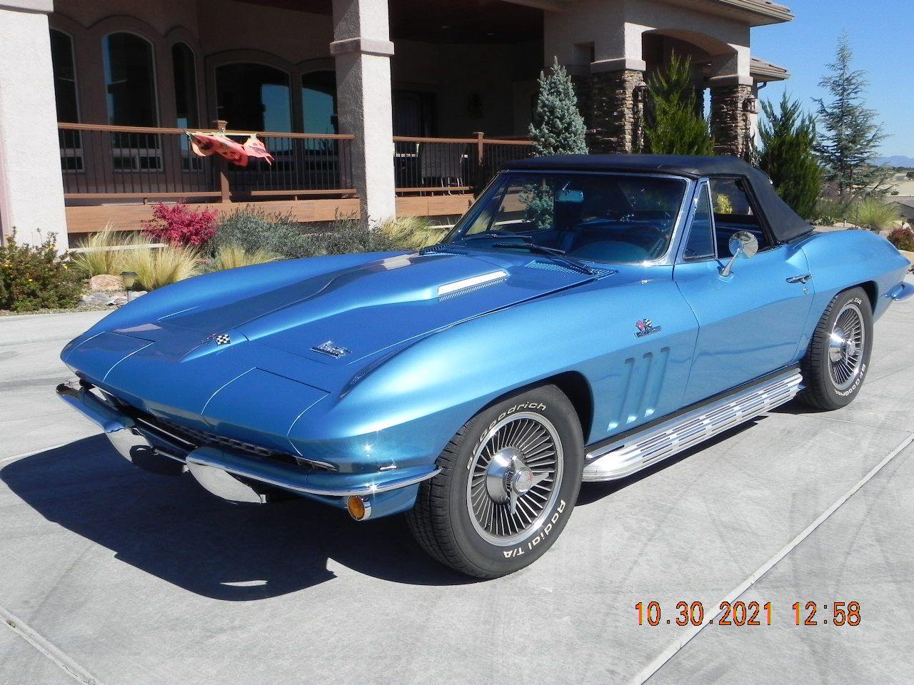

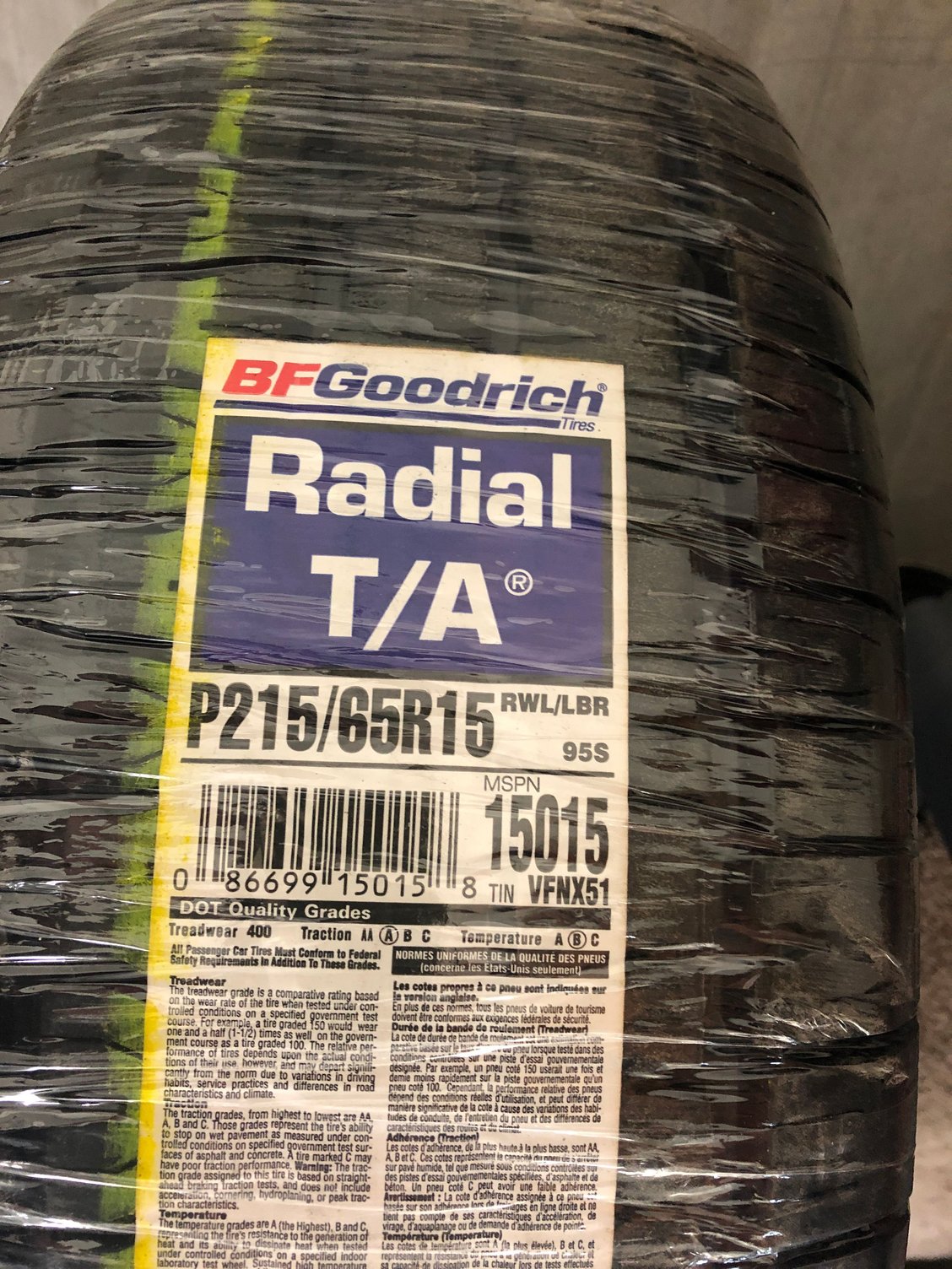

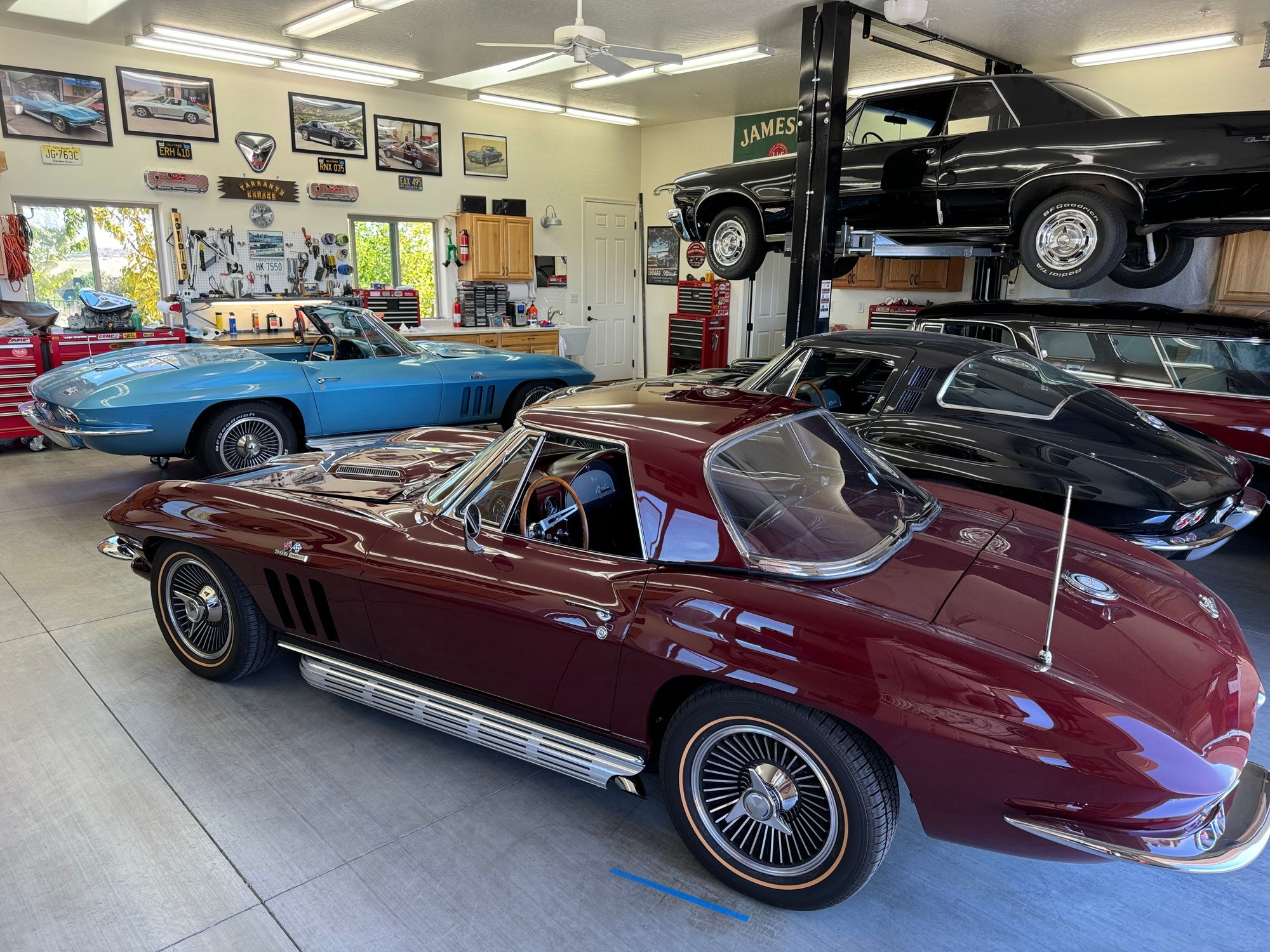

Juan - I run 215-65s on my Midyears, smallblock and Bigblock, front and rear. Just slightly wider than stock 205 size but I also like that they are a 26 inch tall tire so they drop the cars about a half inch over the 75 series tires.
The 66 Roadster has generic TA Radials in 215-65 and the Maroon 65 Roadster has Diamondback Goldlines also built on 215-65 TAs.
With the shorter tires, you might have to tweak the trans driven gear to get a good speedo reading.
