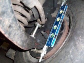

If all else fails, DIY alignment works fine.
Determine the centerline of the car. Front and rear tracking width are not the same. Level the surface on which all four wheels set. Homemade turning plates, plywood with zip-lok bags containing grease to allow the wheels to turn. drive the car up on the turning plates to assure the suspension is not binding especially the rear.
Homemade horizontal bar held in place with magnets used with a plumb bob at each end to set toe-in with a tape measure. Either a caster camber gauge or accurate level for camber and caster or a homemade caster gauge to attach to upper and lower ball joints.
This will not get measurements to the thousandths, but 1/64" is close enough for these old cars IMHO.
Plumb bob down from ends of horizontal bar to make marks for setting toe-in. Camber gauge or even a level to set camber and caster.
Homemade tool to check caster.
Nuttin' fancy, but works. I have so many one or two time use tools in my box that I need a larger box.
Faster to pay for a pre-engineered tool, but kinda' fun making your own.
