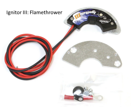

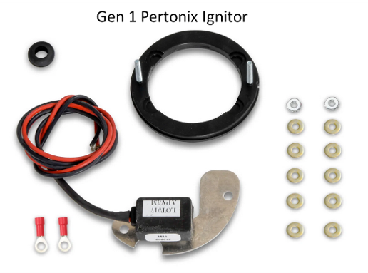

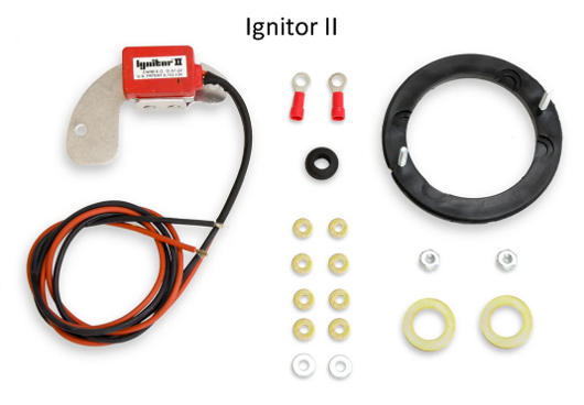

As I read your symptoms, I guess it could be the Pertronix unit BUT, only if you're is using the Gen 1 or Gen 2 Pertronix Ignitor I / Ingitor II because the most recent Pertronix Ingitor III (Flamethrower) is solid state and not subject to the same failure modes as with earlier version.
Some more details...Both Original or Gen 1 Pertronix Ignitor and Gen 2 Ignitor II used a Magnetic Ring that could shift/warp or delaminate under heat - Creating intermitent failures due to mis-aligned magnets in the ring. This could and reportedly has happened in several cases causing these intermitent failures before it would simply not start / run...
As you can see below, the 3rd Generation Pertronix Ignitor III Does NOT use this magnetic ring and is solid state chip. Thus the failure modes are different and the intermitent failures due to slippage / delamination of the magnetic ring is eliminated.
The crescent shaped piece in the picture above is just an aluminum base to attach the Ignitor III-Flamethrower to the Base Points Plate in the Distributor.
In my years of experience with using Pertronix Ignitor III - I have found it is sensitive to good grounding @ Installation, but otherwise rock solid once running.
I've added these details only to help Warren in diagnosis and maybe as general PSA for those without first hand experience with Pertronix. I want to layout the differences in the 3 versions or Generations of the Pertronix ignition technology because they are much maligned and I believe without specifying which version Is / Is Not having problems... Ironically, Pertronix still sells Gen 1 and Gen 2 versions on their website... I wouldn't buy one unless i needed it for repair of current install and even then upgrade to Gen 3 is simple and better.
