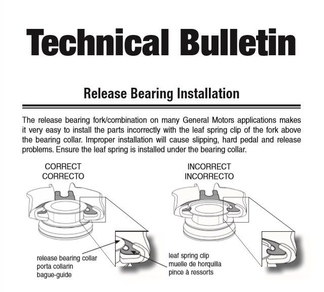

My bet is someone installed the throwout bearing incorrectly. People like to install them wrong.

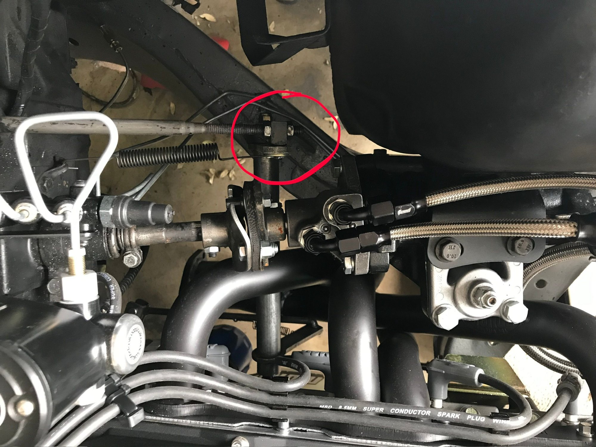

Could you share a picture of the clutch rod where it connects to the z-bar? It’s in the engine bay below the master cylinder. This is the adjuster for the clutch. With a new clutch, where the adjuster sits is important to this conversation.
Here it is circled in red.

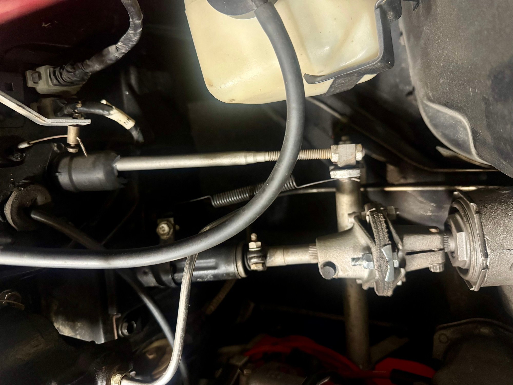

Here is the photo in my Corvette. It is a 65 but not a "matching numbers" car. I have a 350/400 small block Chevy engine.

In my opinion, if you have a new clutch and the proper z-bar and rods, that adjustment is way off. It would cause the clutch to catch at the top of the pedal and perhaps have the TOB riding on the pp. seems the installer knew this as they adjusted it as far as they could and it’s still not right. If it’s the correct mechanical linkage and clutch, then an incorrect TOB was used or the TOB was incorrectly installed. I would start with the easy stuff by verifying the z-bar and rods are correct for your car. Someone will post the picture showing the differences and dimensions, I don’t have it. If the z-bar and rods are correct for your year and small block (big blocks were different) then you will have to pull the tranny to address the problem. Perhaps use an inspection camera to eyeball the TOB install first.
You mentioned the clutch you had was wrong for the car. Why? Did it not work, worn out, etc.? One of the many mysteries of these cars is “what was changed over the years?” You have a different engine. What else is different?

Mark is right - your clutch is adjusted way out nearly to the threaded end. So there is not much room left to adjust it away from the floor. You may need a longer upper or lower rod to get the adjustment off the floor. But I doubt that is why the pedal force is high. Possibly the TObearing is incorrectly hooked to the fork and dragging on the collar. But I think if that’s the case you would notice some roughness and catching when cycling the pedal up and down. I would call your mechanic and find out where the clutch came from and the manufacturer.
edit: But an improperly installed TObearing on the clutch fork could also contribute to the clutch releasing at the floor.
