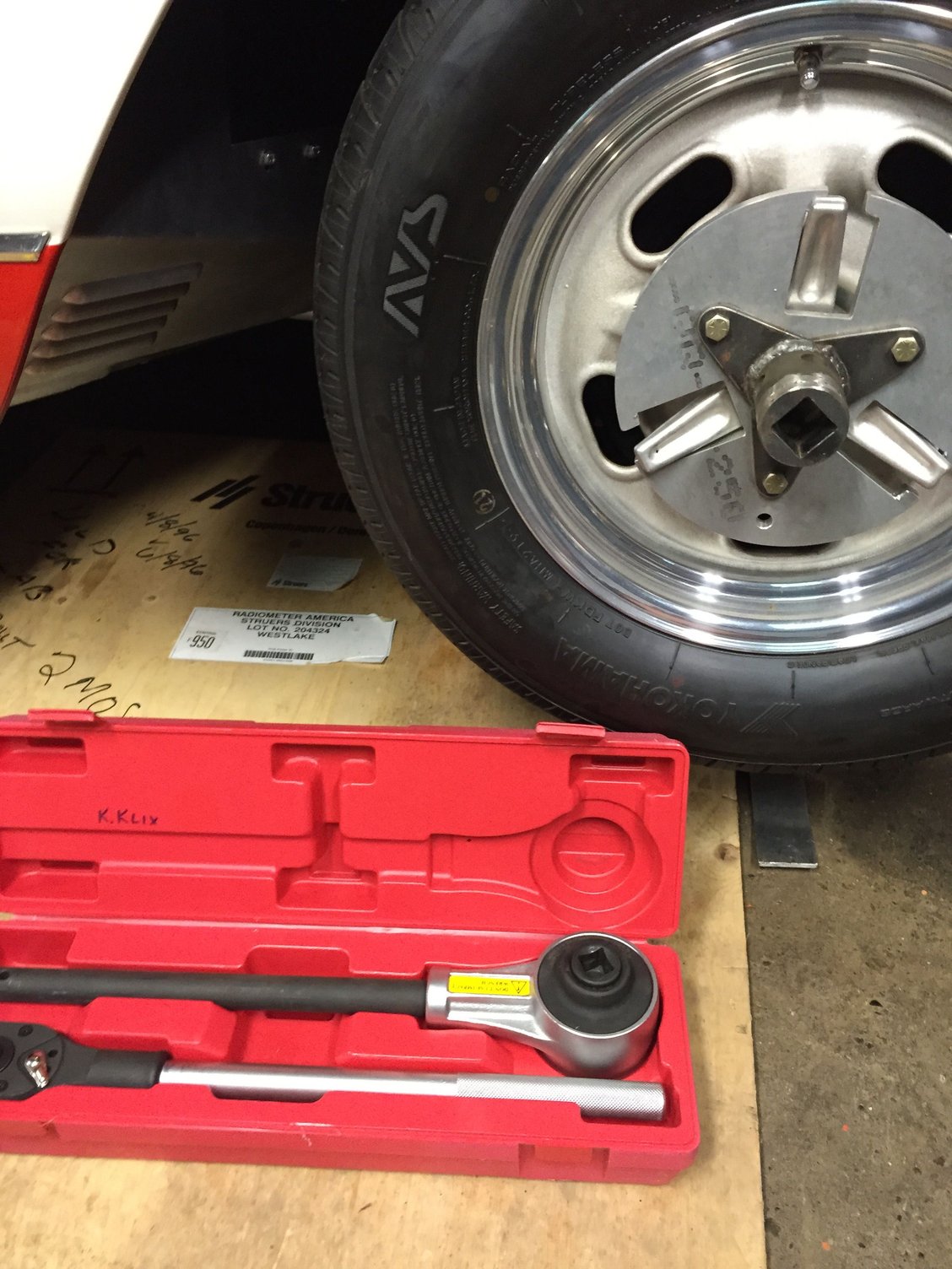

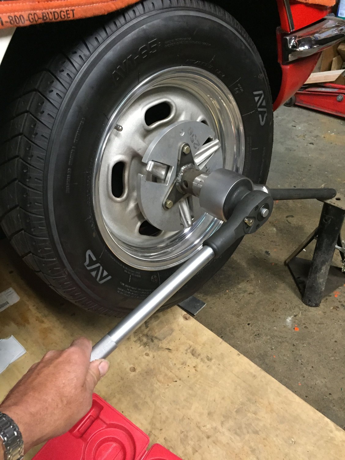

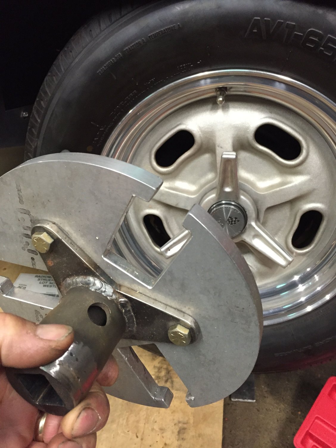

Here is how I do it. Built myself a special spinner socket and purchased a torque multiplier which has a 3:1 multiplication. Can now easily tighten or remove without breaking a sweat or risking damage from misguided hammer blows.
Gotta admit, that is just slick!
