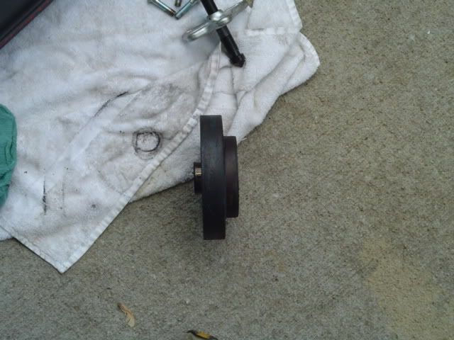

here's the one I replaced... was just about rubbing the timing cover.. thankfully it didnt!
