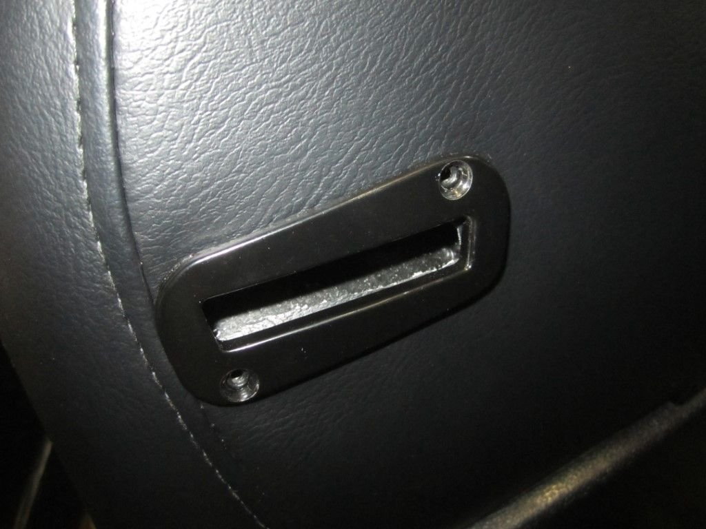

hi I have new vinyl seat covers withe the slot trim on the front but not on the back, I can feel the slot trim on the back through the seat cover scared to cut the slot without some back up from someone who has done it before. Is there a plastic trim that covers the slot so it doesnt get torn by the belt.

There is a bezel on the outside

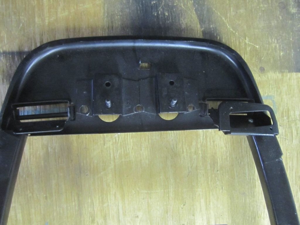

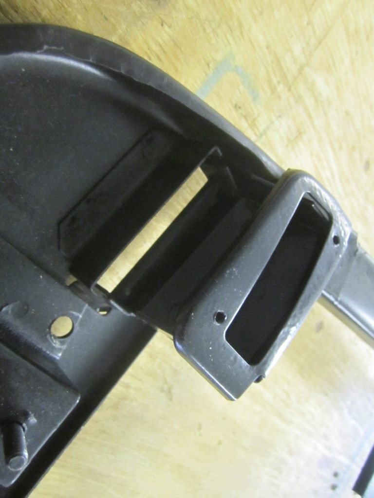

It is screwed to a guide on the inside, make sure you feel that, it's only on the one side where the belt would go
Both sides of the seats are interchangeable (drive pass) so that inside guide part can be moved, inside is the bit that is on both sides
M
thank you for that info mooser👍It seems that whoever fitted the cover put it over the trim as they were not using the slots for shoulder belts ? I wonder if I could cut a slit in the cover and carefully extract the trim piece and refit it on the outside of the cover ? Then I would have the slot ready to receive the new shoulder belts. Just trying to avoid removing the whole seat cover as sounds a bit daunting 😩

I don't think you could slip the bezel out of a slit in the cover, it's too large to maneuver through the slit. Also I'd make really sure what you feel is the bezel and not the guide, they are basically the same shape as I show there.
If it's just the guide then no problem, buy a set of bezels, cut the slot and screw them on
if the bezel is inside (double triple check, seems weird)
Cut the slot and make two small holes where the screws are and remove the screws, you might be able to maneuver the bezel around to come out the slot and then you can put it back on and feed the belts as detailed above
If you can't get the bezels out for some reason you'll have to go in a bit
Take the back cover off the seat (plastic part) and the tilt button then you can unfold the cover where it meets in the middle, it's two pieces of plastic that just hook over each other sideways and are held with the button trim and back plate.
you should be able to fold it open enough to get at the bezels out, then re-attach everything and move forward
M
