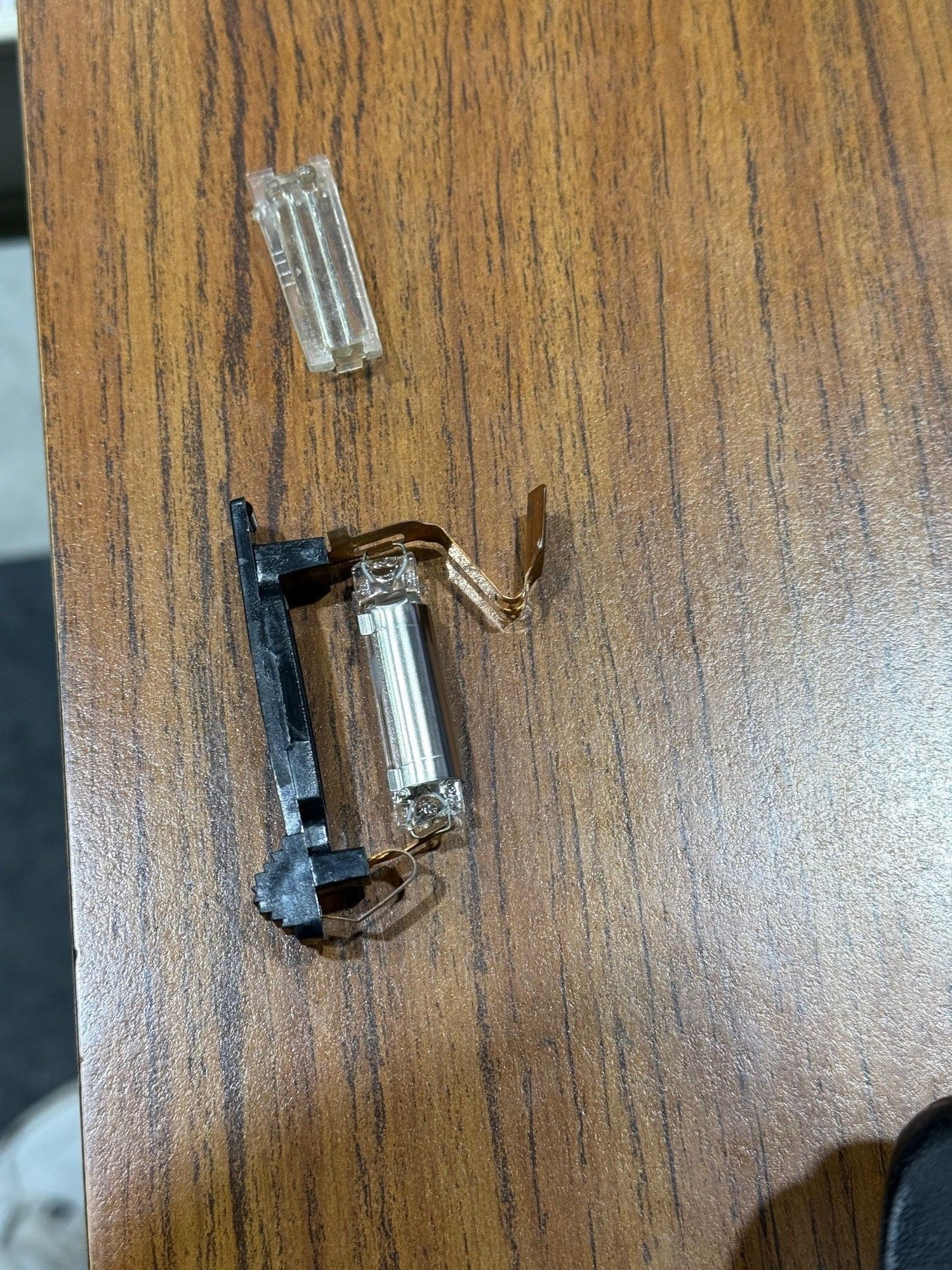

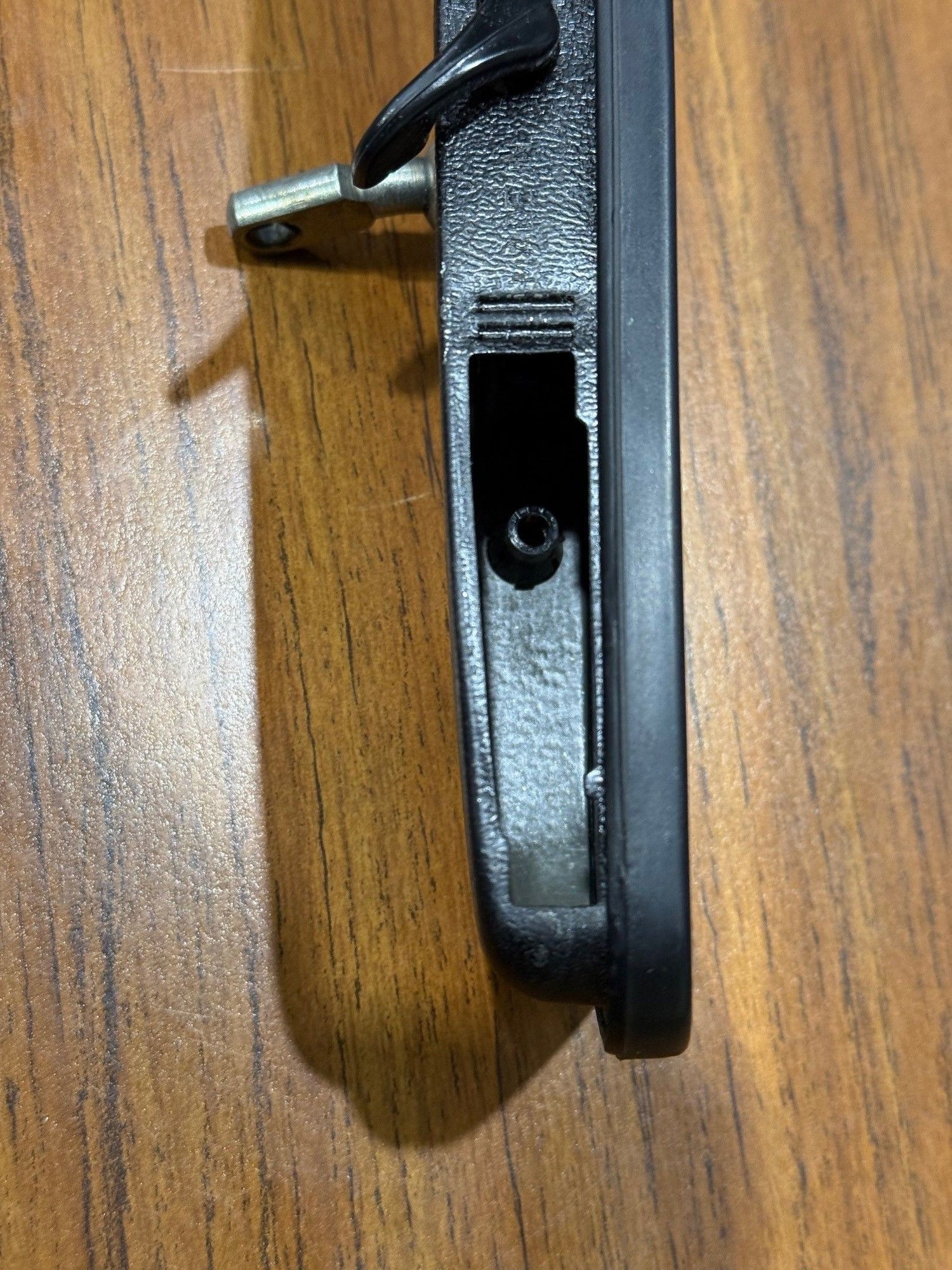

Here are some pictures for the 73 vet map light mirror. Take out the lense, it has clips on the 2 short sides. Push gently on the middle of the 2 long sides of the black plastic housing and the whole assembly will come out.
mirror with light removed
light assembly
light assembly
