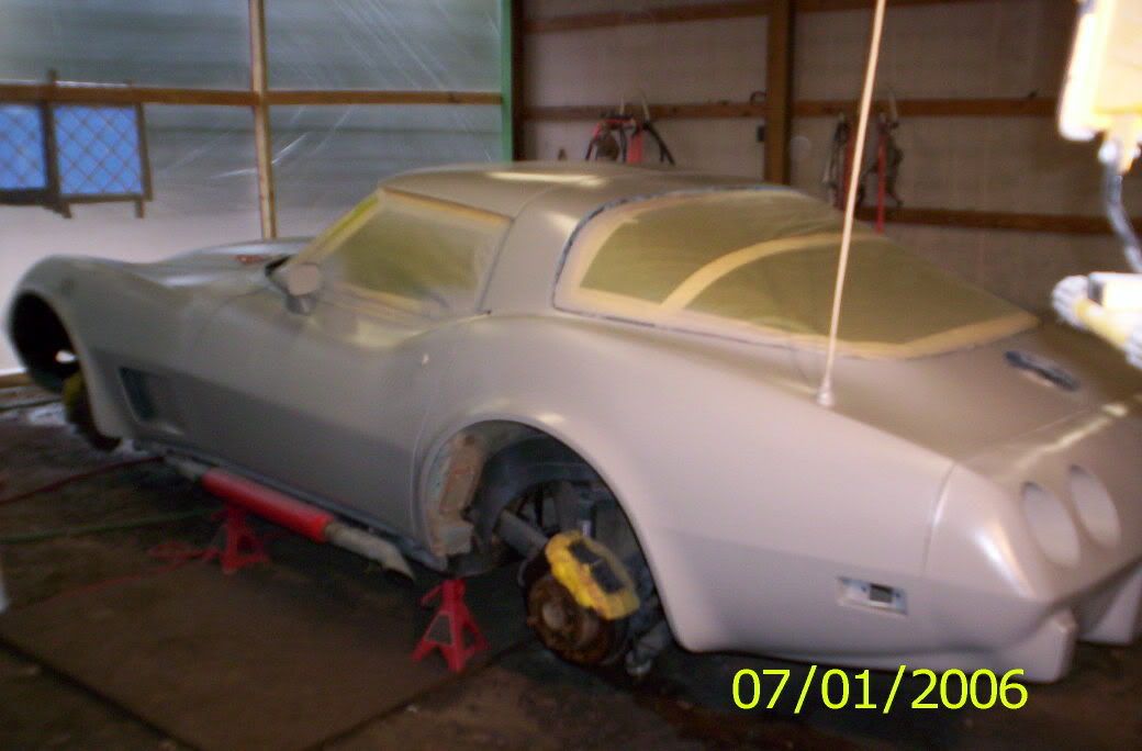

I have to thank all the forum members who have given me some great advice on this project. This paint job isn't the greatest, but after I finish wet sanding it should be a decent 10 foot car. I used a hood from one of our company trucks as practice, it was a great piece to make mistakes on. (I also wasn't too concerned if I screwed up, my employees will do that for me in a week ) The total cost including spray gun, air dryers/oil removers, plastic for the garage, sand paper, paint, primer, and all the paint additives, was about $500. Thanks again for all the great help.
Now I need to wet sand, and install all the other trim pieces.
DR. Jay

One of the things I noticed was how much of a differance putting plastic up on the front of my garage/car port, and using an industrial dust surpressant for construction sites on the floor (Yes it is a gravel floor) really cut the mesquitos/dust down to almost zero. I also pressure washed the ceiling, and walls down prior to beginning the job.

No I had to replace the entire front clip, so I used chemical stripper, and removed all the paint down to the original primer which I washed off with Acetone, and green Scotch Brite pads. I tested the stripper a year ago on a piece of the old front clip; striped, triple washed, primed, painted for longevity to see how it would hold up. A year later it haden't lifted.
This is what I started with.
That was January 28th 05.

Originally Posted by sperkins
Good job so far. What type of paint system did you use?
Base/clear or single stage?
Specs on paint gun?
Did you get a lot of trash?
- Very curious -
Hopefully I'll be laying on the color in the next couple of weeks.
I used Napa's Cross Fire Urethane Enamal system.
The spray gun is a Ingersol Rand gravity feed HVLP gun on sale at Home Depot $89.00
The biggest problem I had was sweat. I was so nervous about screwing up the paint, and it was over 90* in my garage even with the exuhast fan drawing in filtered outside air. I kept having to watch that I was not dripping sweat onto the paint as I was spraying.
I doubled up on the inline desicant dryers, and oil removers to keep trash out of my paint.

Originally Posted by skeptic
Looks great, I'm rapidly becoming a fan of bright yellow Vettes. I am curious about something though, probably 'cause I don't know anything about painting cars. I notice you left things like the antenna, door mirrors, and door locks on the car. Wouldn't it have been better to remove at least some of them (antenna/mirror, not sure about the locks)?
I thought about removing all the accessories, but decided it would be just as effective to mask off those parts. The door mirors had to be painted anyway to match. I used a hobby knife to cut in all the masking tape around the antenna, and door locks. I also scribed with the hobby knife around the masked areas after the paint had cured so when I removed the tape it didn't crack the paint.
