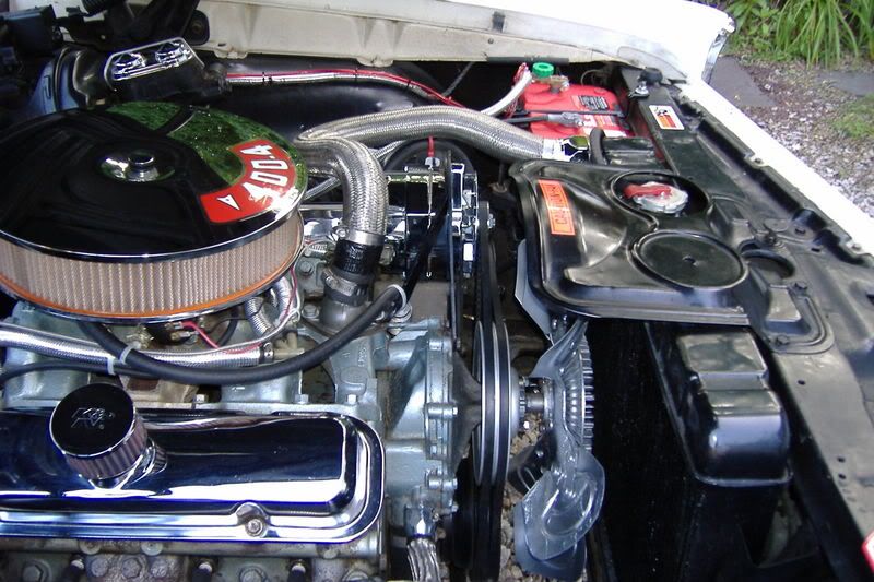

I'm thinking about buying one of their kits. How do they look? Do you know if they look alrigh next to real braided lines? (in other words is it obvious that they are immitation / cheap covers and not the real thing?)

i had the SS braided hose kit on all my hoses, looks great at 1st but then turns colors after the years(4 to 6) & looks like sheet so i removed it all. stick w/the real stuff.

They SUCK! Phoney hoses are just that, phoney, and raises the creditability the whole car. Kinks, wrinkles, dents, you name it most of the cars that have them on have one or more of these charactoristics. As a judge they turn me off.

The cover kits look like an old sock wrapped on your hoses. After all the $$ and time spent on your car, go the extra couple hundred and put on real SS braid hoses. Nuthin like em, just look at TT's car
