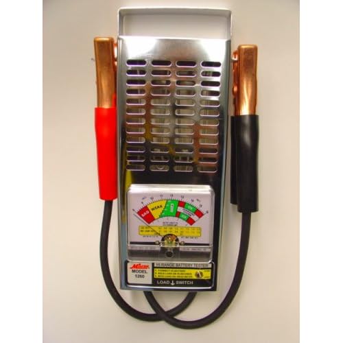

Originally Posted by 427SIXPACK
HERE IT IS :
MILTON 1260
IS THIS THE BEST..........WHAT OTHERS DO YOU GUYS LIKE ?
The Milton 1260 is the top of the line. You should be able to pick one up for between $55-$70. I have had mine for years or you can go the cheaper route and get the Chineze copy from Harbor Freight for under $20. It looks pretty close to what the Milton looks like but not exact. Don't know how long it will last or how well it works for sure but for the money it isn't like it would make one go broke if they purchased one. Put it this way it is better then having nothing at all to use and if it works well and lasts you make out.

Having the Milton Testor would of eliminated any guessing here. Just bringing it back to Sear really wouldn't of solved the problem. If someone goes out and buys a new battery and installs it in their car and it starts the car chances are there is nothing wrong with the battery. If it goes dead it was probably caused by your car while it was installed. In this case one needs to own a battery charger to charge the battery up and then to test it with a Milton type testor giving it a load test to see if it truly is the battery. Being in the parts business almost 30 years I can't tell you how many times people brought in perfectly good batteries and purchased a new one because of (guessing) thinking it would cure their problem. I have also had the customer we were just talking about bring a brand new battery back thinking the new battery was no good but the car it was installed in caused the battery to go dead. Now I will guess it is possible that a brand new battery was bad but not probable. I would of thought that a place like Sears would of tested that new battery before it left the store. Most places like Sears only keep fresh new batteries on the shelf maybe no more then a couple of months before it is rotated with new stock.

Well 6pack the first thing you can do when you get home is start your car and flip your seat up. Open your battery compartment and clamp both cables of your Milton Testor in the correct way to your battery and instantly you will see if your car alternator is putting a charge back into your battery. Since you are not having any problems you should be in the green (OK) zone all the way to the right of your meter. There you will see exact reading as to how much is being put back into your battery. Enjoy your new (toy) tool. Believe me you are going to realize in the near future that it was one of the best investments you ever made in a tool for your car or cars.
What ever you do don't try a load test while the car is running. Shut the car off first!
