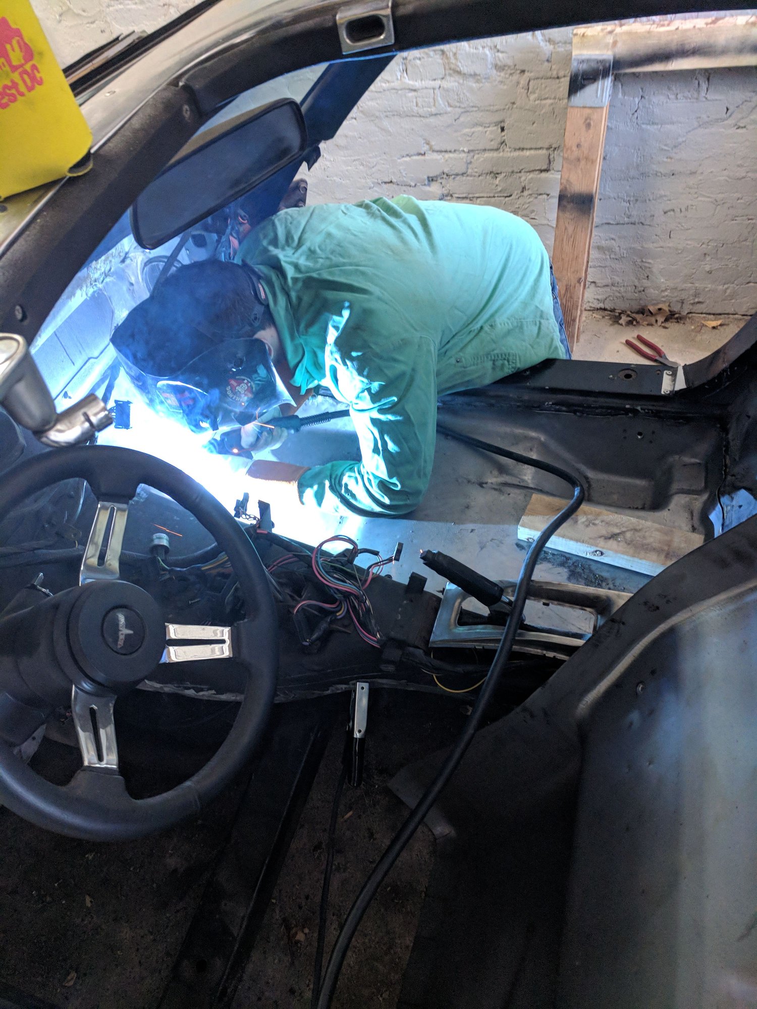

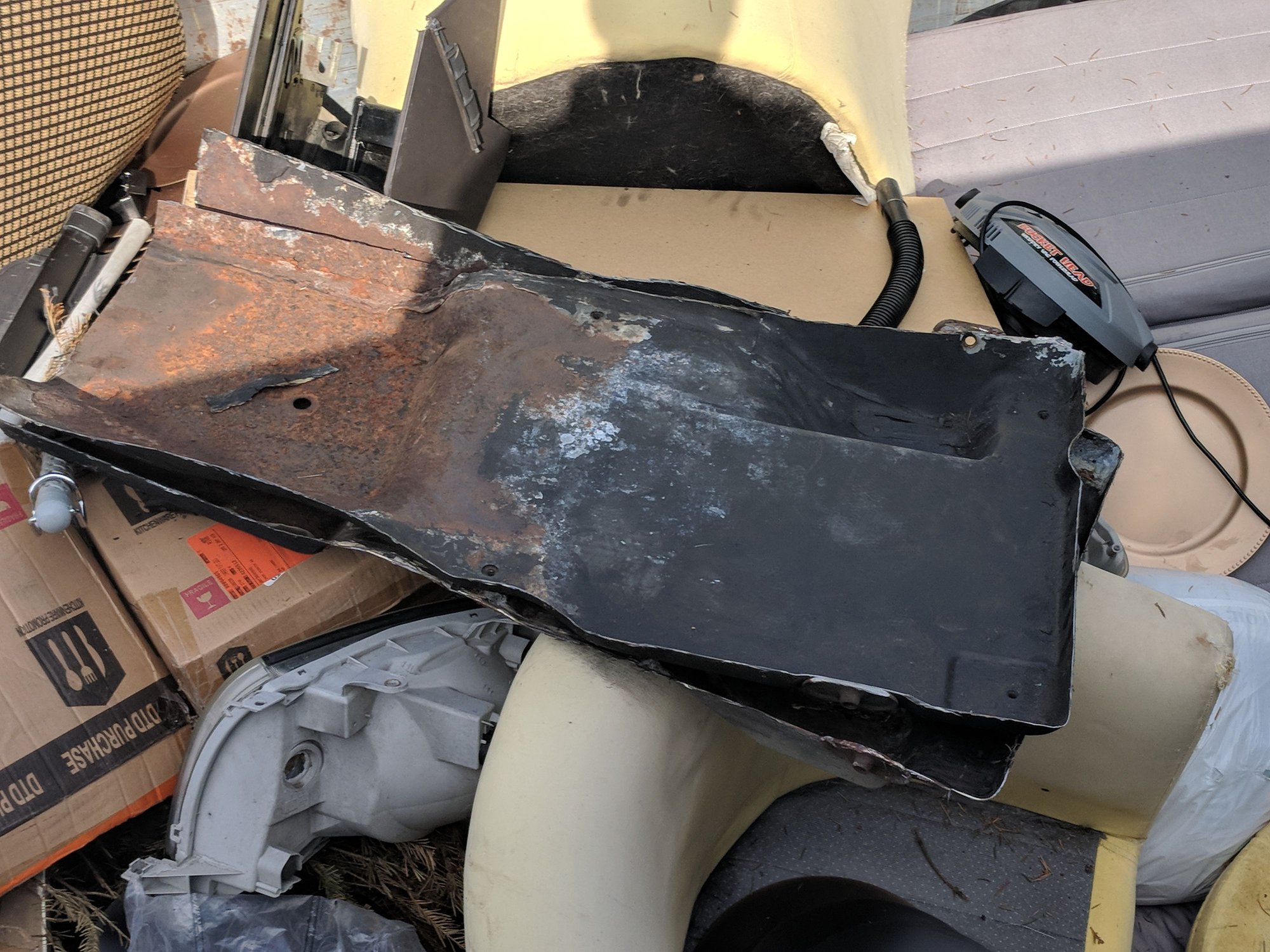

I appreciate this old thread immensely and want to keep it going as long as my Vette is going, which should be a pretty long time. So this post is almost 12 and half years since its original posting, and several more months since I actually purchased my first Vette (and car) and I still got work to do. I don't consider myself someone who can restore cars to show quality but since the frame on mine was replaced, a long with 50% of the rest of the parts, I think that ship has sailed for me. So now it's just a matter of making this one my own.
Those are a few snaps of us replacing the rusted out floor pans on the 80. I was hoping I'd be able to just buff off the rust but the first attempt with a brass wire wheel busted a huge hole through the floor. So out they came. This was an involved one but it forced me to buy a welder and learn to weld (with the help of a certified welder of course).
Once I finished getting the floors in, I coated every inch of them with frame coating and sealed all welds and seams with whatever Eastwood products said they'd do the job. After this came new carpets and putting the seats back in. I tried to prioritize all the work that I have to do by cost and what I cared about, and frankly seats came towards the bottom. So because of this, I threw some seat covers on the older seats and mounted them back in.

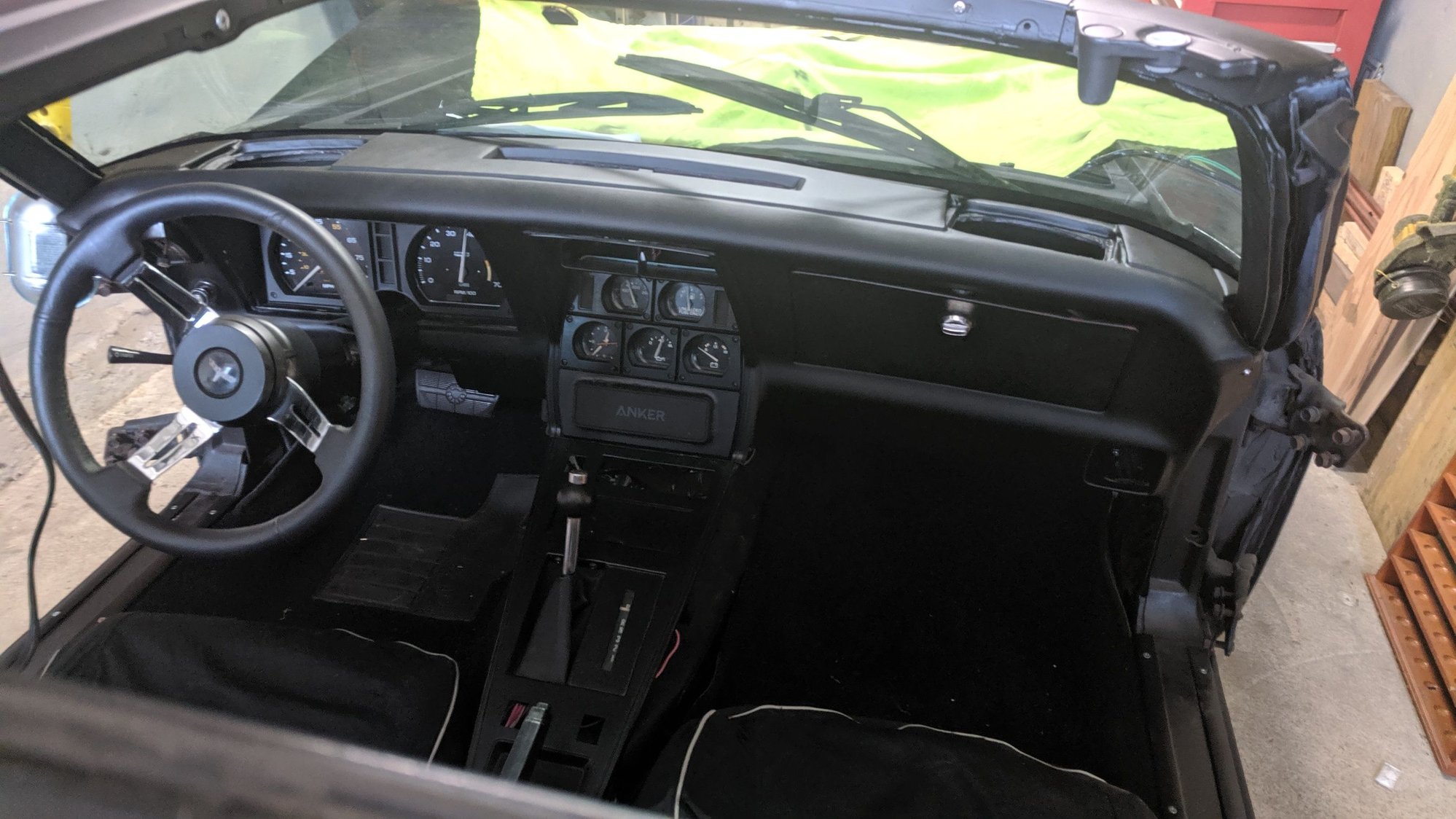

To finish off the interior I installed a new dash (on top of the new dash harness which is a whole post in itself) then installed the refurbed speedo and center gauges along with a little custom radio I fabbed up. I didn't particularly want an old school one and the new kenwoods didn't tickle my fancy so I went full bluetooth.
At this point 95% of the interior done with the door panels and some rear compartment trim to take care of. More to come.

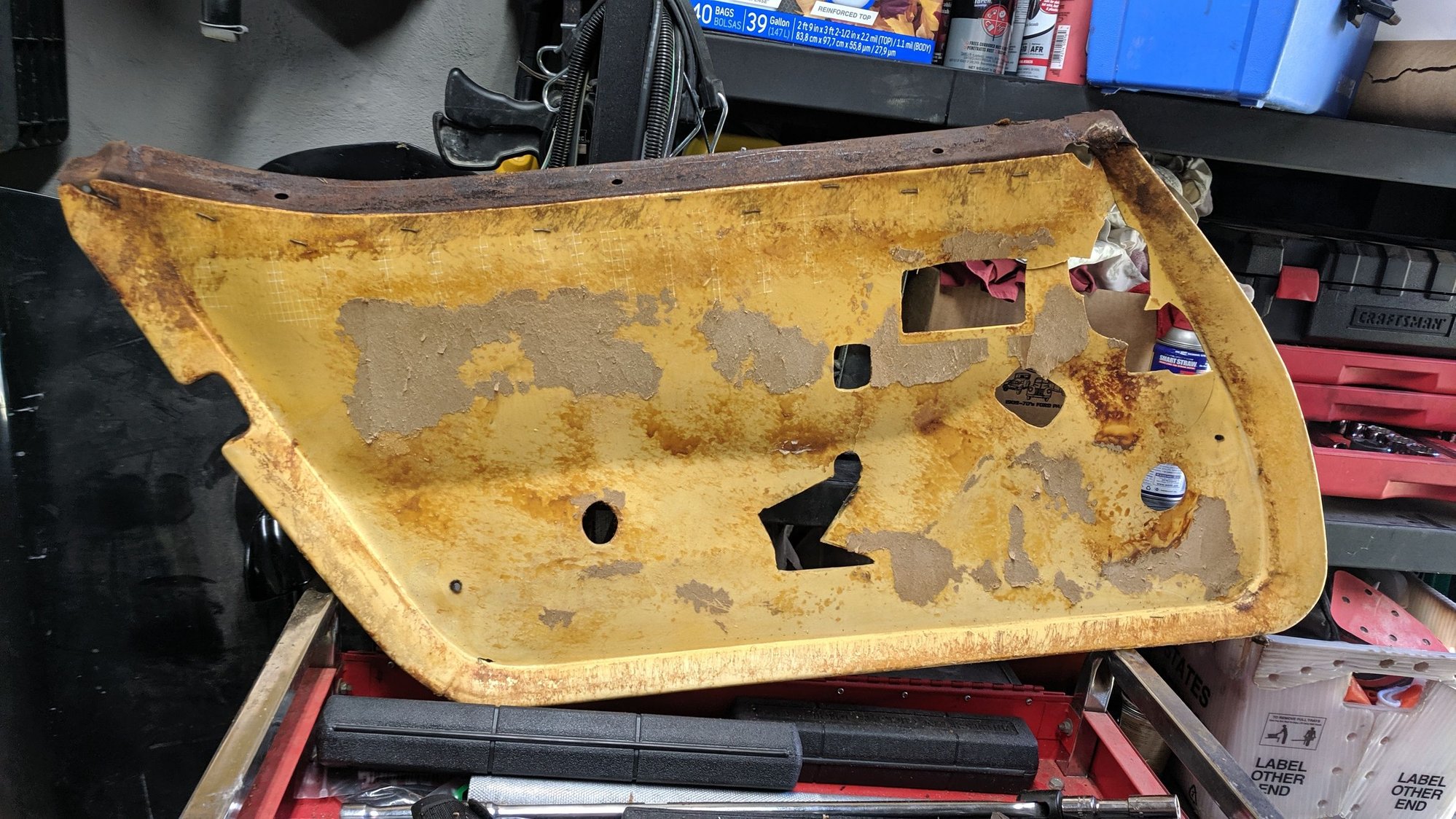

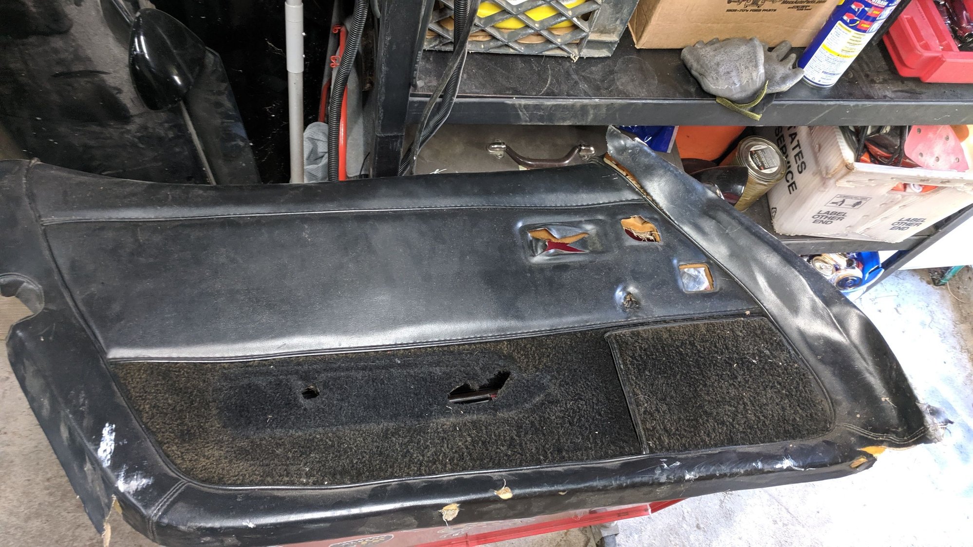

Quick post on the doors. I took them all apart since the windows never really worked right, the panels were trashed from the prior owner, and wanted to get rid of as much of the power windows and wiring in general that I could.
Door panels off.
Stripping the old covering from the panels and ready for some love.
Door guts redone and all the old power window stuff removed and new manual gears, slides, and whatnot all installed and lubricated.
Still have to finish the panels but that seems like a warm weather job to me. (currently low 30s hear in Maryland and no heat in the garage)

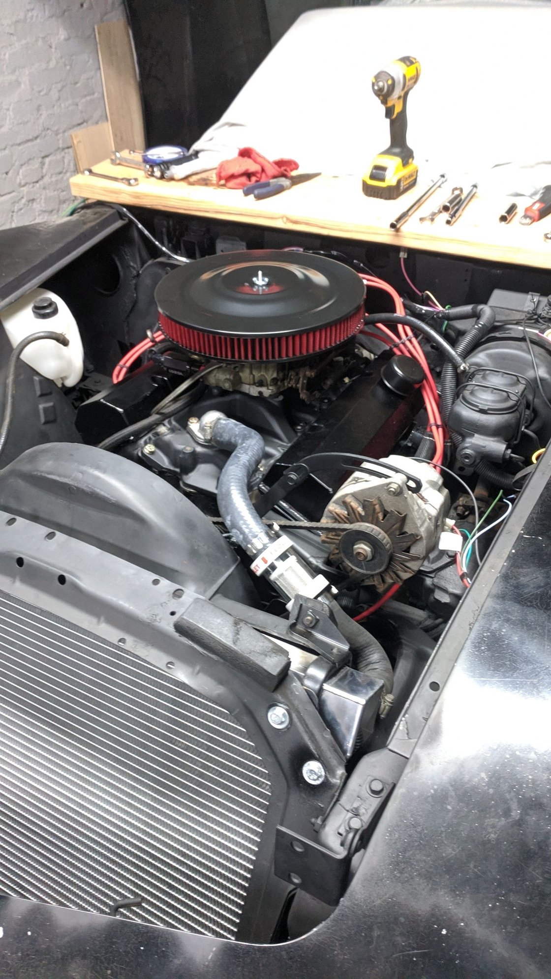

This car has always had an extremely ugly engine bay. The prior owner didn't have good taste I suppose. It had an aftermarket engine so I never felt too concerned with replacing components. I have a list of about 150 items that I did/changed but I won't copy that whole list. The big ones are:
- new fuel sender and pump
- new intake
- new radiator (old one completely rusted out)
- new head gasket
- new radiator
- new exhaust ( yet to be fully hooked up because I changed my mind on what I wanted last month)
- new valve covers
- ALL new wires and hoses everywhere (seriously not a single old wire or hose in this compartment)
- new fluids and filters
- new Borgerson steering system
- and ya know some other stuff
I haven't yet taken a picture of it today but once I get the exhaust plumbed up its ready to start for real. I drove it around the block with the old exhaust a couple weeks ago which is the first time is moved more than 10 feet since 2009. So it was pretty exciting. Though I didnt hear some nasty clunking from the rear....so that will likely be next on the list. That in addition to swapping this ole girl over to a manual....gotta have a stick. More to come.
