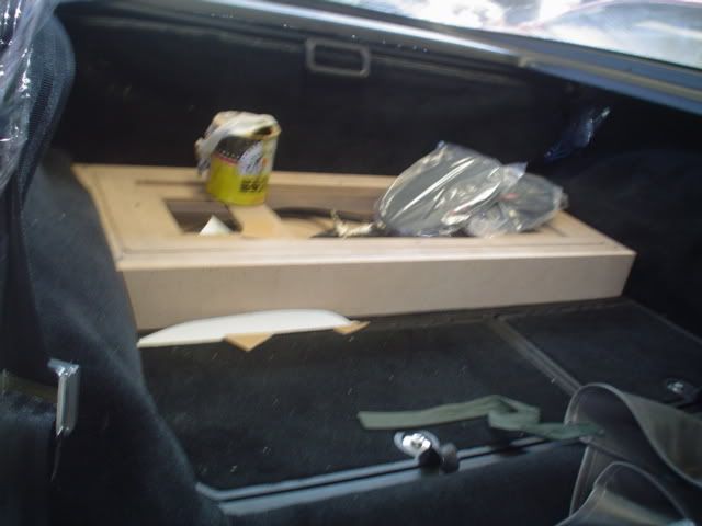

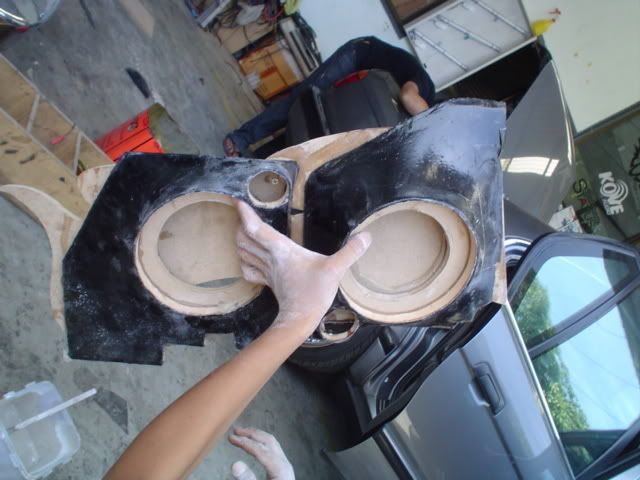

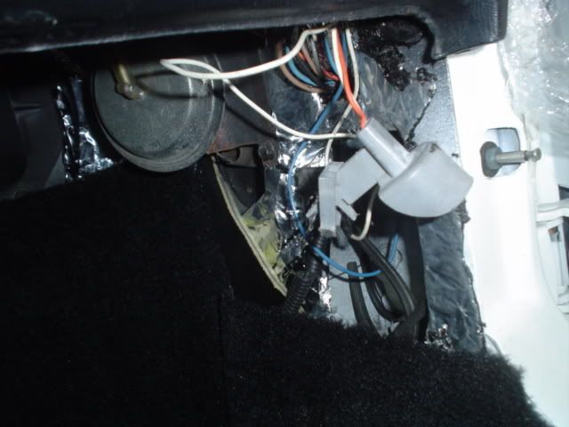

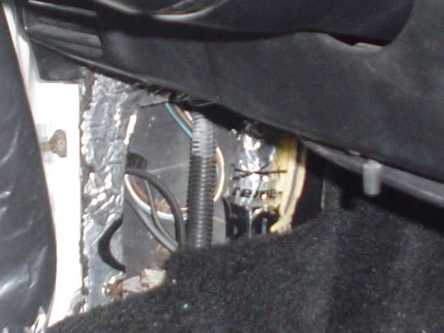

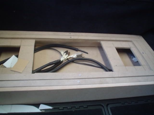

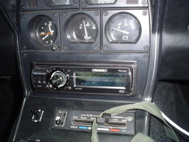

I started my custom install yesterday, my 6X9s are too large also and we are making an enclore that will fit over the original 6X9 spots. Here are some pics from my install. I should be through tomorrow.
Here's the custom enclosure in the rear that will house the amp and crossovers.
Pulled the kick panels and used as templates to build the new ones to house the component speakers. It sure is nice to change your interior in conjuction with a stereo install, we prerouted all the wiring prior to installing the new carpet.
New kick panels about to be plastic coated in black.
New pioneer head unit in place
To speakers
