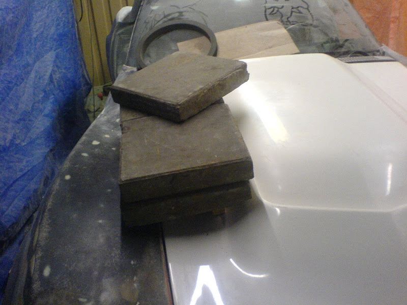

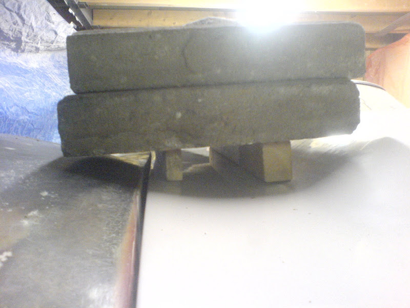

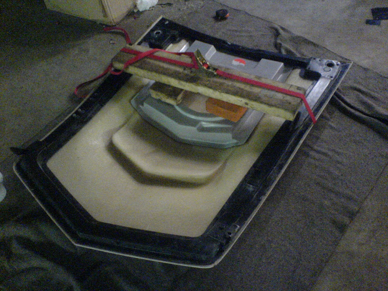

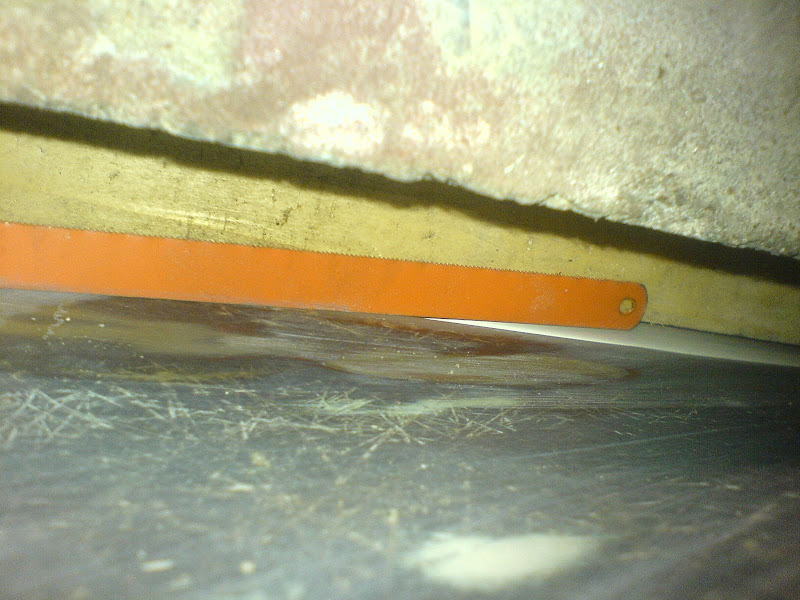

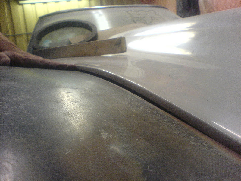

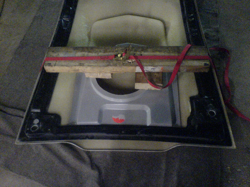

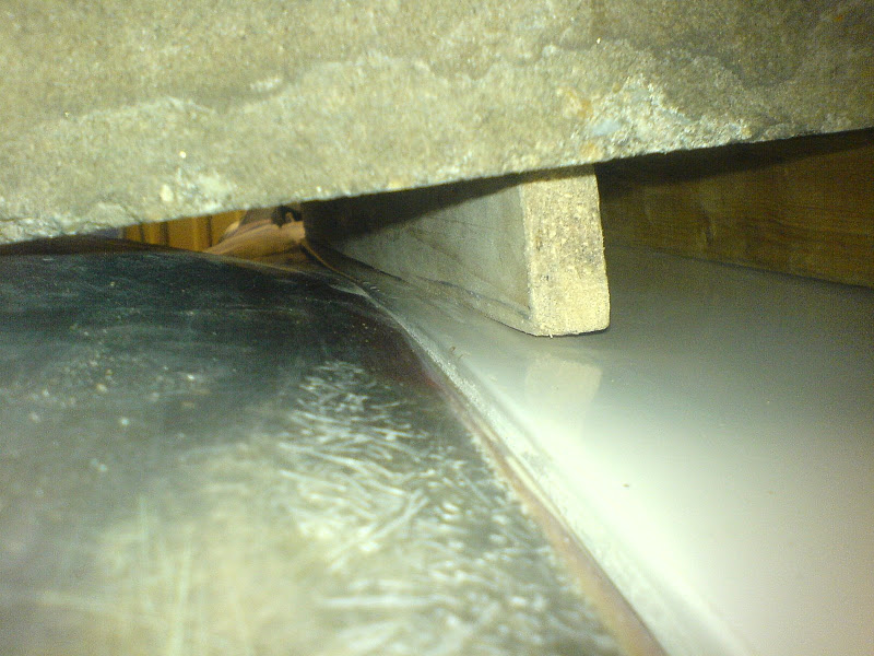

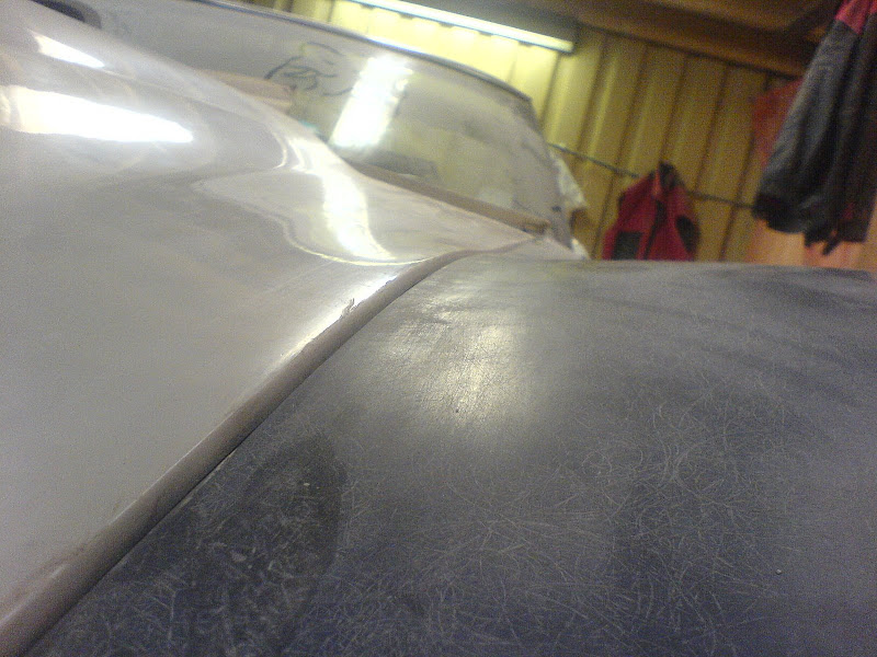

Old Jul 21, 2007 | 05:14 PM
cajos's Avatar
cajos
Posts: 893
Likes: 7
From: Hazerswoude-Rijndijk Zuid Holland
Default Hood that doesn't match
I noticed this before and finally found a way to deal with it.
The problem!
Both front and back are fitting well and are spot on. It is just the bent profile that has too much curve.
Other side, is ok.
The solution (hopefully):
I heated this side of the hood with a head gun, around 60-80 Deg Celsius. The glue used for bonding the frame (inside) will get a little soft. Apply some load, and pray it works.
The load is about 5 times 8 kilo, rather significant.
Looks spot on with the load!
Just checking!
Next Tuesday I will be in the workshop again. I wil let youknow the result.

Old Sep 12, 2007 | 11:47 PM
DZRick's Avatar
DZRick
Joined: Jun 2005
Posts: 5,447
From: Syracuse NY
Cajos,
2 questions for you,
1) What is he diameter of that air cleaner base?
2) how did your hood fit trick work out?
I may have more air cleaner questions for you later on too.
Rick
Old Sep 13, 2007 | 03:50 AM
cajos's Avatar
cajos
Posts: 893
Likes: 7
Hi,
1 I don't know, I have to measure it when I'm in my workshop this weekend. My best guess is 13" slightly smaller than the Mopar cleaner. ZIP sells a kit! Incomplete but a good start.
2 Reasonable, it is down to 5mm from 15mm. I will have a 3dr go this weekend to see If I can close the gap completely. I will use more heat on the "welds" on the support beam (does that make sense?)
Keep'm coming
