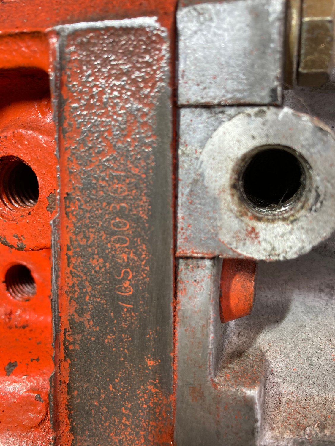

I am the current owner of the car in question from this 2007 post . I've attached photos of the original engine VIN and engine code stamps. I had never heard of the alternate stamp location next to the oil filter until purchasing this car . First day of 70 Corvette production was January 5th , build code for my car VIN 4000307 is A06 - January 6th , second day of production.
It is estimated that this location was only used for a week . This was first done on 69 Camaros because the new location for the alternator was blocking access to the machined pad on front of the head. My assumption is that this practice was abandoned because of the cast iron surface making it hard or impossible to get a readable stamp .
Fortunately , mine is easy to read on both the engine and transmission .
