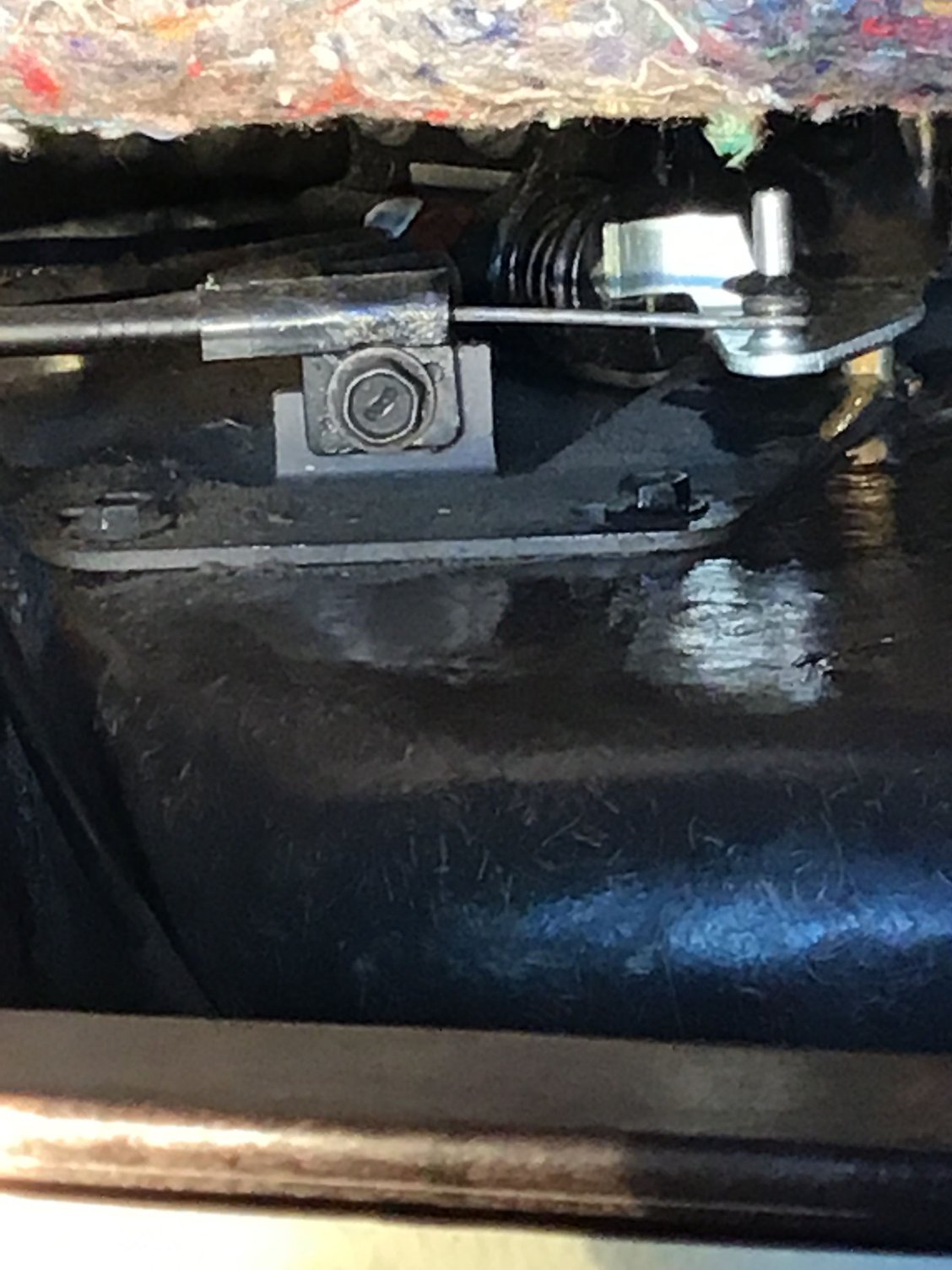

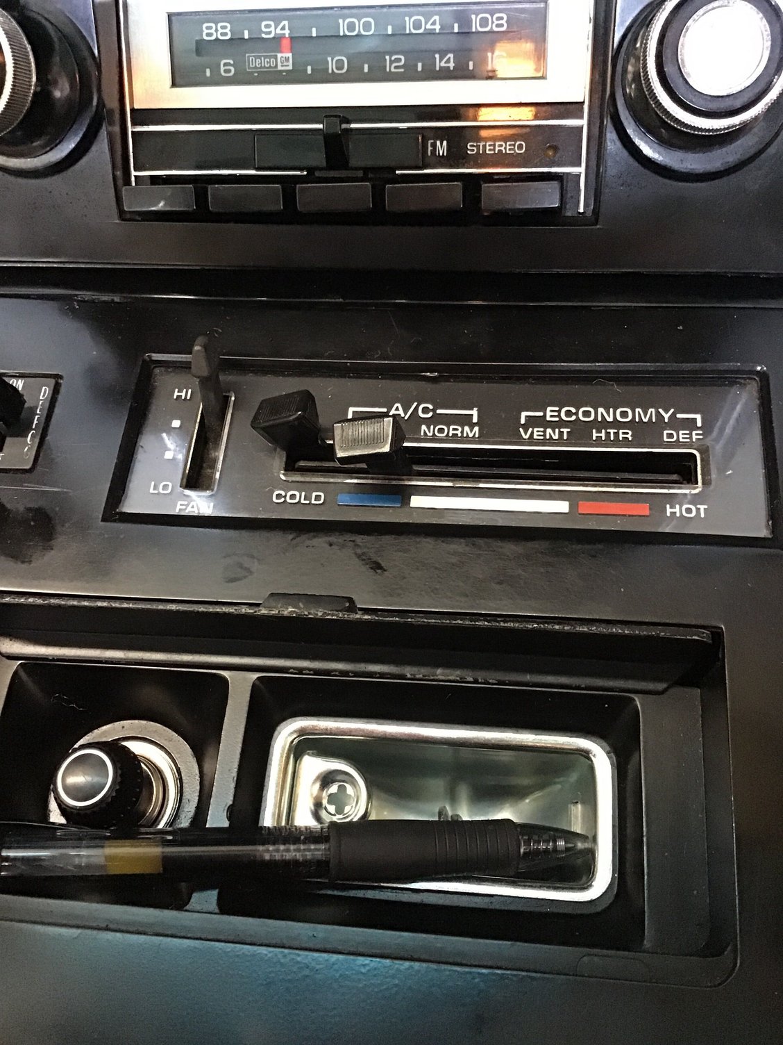

Ill switch to why im only getting air on floor. Read all the posts and a few conclusions mainly vacuum leak etc..
im bot so lucky but did manage to see my remp cable adjust was not moving to full cold, and not hitting switch which according to manual triggers the water to stop flowing through heater core...that would be helpful!
moved very hard too..slathered silicone paste and constantly with lever in one hand and door lever in other got it back and forth smoother..still tight.
that .01 to .02 adjustment on temp lever is a non starter for me i need to adjust like an inch so it will fully close and trigger switch..maybe only downside is less heat but i want that water off while i stockpile r12 and pit on new compressor..it runs but about to implode...that dryer looks impossible to remove..
Behind glove box
I need to keep this hap or there is not enough for e to close door and thus switch

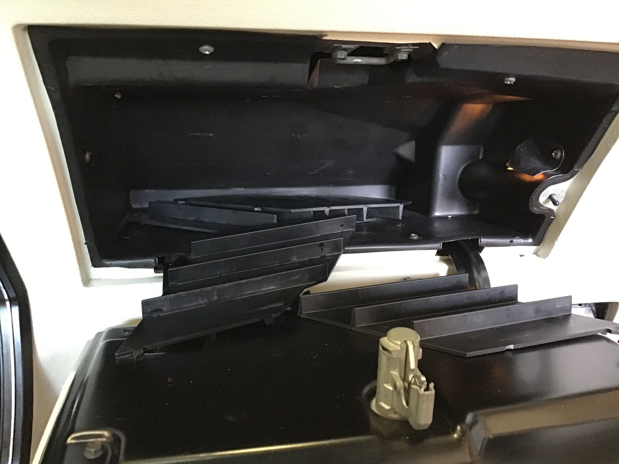

I can actually use my glove box now that the 8 track dividers are removed..what a time capsule
