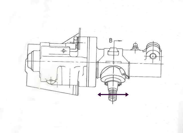

With the engine off, there will be some motion of the control valve stud when the steering wheel is rocked. Starting the engine should greatly reduce noticeable motion of the stud into the valve. No "major" reduction movement - maybe we're not looking at the right movement. All we saw was side-to-side movement. Can you elaborate further?

The motion of the stud causes a spool valve to shift to the right or left and provide oil flow for the appropriate right or left turn.
The motion should be side to side. I can't give you and actual distance that the stud should move.
