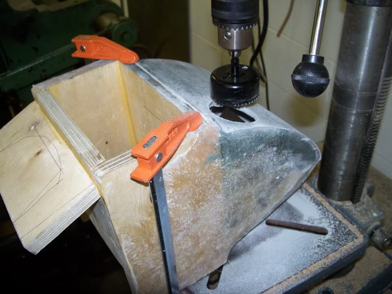

I laid up some fiberglass chopmat and sanded that down, then filled in the low spots with duraglass and then gave it another sanding, it is really flat and fairly smooth for now so I moved on. I cut the back of the console open and laid out some guidelines for the gauges on the front side. I picked up a 2.25" hole saw bit and drilled holes for the gauges on the drill press. The holes are 2.25" but I will need ~2.375" for the pvc to fit into, but this is what I want it to look like when I get finished.

Added some chopmat to the back where it seperated from the wood, and drilled the rest of the holes. I still need to do a little sanding on the holes so they are all in line and equally spaced, but it is close. Ordered some 2.25" o.d. aluminum tubing today, I will be using that in place of the pvc, due to bonding issues with the pvc.
