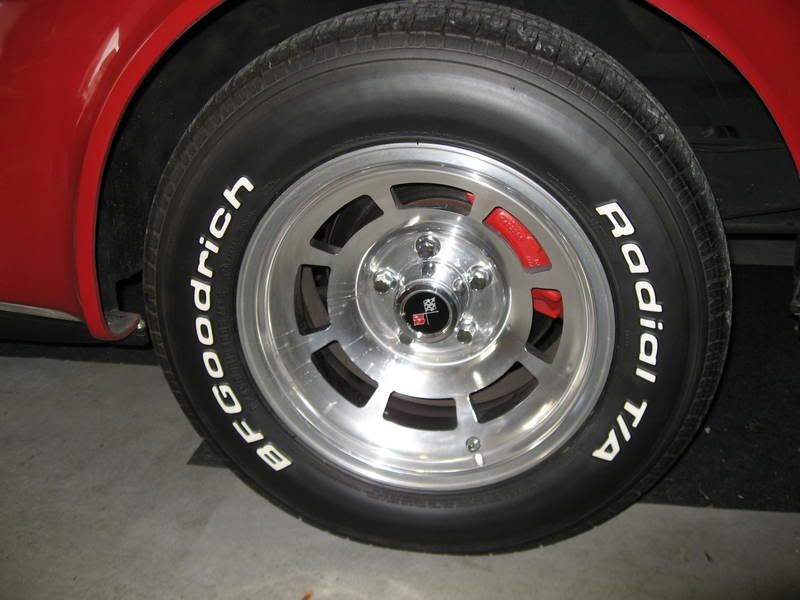

On 1978's the only ones that came polished were the Pace Cars and they had a small red stripe around the bead of the rim, so they're pretty easy to identify.
I bought a left over '77 in 1978 and it came with the aluminum wheels. They were not polished, nor did they have clear coat on them, so they were rather dull even when new. After looking at them like that for a while I decided to give my Dremel a try using Simichrome polish. It's available online or at most good motorcycle shops.
It did a pretty good job and they looked at least 100% better when finished. I now use an air powered die grinder to do this job, and it's a lot easier. The results are the same, they look terrific.
I do not use clear coat on them and the shine is excellent and I just do a quick polish once or twice a year and they look as good as when I finished them.
Good luck... GUSTO
