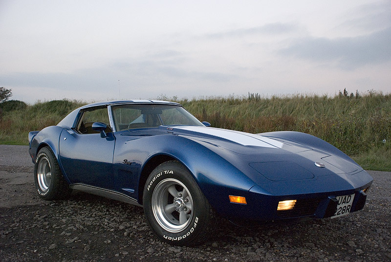

I believe I've got Ds on my '76. The spokes do run close to the calipers (just a couple of mm clearance) but they do work. 8" wide, 4" backspacing, I think.
This photo doesn't make the rear window obvious so perhaps it's useful.
Besides, I love the photo.

thats perfect I ment pretty much any Vette from 1968 - 1982 so I could see what they looked like on that shape of vette so the back window is not that big a deal. I wish my vette had that back end cuz I like it better
