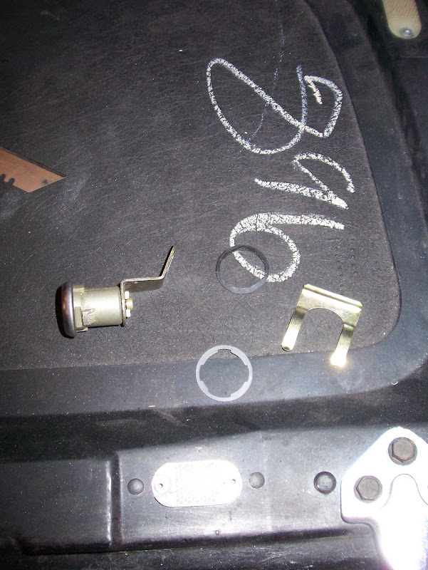

With the new lock kit there was a nylon washer where does this go, it's not in the AIM?

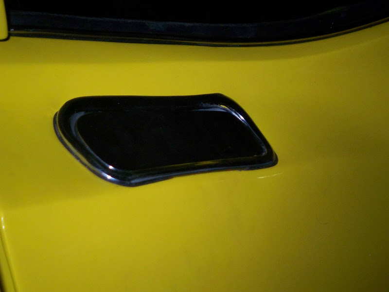

The door handle rubber seal is visible, do I cut it to match?

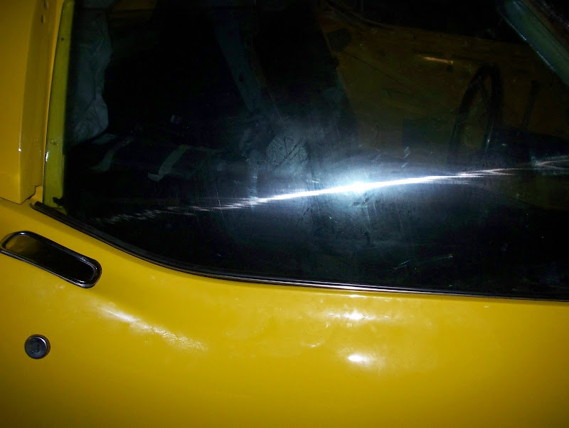

The outer window seal is not tight on the door skin, any tips?

The Nylon washer would probably go under the lock lip on the body side...to help seal out moisture. The seal under the handle cradle can be trimmed if you like...bit it is there to also seal out the water.
Not sure about the outer trim. The door panel I had...they were screwed in and could be tightened.

I'm a little confused. The outer seal snaps and screws into the door. AIM shows the installation. You may have to lower the window stops to get the door glass down and out of the way to get to the seal.

The outer door seal is snapped in!! It's just does not flow with the door line. Can I bent it in to shape or will it snap?
I can see the rubber gasket but not the nylon washer. So what is the order Lock/Nylon/rubber?

I don't think there was a rubber gasket orignally, just the nylon one. If you want to use both I'd think the rubber gasket would go against the door surface.

You have to play with the outer door handle seal a bit to get it to align around the handle. If the nylon washer makes getting the clip in a bit difficult, compress the clip a bit in a vise to take some of the pressure off. As for the wetherstrip/belt molding, you may need to shape it a bit to fit the contour of the door. I did mine with a wooden dowel that I rolled along the top of the moulding using hand pressure. You want it to fit snug against the top surface of the door. Don't rush any of these, just take your time and they will turn out O.K.
