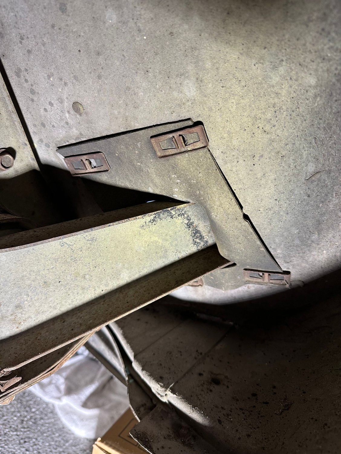

Old Mar 23, 2026 | 07:15 PM
Tuna Joe's Avatar
Tuna Joe
Joined: Sep 2016
Posts: 1,492
Likes: 524
From: Ventura California

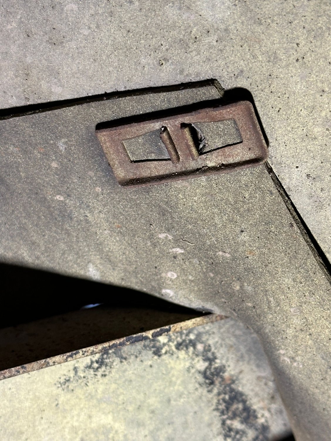

Old Mar 23, 2026 | 07:18 PM
Tuna Joe's Avatar
Tuna Joe
Joined: Sep 2016
Posts: 1,492
Likes: 524
Looking for any input on how these are removed and re installed.

Isn't it great that your '68 has one-off parts that other later C3 cars don't use...
As Alan said, on later years, like my '71, wire staples were used to attach such pieces.
I saw elsewhere in the forum that they might have been called Robbins Clips and were also used as C1 radiator support seal clips. I found them on this Dutch site:
https://www.corvetteparts.nl/product...l-clip-set-62/
Good luck - hope this helps
