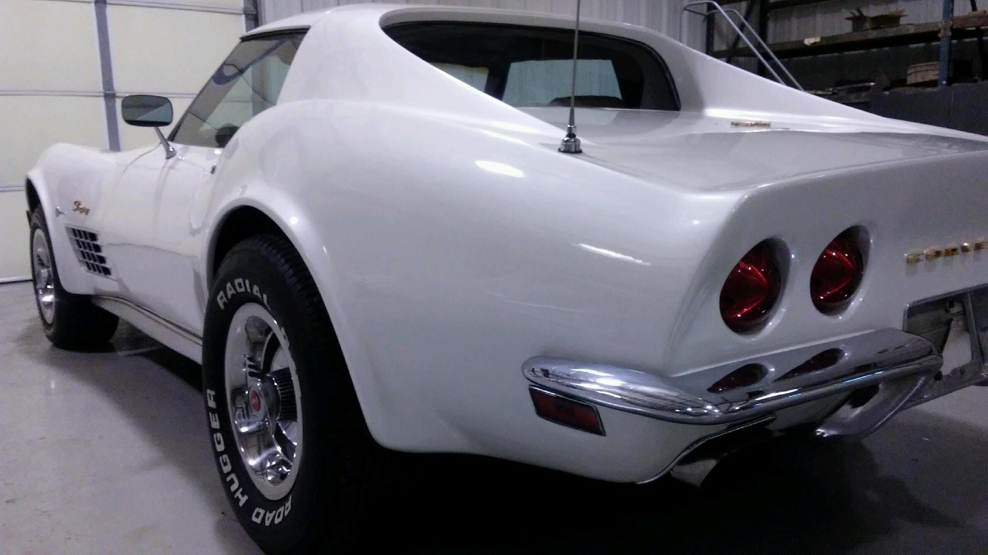

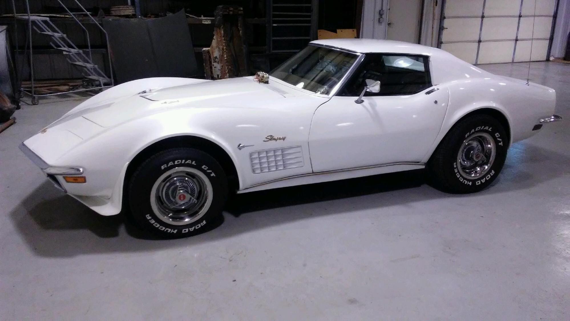

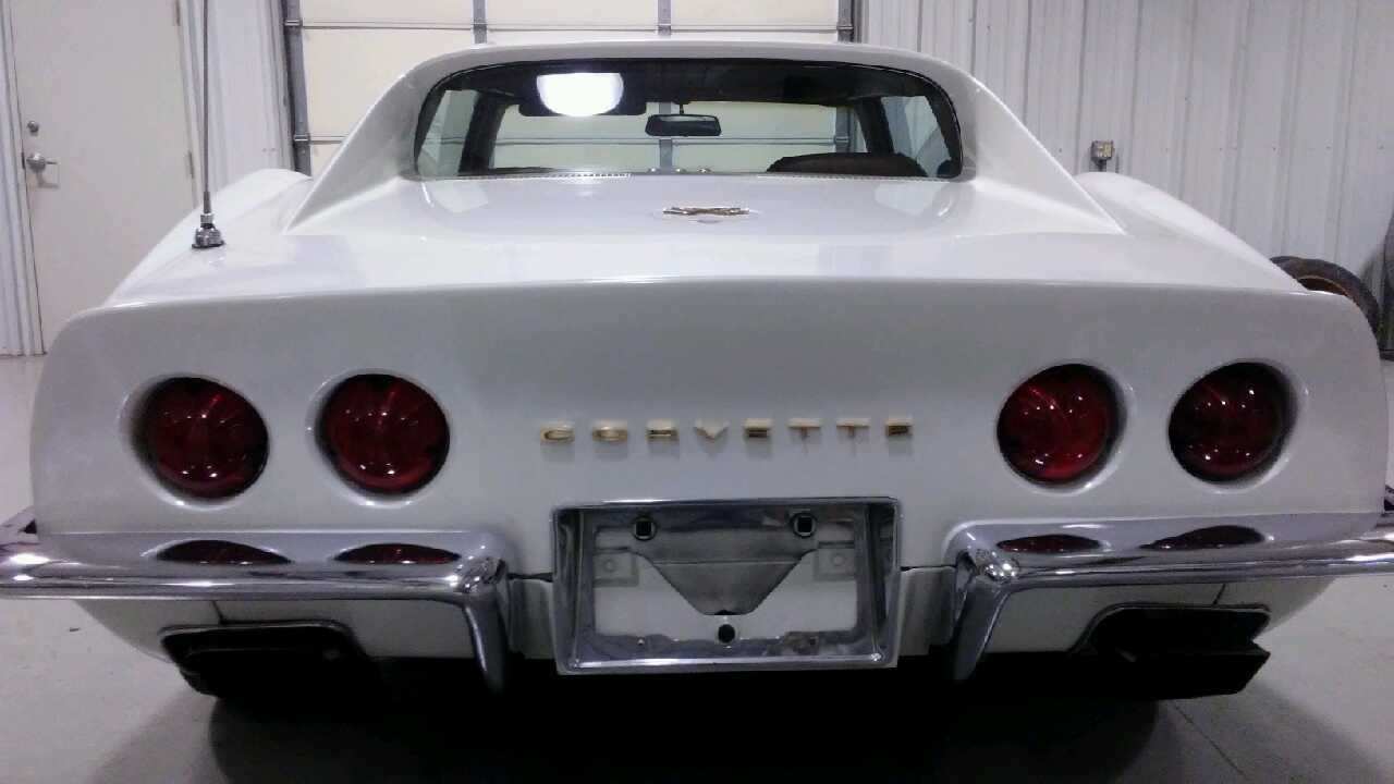

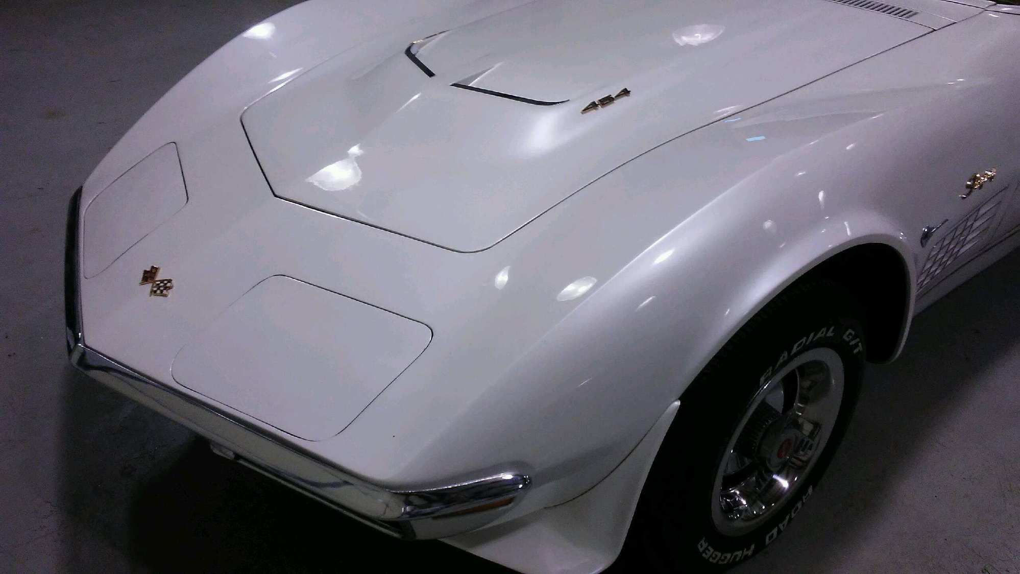

Default 70, 71 or 72
Looking at this car can anyone tell me what year it is.
Old Jan 31, 2019 | 11:57 PM
  #44
Carl Granquist's Avatar
Carl Granquist
Posts: 624
Likes: 24
From: Shoreline WA
My guess is a 1971. You realize this is a 10-year-old thread? No comments for a decade. Anyway, the fender badge shouldn't be there, no gauges on the wiper door, and inboard backup lens missing. Front air dam? May or may not be a big block. Still, it's a beautiful car! Wish mine looked that clean.

Front Grill
70 studs for mounting , hole in turn signal case for fiber optic - Amber lenses
71 screws for mounting , hole in turn signal case for fiber optic - amber lenses]
72 screws for mounting , no hole in turn signal case for fiber - no fiber optic - clear lenses. amber bulb,
