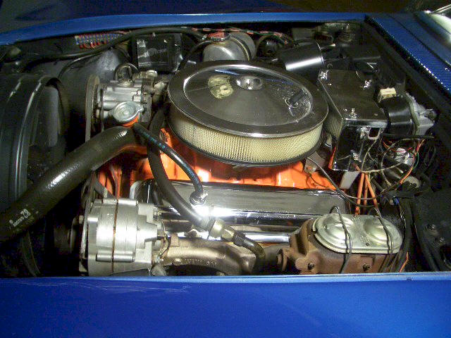

I think I would run from this one. Suppose to be a 68 350hp

Also what is all that crap under the fender??

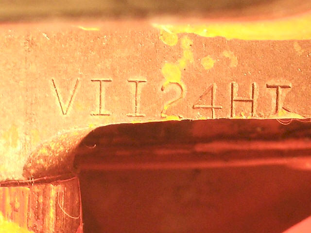

The top one looks like it's been stamped over?
Part of a number in between the two 6s?
I've never seen VI on a sb. V1 I've seen bunches of.

V1124HT is what I'd expect to see for a '68 327/350 (L79).
Not sure why the I's, but the serial number has been altered. I assume they just removed the last 5 #'s and restamped.

Just noticed oil filler tube and pvc is wrong.

Broach marks look OK - partial VIN stamp look OK - Build stamp looks OK.
The partial VIN stamp shows a "bounce". Pretty common ...
I(eye) and 1(one) were interchangeable stamps for the build date applications. This block was stamped the day after Thanksgiving, 1967. There were probably 3-4 blocks being stamped at the same time, and the numeral "1" was used elsewhere. The serial number is the last day of November, so the timing is OK.
If the block casting number is 3914678 and the casting date around the middle of November (K157??), then it looks feasible to me.
is D30 on the trim tag??
But wouldn't all the digits have "bounced" together and created a ghost image, not just whatever is in between the 6s?

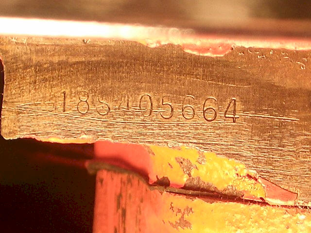

Pretty ugly side to side gouges. Why only where they are?
I'm O.K. with the use of I for 1.
What's going on at the bottom of the 2 and the T?
It seems like the broach marks are so clear on the the rear of the serial number side, what happened to them on the source/broadcast code side? Is it just the picture? I like the pad surface to look 'uniform', what ever that means.
I'd sure like to see even a hint of broach marks on the source/broadcast side of the pad.
Does someone risk the 'pad doubt' to change a car from 300 hp to 350hp?

Although somebody gouged the pad and did some damage, the stamps look right to me. The double bounce by the "6" looks fine. I think you see this when one of the stamps is a couple thousands deeper/taller than the next, and when the strike is made, the gang stamp holder bounces under the hammer and leaves a slight impression from the "highest" stamp.
Regardless, based on the overall look of the car I don't think anyone would spend the time to try to fake a SB '68 and leave all the mods under the hood.

Seems like the bottom of the 2 and T are compromised by the strike being so close to the bottom of the pad.
While the bounce would seem acceptable, the fact the broach marks are so clear, but the gouges are so pronounced makes me have to look at the VIN a second time. It just makes you wonder if there was a lot more "attention" paid to that side.
Still, the stamps seem OK.

And what's that tube coming out of the top of the air cleaner lid? for extra fresh air?!

I've seen factory grind-outs that look very similar to this.

I'm fine with the assembly stamp. On the VIN derivative, shouldn't the first number be a "7", it looks an awful lot like a "1".
looks to be scratched off pretty well and that DOES look like part of the old vin. pretty straight stamp though for just a BUBBA to do

Why would there be a chip in the block below the last 4 and to the right of the yellow stuff? The chip looks like some plastic steel broke off.

Originally Posted by PKguitar
...On the VIN derivative, shouldn't the first number be a "7", it looks an awful lot like a "1".
Nope. 1 is correct. It's the code for Chevrolet.
Roger
good call! looks like an overlay of AMLUMALLOY or something was put there like a bondo
