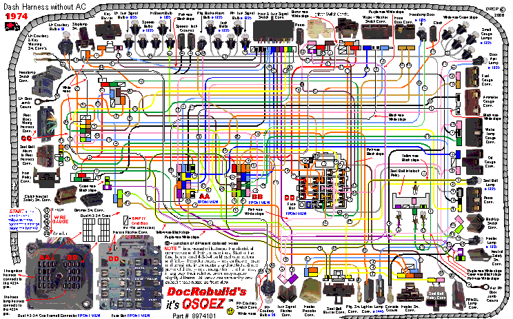

nomomopars...These 74 systems with the seat belt interlock are a real pain to diagnose if your not used to the way the system works but in your case with the wiring being altered from factory it might be best to temporarily bypass the seatbelt interlock system to get you back on the road.You can always reattach the interlock later if you want the system to work like it was intended.
Do yourself a big favor and buy a wiring diagram set from Doc Rebuild for your 74 it will make your life much easier while working on the wiring.These diagrams are like none other,seriously I'm considering framing mine and hanging them on my wall.

I grabbed this off the Doc Rebuild site. Hope it helps.
