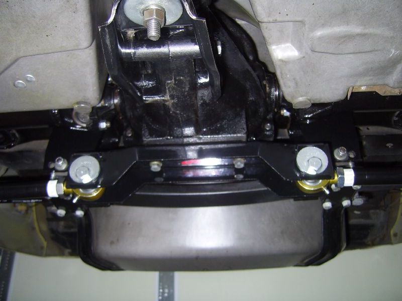

I hope this is the rear end you are talking about, and not the one I am sitting on.

What are those metal pieces that are going around the ends of your half shafts, and what is their purpose?

Those are safety loops to protect the bottom of the car and everything around that area should a u-joint let go. They are available from Dragvette Products. They are highly recommended and very cheap insurance.

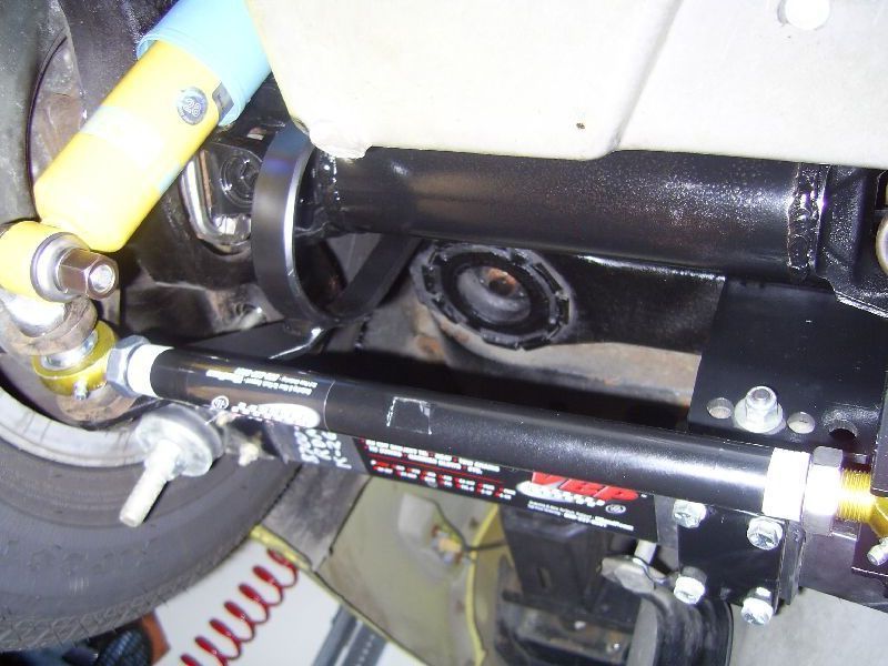

Half shaft loops as described above. I also have a 6 link on the rear. You can't see the upper link in this picture but it does away with using the half shaft as a stressed member of the suspension. I run no Snap rings on my stub axles. They will slide out easily when the half shaft is removed.
Here you can see it in this picture.

Is that a standard length dual mount spring or a shortened one?

That one is 1 inch shorter on both sides. I have since replaced it with a spring that is 1/2 inch shorter on both sides. The bolt angle is not so severe now. Even the upper picture is with the real narrow spring. It was the wrong spring rate and to short. I exchanged it for a stiffer one and a longer one.

I have a dual mount to install but that bolt angle looked strange. What size rims/tires are you running? Looks like 17' or 18" with 5 1/2 bs?

18X10 with a 5.5 back space and a 275 40 18 tire
