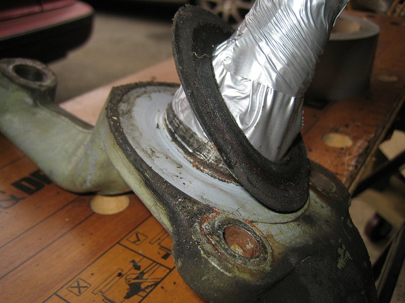

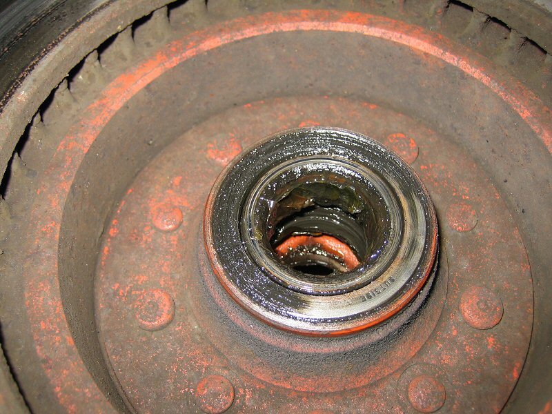

I did this, and if I can do it then anybody can.

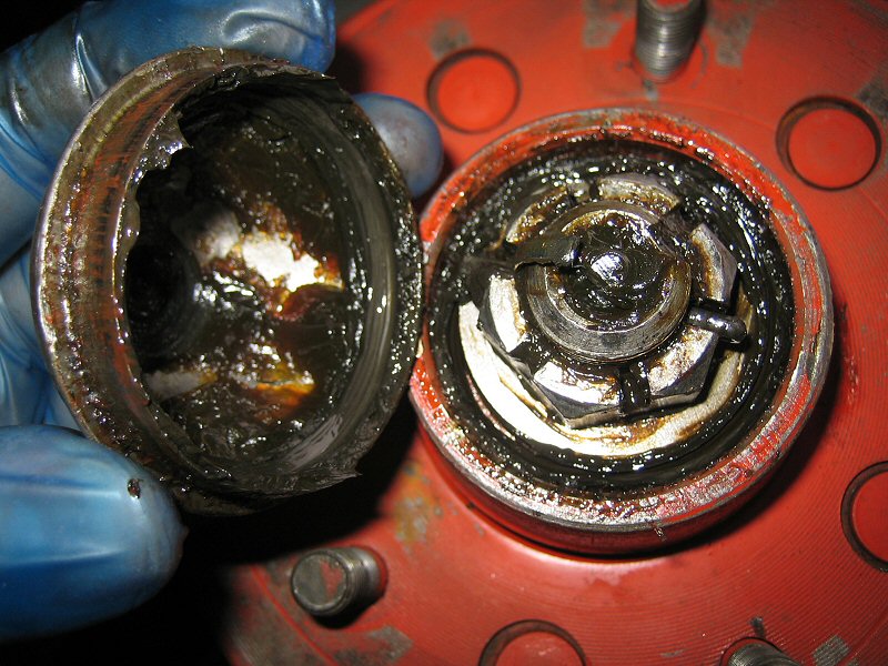

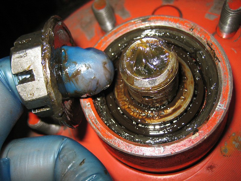

Remove cap from rotor and castle nut + tabbed washer from spindle:
Rotor slides off spindle:

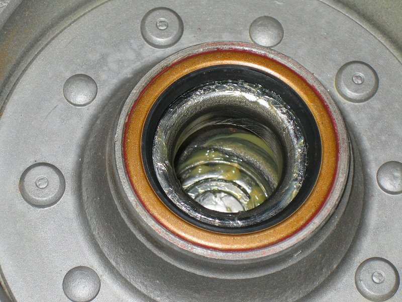

At the rear of rotor you can see inner bearing retained by the seal:

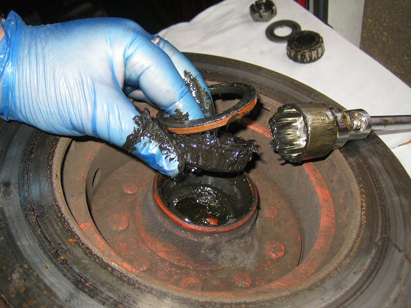

Push the bearing through from the other side with a large socket, forcing the seal out of the rotor. This will probably damage the seal:

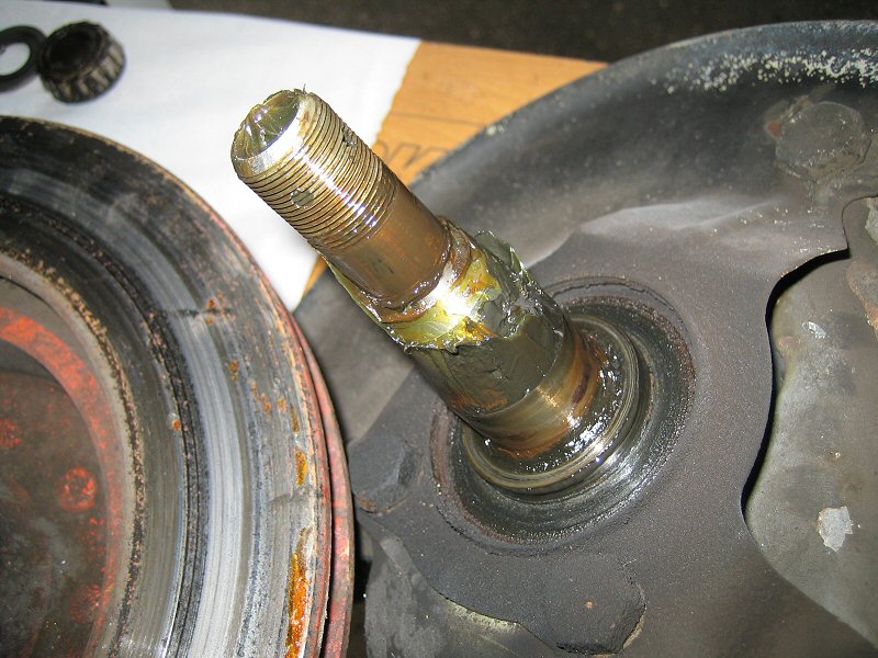

Watch out for the card dust seal on the back of the spindle:
The two outer races are pressed into the rotor but there are clear places in the casting where you can locate a drift to tap them out. I didn't do this bit because mine were in good enough condition to re-use, but it didn't look as though you'd need special tools provided you're careful.

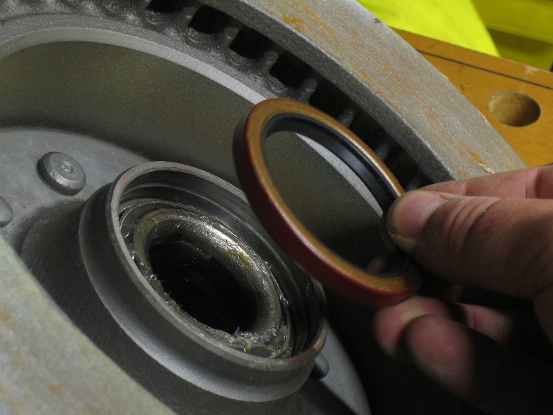

The new seals just press in with a (clean) block of wood or something to spread the load so they slide in evenly:
Job done.
