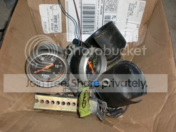

Old pilots information center:
New pilots information center:

Wow everything is looking great. Are you going to loom the wiring in a sheath of some kind or leave it wire tied?
I like the breakers in the firewall. My area was unused too so I installed mechanical gauges to monitor the engine when not in the cabin. I've changed a few things since the picture was taken but you get the point. Oil pressure and temp gauge, mechanical, with a hood switch controlling the gauge lights which are only on with the IGN.

Hey I like that idea of the gauges. And how clever with the wiring! I should have thought of that but as we all know, real estate is precious here. A lot of the big yachts have them mounted in the engine room like that though so you can monitor things while tinkering down there.

Yeah the gauges have mechanical senders. The temp gauge gets it's reading from the passenger head and the oil pressure gauge goes to the port next to the distributor.
