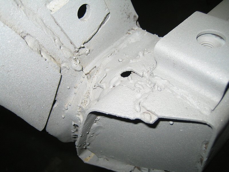

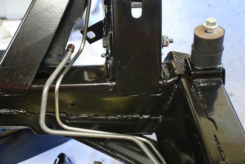

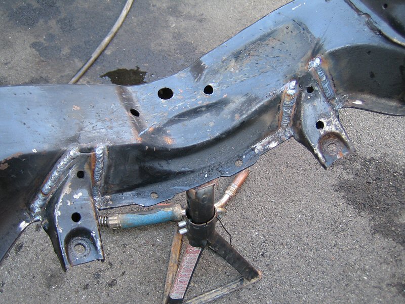

Poor welding at the kick-ups on my '76 chassis:
Before I blasted and painted the chassis during my body-off resto, I noticed some cracks in the A-arm attachment bracket welds:
I had them repaired. The welds are good and strong, but they just look wrong on a restored old chassis.
Imperfections like the original welds are part of the character of the car IMHO. I'm happy to keep them ugly.
YMMV

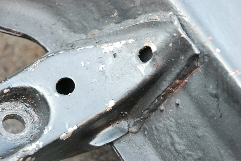

I'm working on my replacement frame right now, here's my contribution: It's from a 81 Corvette, the welds and splatter are pretty rough.
I also noticed my frame has been hit in a previous life and seen this repair, should I grind out that strip of metal and weld something a little more flush? There is also a long messy weld to the left of the strip that wraps underneath....I'm going to grind that down for sure.
I measured out the frame and it's square so I'm ok on that.
Lastly, I noticed my PS pump pulley comes real close to the frame, you actually have to loosen the PS pump mount to change the belt, should I do something in that area to make changing a belt a little more easier?
