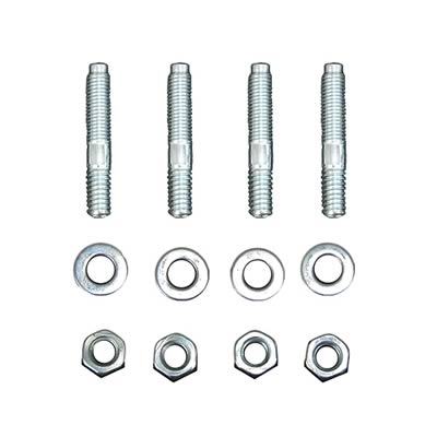

Get some ARP stainless studs and never have to be concerned about oxidization/rust....and they look good
Picture for reference only......select the correct length to suit your needs..
