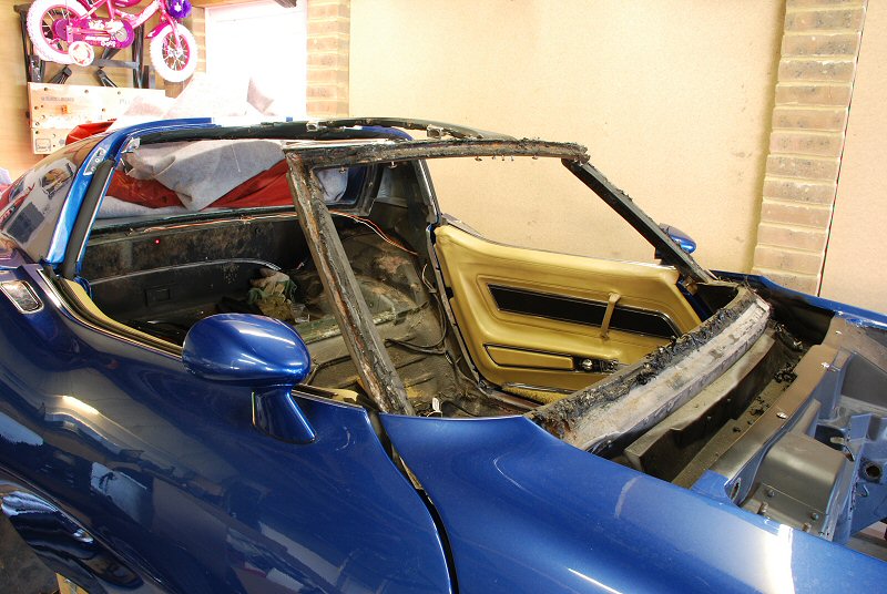

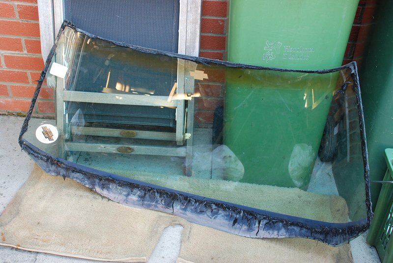

I got the windshield out of my '76 at the weekend by cutting around the perimeter with a serrated knife. It was hard work but the glass didn't break.
Few more pics here:
http://www.corvetteclub.org.uk/viewt...5429&start=470
I just searched for info about the trim clips and found this thread. Haven't got the answer I need yet
