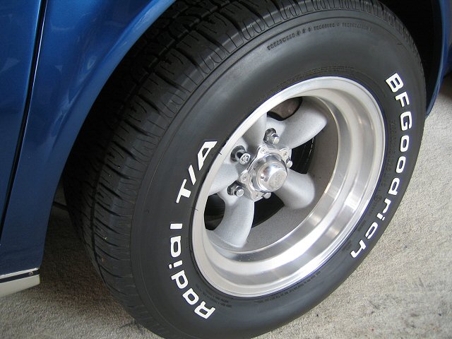

Many people get confused between the original TT and the TT "D". The original "D"s were made specifically for Vettes with disc brakes and were used extensively on the early Vette race cars. However they did have a different appearance than the modern "D"s. Here's some pics.
As I wrote earlier, supposedly when AR first restarted production of the "D"s in the late '80s they wouldn't fit however that has not been documented as far as I know.

I would appreciate it if anybody that has TT Ds on their Vette and needed spacers or adapters would post some close-up pics similiar to the ones I posted showing the configuration of the spokes and its relationship to the calipers. Several of us have recently installed TT Ds and haven't had an issue. I would like to see what has changed. It might be valuable information for anybody buying used Ds.
By the way, here is a pic of the car that finally inspired me to go with this wheel/spinner combo. This belongs to somebody in the C1/C2 section. I can't remeber who and I hope they don't mind me posting it. Truely beautiful in my opinion.

I would still like to see some pics of some "D"s that interfere with the calipers on a Vette. Several on this forum have recently installed "D"s with no interference problems so I think we can state conclusively that the "D"s currently available are made to fit C2/C3 Vettes.
