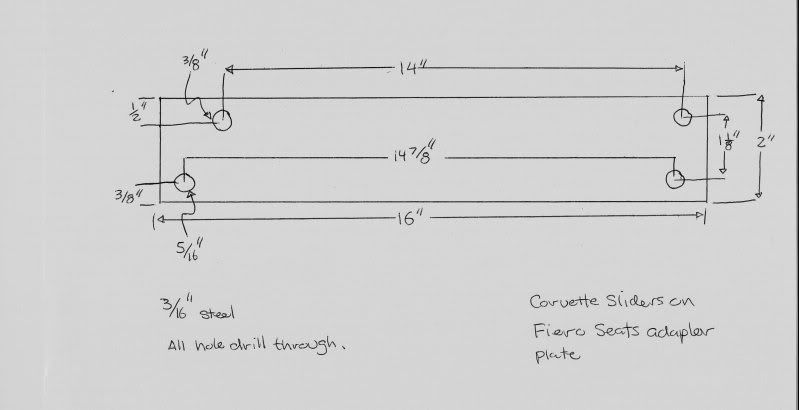

The late 90's model Camaro rear seat belts are what you want. They are dark grey from the camaro but I think they can be had in black from the same years of Firebirds. I just changed out my webbing to black. ( I used to have an Upholstery business)
I did major re-work on the Fiero tracks to make them fit, but there is a much easier solution posted here using some flat steel and includes the measurements for the holes. If you do a search you should find it.
Old Dec 30, 2009 | 03:05 AM
RunningMan373's Avatar
RunningMan373
Joined: May 2007
Posts: 3,246
From: Bay Area CA
Adapted from Binnie77's original design.
