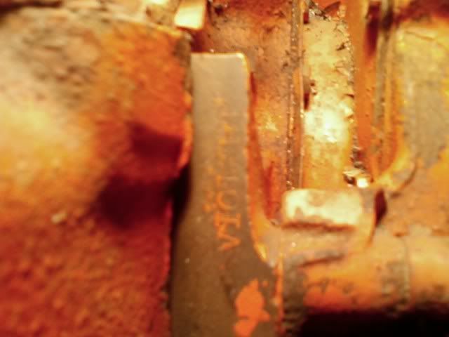

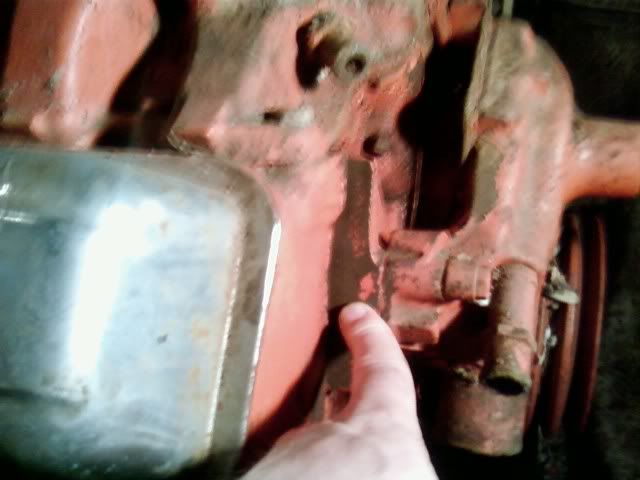

Here are a couple of pictures showing the code and it's location. I went out to my garage and took them aftewr reading this post. Hope they help. This is my 1968 project and the code show HT
[IMG][/IMG]
[IMG][/IMG]
Sorry for quality, I used my cell.

Very helpful and many thanks
