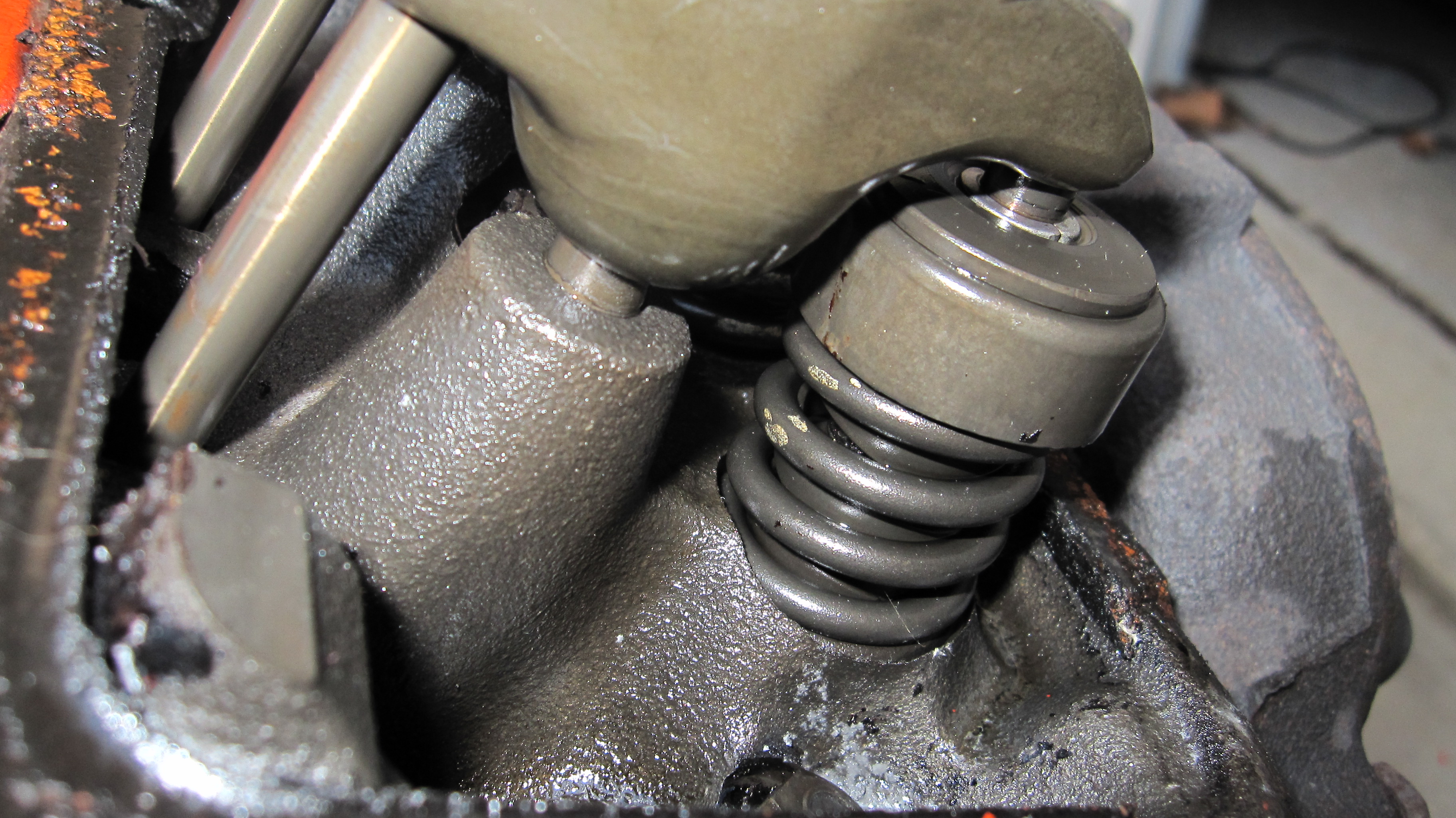

I started with replacing a bad water pump; next thing you know, the heads are off. Has that ever happened to you?
The car has 35,000 miles and has sat a lot. I have owned it about 8 years and only put about 3,000 miles on it.
When I pulled off the valve covers, intake manifold and timing cover, I noticed this sort of baked on oil sludge.
The crankshaft though, looks good with an clean, oily glow.
The end goal here is to replace the camshaft, clean and paint up the heads. I don't have much engine building experience. Should I worry about the grime on the block, or just let it be? Also, what about the pistons, should i clean those up? If so, any best way to do it without getting contaminates in the engine? Should i rotate the engine to TDC on each piston that I am cleaning?

The lower end looks pretty clean. The heads look like they have been 'cooked'...a few times. Is that a problem? Well, if it runs OK, not at the moment; but wait a while and things will begin to happen.
Since the heads are off, it would be best to have them reworked: cleaned, valve seats ground, new valves, valve seals, springs. Or, you can just put them back on and hope for the best...

Looks like a motor that has had a lot of short trips and has had very few long runs. It gunks up like that because it never gets all the moisture and combustables cooked out of the oil that acumulate when it sits

It wouldn't be the first time that "one thing has lead to another". I'm pulling the heads apart today to take a closer look and start to clean them up.
What about the block? Is that cleanable and should I try or leave it alone?

James did you keep your push rods in the order you took them off?
If you start cleaning that intake area,bad dirt & stuff will get all over I wolud clean lightly dont look for shiny.
Replace your lifters .Cam And timing chain. seals are A gimmie.
Feel the inside edge and all the way down to the piston any bad edges at the top and any scratching in the bores ????(run the pistons up and down to do this on each bore).
Any edge or scratching and well,,, sit down That whole engine will need going through .I cant tell you the guys that do it half azzed and two weeks after the motor s back in the car he s got A bad Vibration.Do not let this happen to your re-build Get someone who knows A little more that you an see what they think.
Hows the rest of the car ?

Well, with the heads off, you can't make the check you really need...a compression leak-down test to check the piston ring integrity. You could make up a flat plate (about 1/2" thick steel) to seal off the top of the pistons (one at a time) to do that test. There's no other way to check the rings {that I know of, anyway}, and that is an important test if you want to leave the bottom end alone.
A [very] rough 'gauge' of lower end wear is the amount of ridge/lip at the top of the cylinders. In 30K miles, you shouldn't measure much more than .003-.005"...if the oil has been changed frequently. If you see more than .010" ridge/lip, you might want to consider a full rebuild, as the cylinders coudl stand to be rounded up again.

I know this will raise a few eyebrows, but if you're on a budget, and a total rebuild isn't a viable option at this point, you could buy a can of "engine flush", and a stiff parts cleaning brush, and attack the lifter valley, to get the heavy junk out....assuming the oil pan is off, and you have a drip pan to catch the crud that washes down.

The car's mileage is pretty well tracked through the service records (I'm the third owner). Plus, as I've gone through it, you can still see the original parts, like riveted ball joints and rotors.
The cross hatch pattern looks pretty good and I'll measure the ridge once I get my hands on a dial indicator to see if there are any issues with the cylinder wear. I feel pretty good that the rings are ok; the car ran well before I pulled it apart. It did burn some oil, but that was likely because of the leaking valve seals and valve cover gasket.
My plan is to clean up the heads, valves and block the best I can and reassemble. I don't have an engine lift to pull the block out, so I'll have be careful as I prep the block in the car for new gaskets. Long term goal is to continue to enjoy the car, but hopefully drive about 2k to 3k more miles a year instead of the 500 that i've been averaging.
So, next question.
Do I go with another metal shim (0.018) or change composite head gasket (0.028)? The car originally had a metal shim, and with already low compression ratio (1975 L48) I am reluctant to install a thicker composite gasket, but would appreciate any feedback.

Apparently, the pictures look worse that it really is. When i showed the pictures to the local, reputable, engine shop, the owner said it looked pretty normal and that it should clean up with just a rag.
I opted to have the shop clean the heads and do a 3 angle valve job. They did it all, new seals (umbrella type?), spring shims where appropriate, all for $300. All valve guides were ok and the magaflux was good. I painted them today.
I was able to clean the lifter valley pretty easily with a rag and some clean oil.
Looking forward to buttoning this back up again; just a few more things to go through...

Honestly, I didn't think it was that bad for an older engine. I would have done the same as you. If the engine only has 35k and let's face it, it's probably going to get driven not more than 5k milies per year anyway, why spend money on rebuilding an almost new engine. Put that money into other areas like getting cad parts replated (so they look new again, the carb professionally rebuilt .. or any other interior or exterior parts that need to be upgraded. Put some Mobil 1 in it and take it on some long weekend trips (get the oil circulating for a while) and over time, what I've seen is the synthetics will keep the engine nice and clean. Nice work and car BTW.
