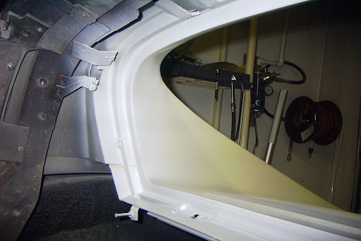

Then take your car apart
Eventually, after much scraping and sanding, you end up with something like this
That is so much work that I now understand why guys drive around with primer cars.
Then you guide coat, sand and repeat. This is by far the least fun.

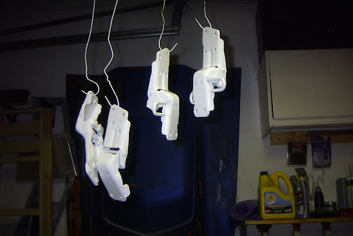

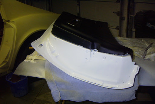

Painting small pieces

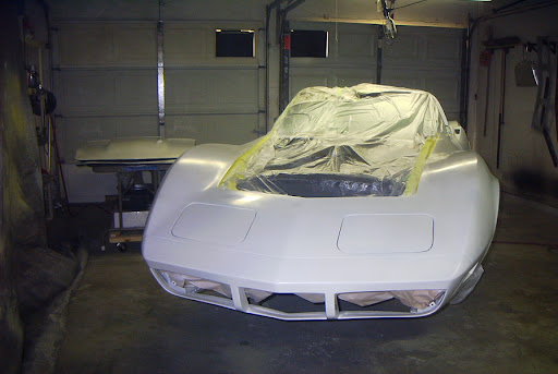

I laid down the base coat with no problem. But the clear is another story. I orange pealed it and had to sand it down one more time.
Took to a shop to spray paint only. $1000. Once it came back I reassembled
Voila! a 4 year color change...
