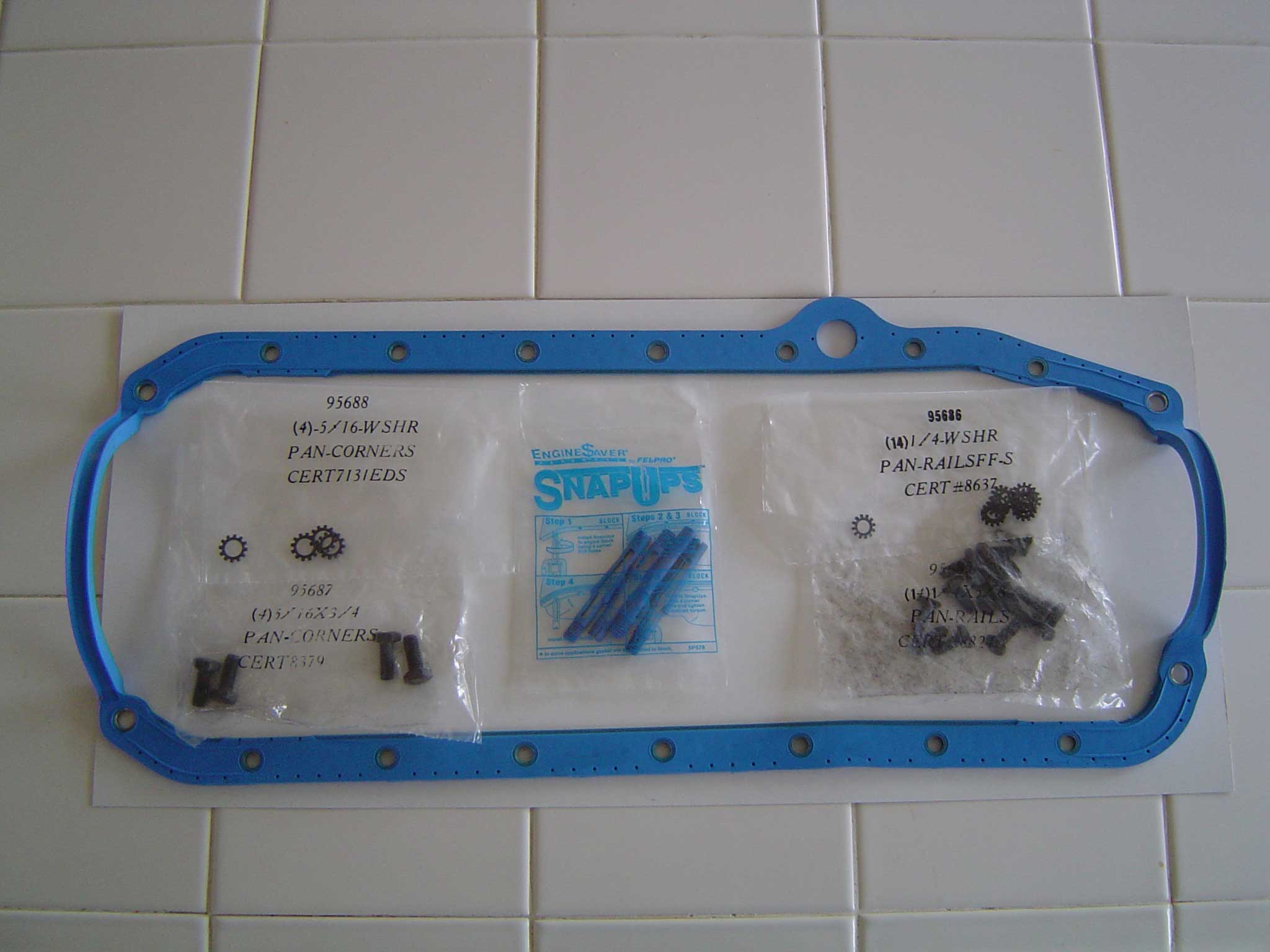

Correct me if I'm wrong here, but if the "seal between the timing cover and the oil pan" is leaking you don't have to remove the timing cover, just the oil pan. To make life really easy, a one-piece oil pan gasket will take care of that problem.
Those little blue SnapUps in the middle of the photo make installing the gasket and pan real easy.
Pete

when i replaced my cam several years ago,i put in a new rubber seal on the bottom of the timing cover, above the oil pan.i did not know that the one piece had the seal all in one .that may be a better way .thanks
