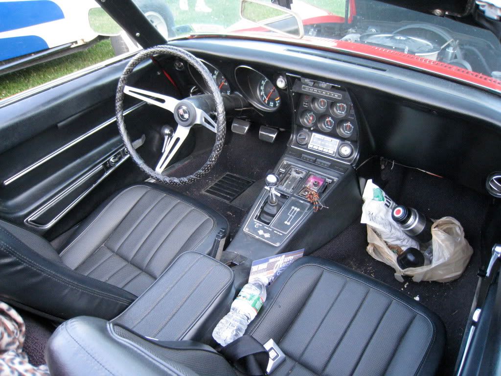

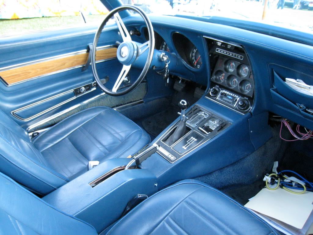

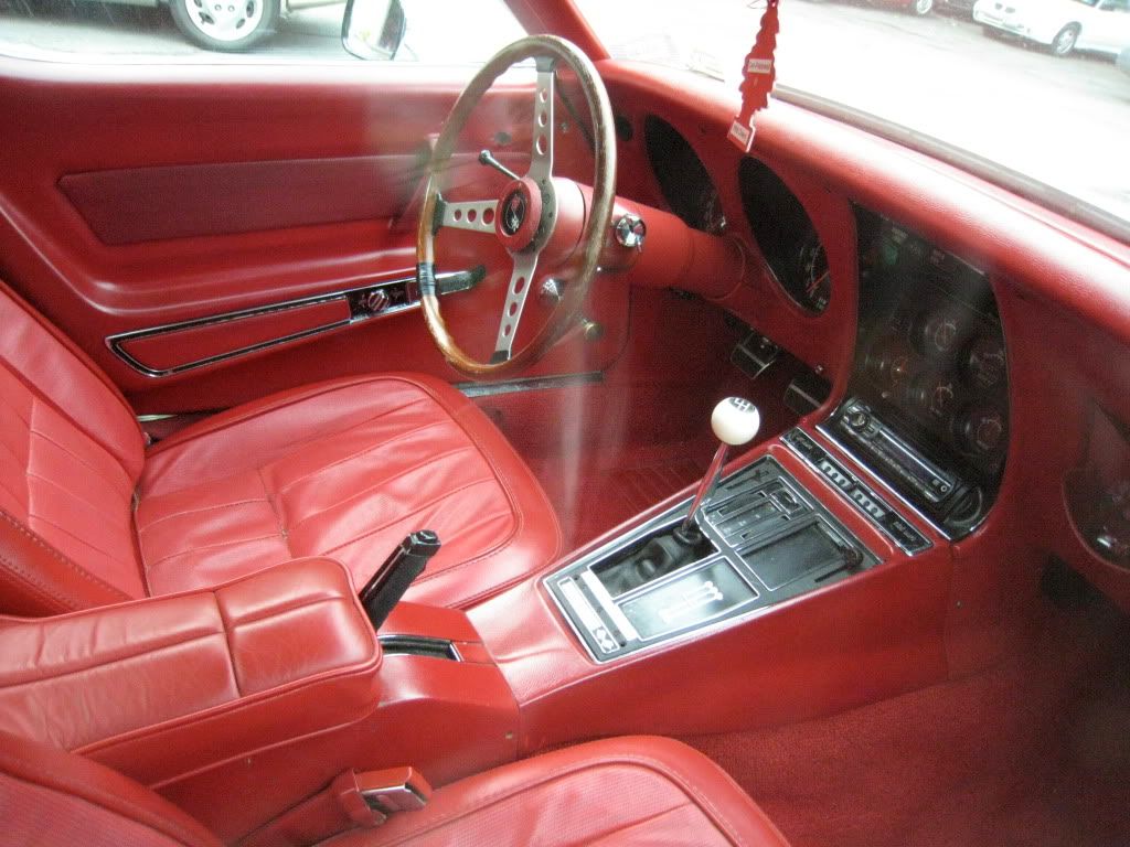

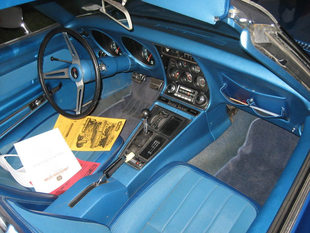

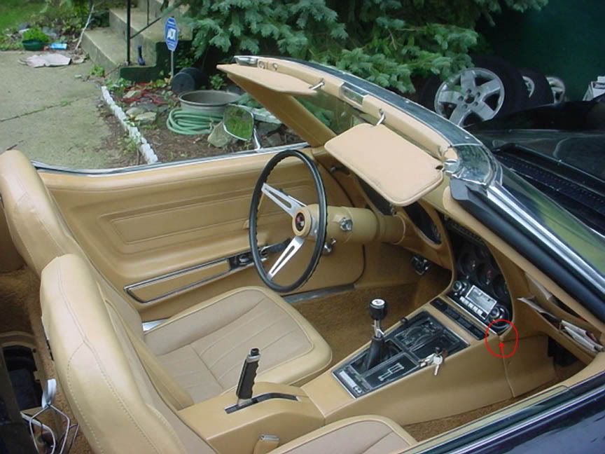

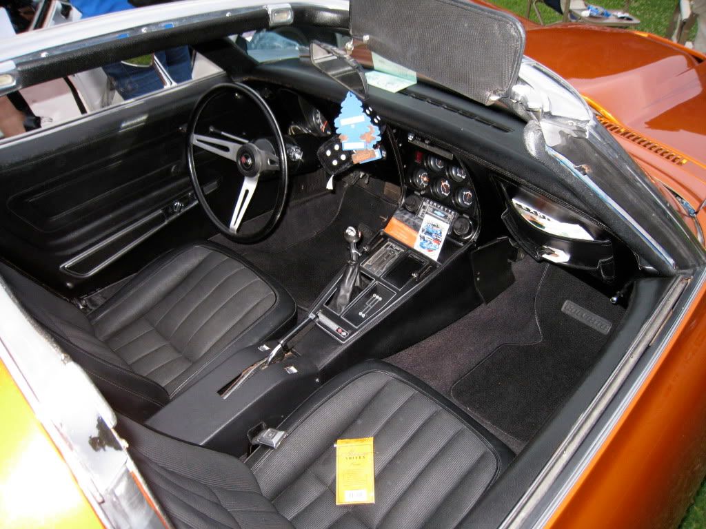

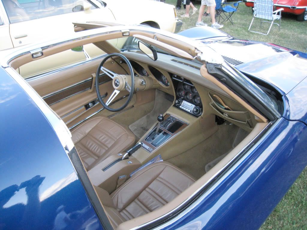

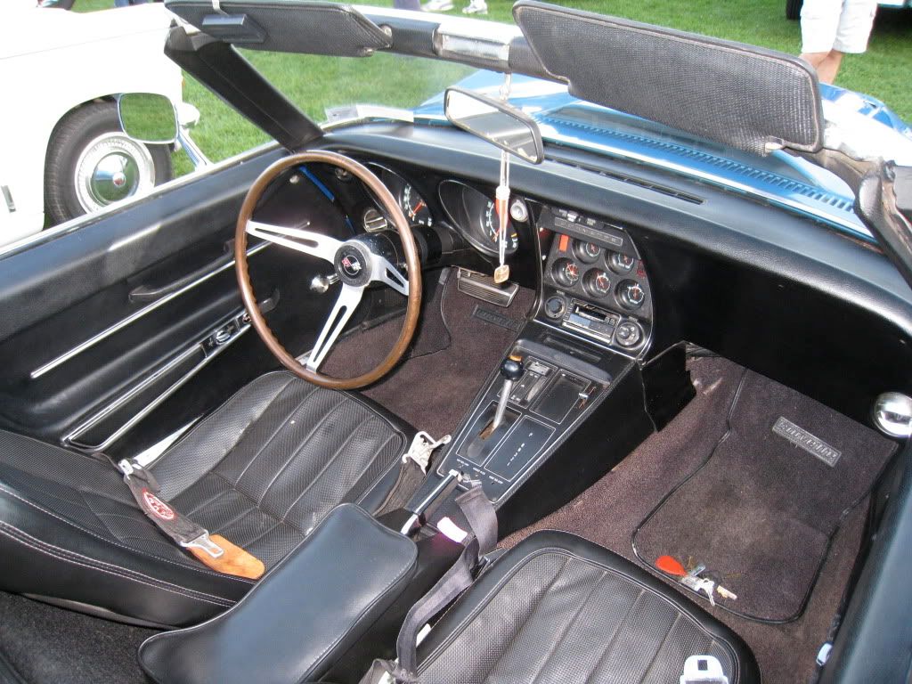

Here's a few pics showing the differences.
Besides no stitching vs. stitching, also where the pad & shifter console align (shape) by the radio are different.
Hope this helps.
Glenn
Here's two 68's
A couple 69's
Two 70's w/stitching.
Hers a 71
Here's a 72
A 73

Originally Posted by GD70
I believe 68, 69, 70 are unique. 71-76 are the same.
Bingo... you are correct....
